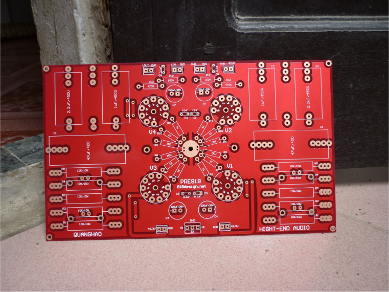

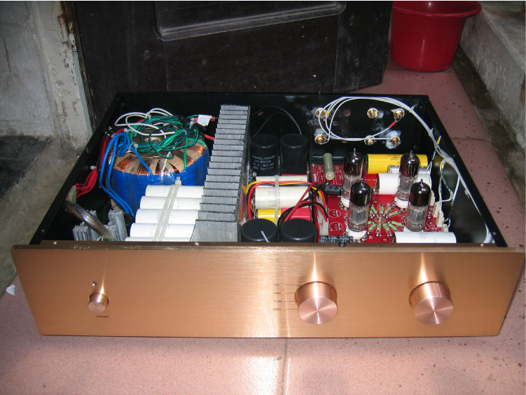

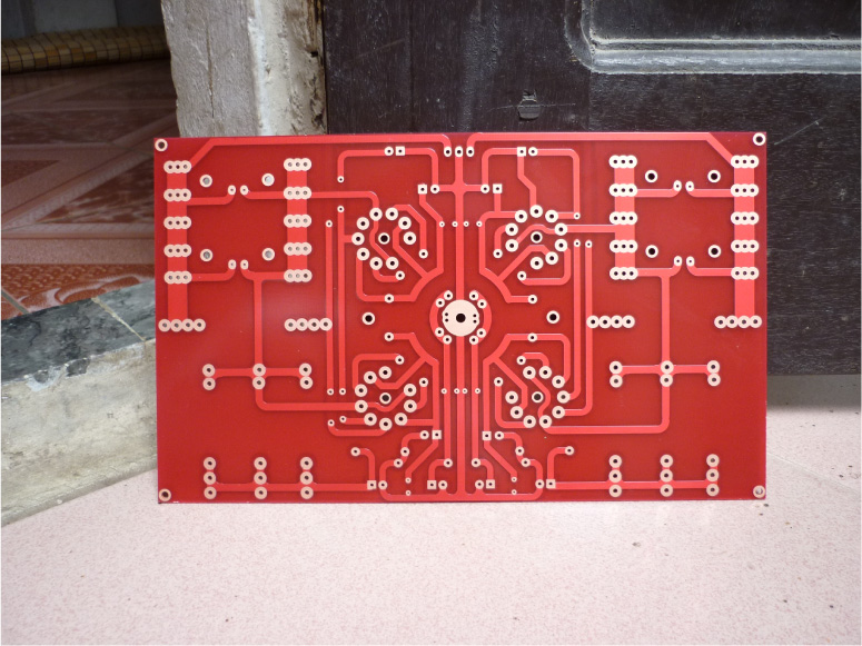

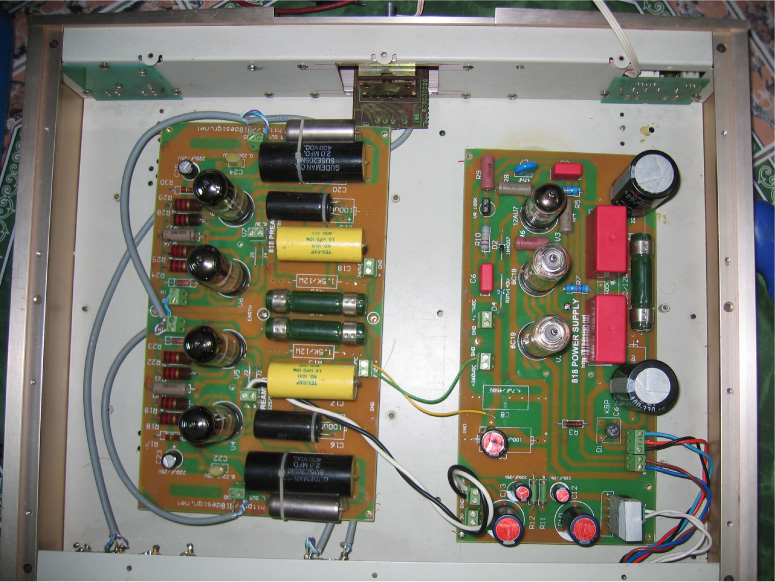

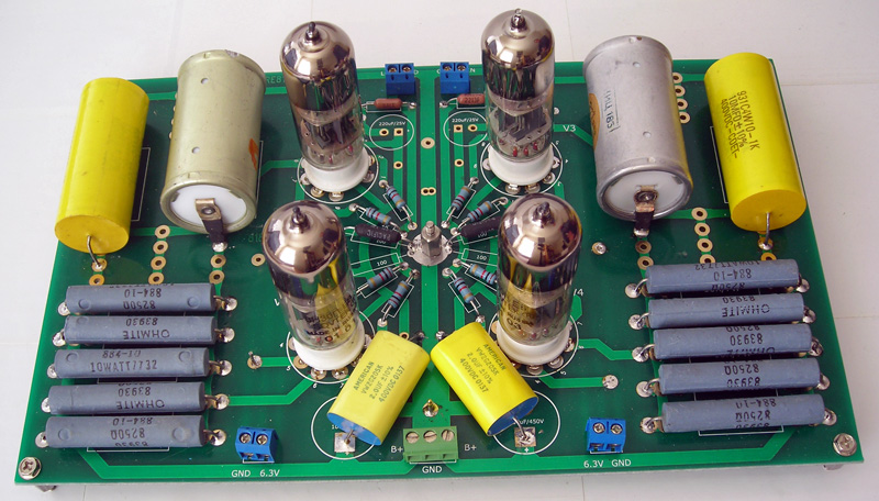

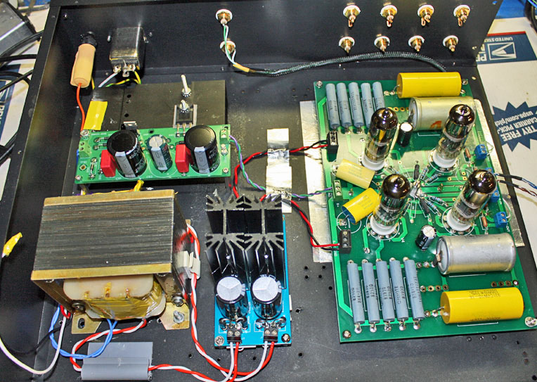

Please introduce to you a Pre Amplifier designed by me and has been popular in Vietnam 5 years! And is considered one of the best in pre post in Vietnam. There was a lot of my friends use it, and so far they still love it!
I use a very simple design, using three types of tube are different: 6h30Pi, 6h6pi, 6dj8.
Sounds very realistic detail, balance!

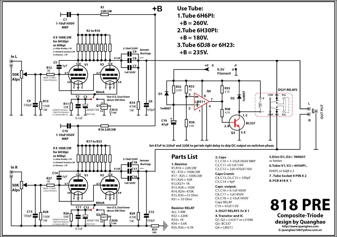

This is a circuit diagram of the 818 pre! Pleas see it!

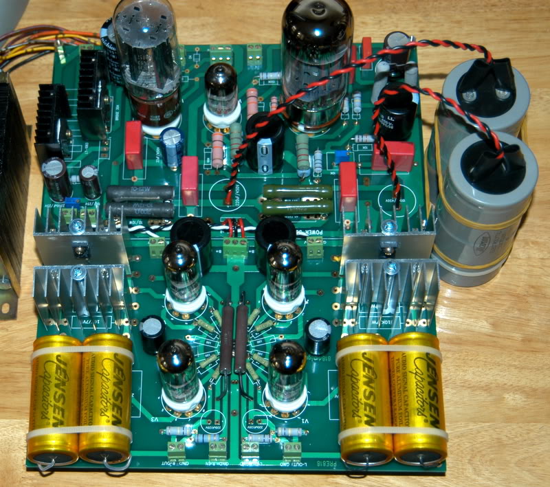

How many minutes do the tubes last running them at 40mA per section ?
Tube 6h30 or 6h6 I use 1/2 tube = 20mA!
So one Chanel have 2 tube, per tube 40mA, Total = 80mA!
Why is such a discrimination: you feed 6N6P with 80V more than 6N30P?
No!
At anode :
6h30pi = 90V, Ia 1/2 tube 20ma. the sound excellent
6H6pi =170 ,Ia 1/2 tube 15- 20ma, the sound it the best, i see
and 6Dj8 = 90V, Ia =5-7ma, i like
What about 6N1P?
I not test it, but
6n1p, or 6h1, you can you use for this circuit Anod at 90-100!
Some friend have been use it!
What's going on in the cathode circuit? Are you switching between bypassed resistor and a non-bypassed CCS?
Have you completed the wiring since those pictures were taken and actually tried the unit out?
Yes!
That is one option,
If you need Lower Z Out put, Use CCS
How do you manage lower output Z with a CCS in the cathode?
Oh! I'm sorry, I'm wrong, CCs as it not down Z out!
Thanks!

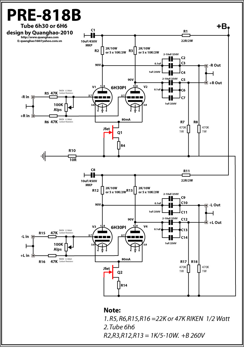

Were it me I would put a large capacitor across the CCS, were it really me I would use fixed bias (batteries?)..
Hi kevinkr!
Well thank you!

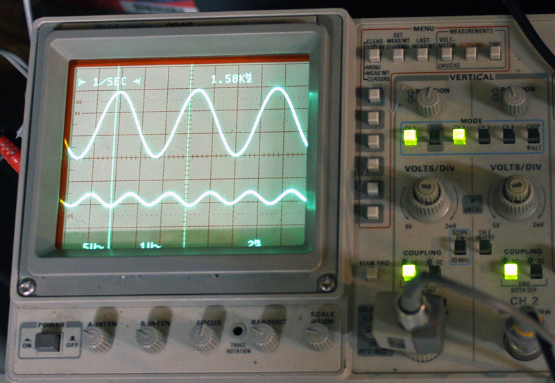

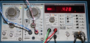

Well yes, the LM317 can not be the best, I used Jfet replace it! I recently tested the following schematic, and I enjoyed it! 6h30pi particular tube,
Thank you and hope you add comments to this pre!
With tube 6h30 i like:
Anode = 90V, 40mA/ Tube
6h6 I like:
Anode = 170V, 40ma/Tube
This is other circuit, Please see it!
