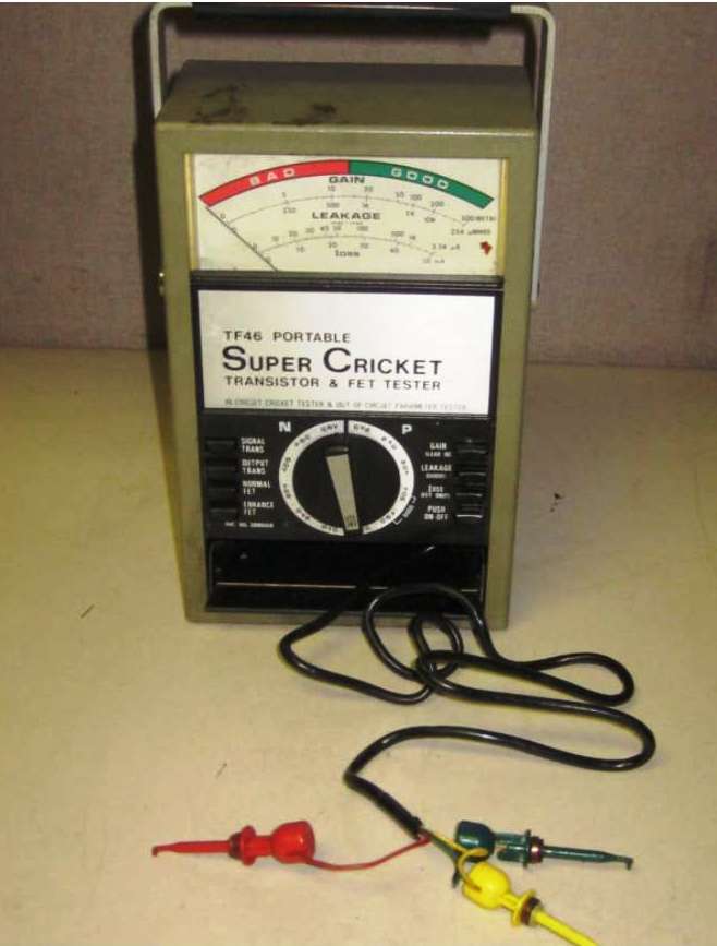

Thirdly, can someone make a recommendation on a moderately priced test instrument to evaluate and match transistors? What should a person look for?
I certainly appreciate any information and guidance.
Moderately priced is a relative term - but - the Sencore Super Cricket tester is highly regarded and sought after. If you get one of these you can be pretty sure that you can get your $$$ back upon resale.

Thanks for the tip, Conrad. I seem to remember an article in Audio Amateur, 1993/1994 I believe about building a curve tracer. The Tek 575 is often on eBay, but I'm running out of room. I have a very clever Peak Atlas DCA semiconductor analyser that gives pin ID, device type, Hfe, Ic, Vbe, Ib etc. All in a "palm sized" package.
