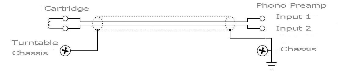

Question 1: That sounds as if the the 4 wires of the cartridge are not floating as they should be in this differential setup. The TT gnd should be separetely connected to the preamp chassis. This can all be achieved with xlr cables with 3 wires or with Cinch cables and a separare gnd wire, but under no condition may any of the 4 cart wires be connected to gnd.
Question 2: Is the preamp in MC mode also quiet when is not connected to a TT and without rca to xlr adapter ?
Hans

O.k. with the circuit diagram at hand I can be more specific.
From your previous answer telling that noise is gone when connecting pin3 to Gnd, I conclude 1) that only one channel is causing problems Y/N ? and 2) that when switching to MM the noise is also gone Y/N ?
If both true, this reduces the problem to the That1512 stage.
Do you measure 1K between pin3 and Gnd, if not the resistor is defective if yes, the That1512 is broken and should be replaced.
Hans
