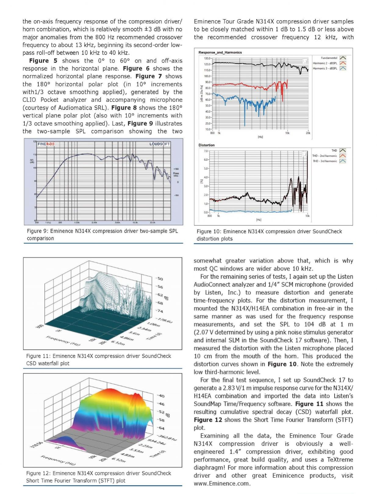

Diaphragm is "lightweight ply carbon".
Looking at the spec sheet you can see the patterns of carbon fiber.

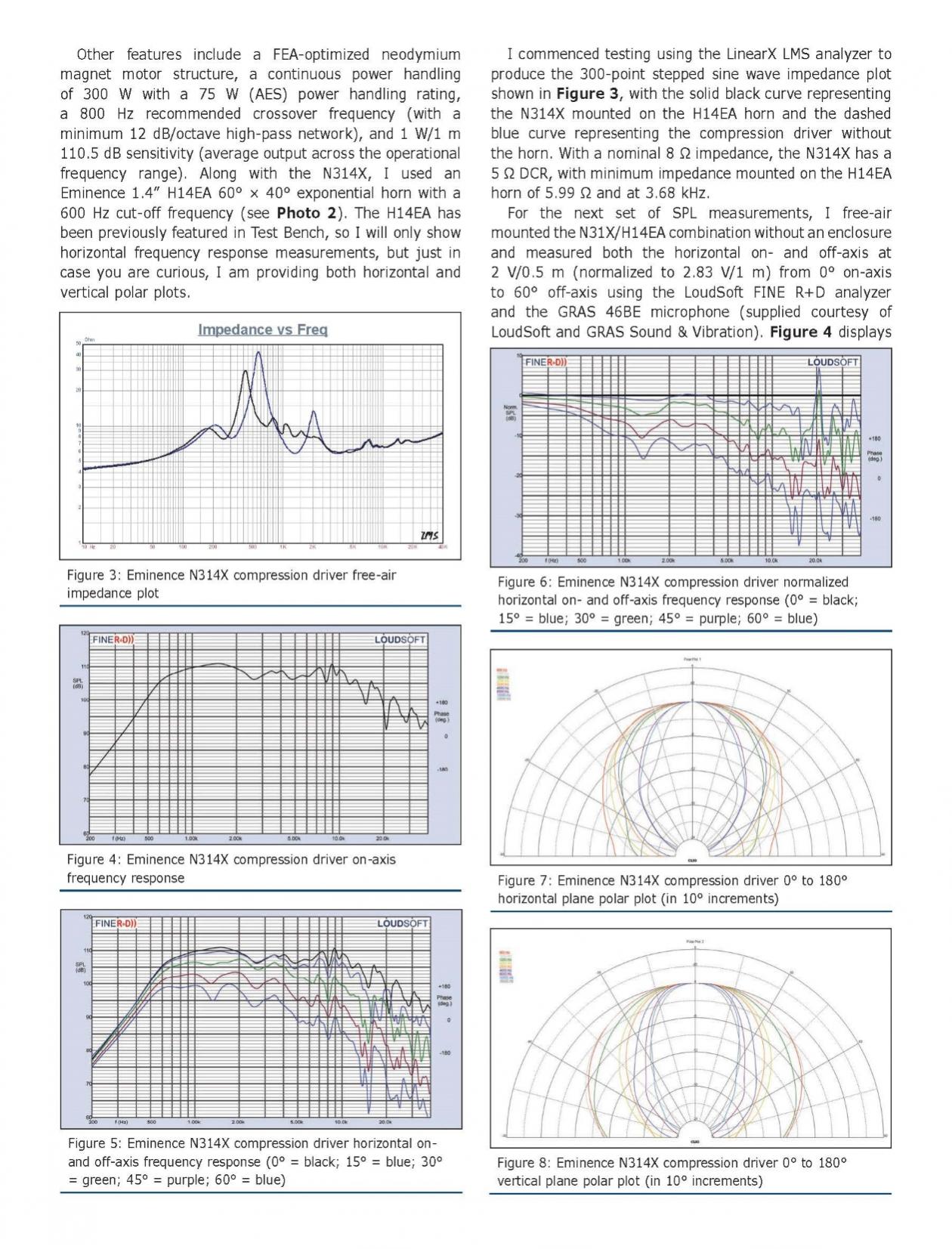

FS 494hz, recommended minimum xo 800hz 12db/oct.
Looking at this driver, I was almost expecting to see xmax and xlim. According to the datasheet, the sensitivity is better than 107db's from 600hz up!
Wow! Could probably match this to a 18" in a two-way, and actually get a good sounding setup.

I just checked the May issue of Voice Coil and it contains a test of that driver by Vance Dickason.
Regards
Charles
Regards
Charles

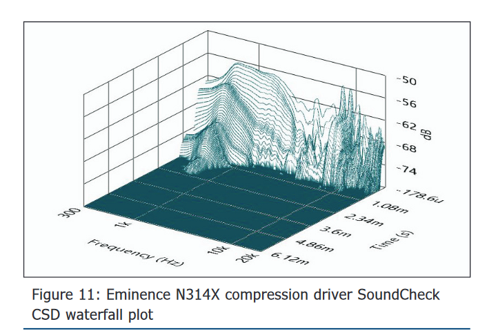

Performance seems very similar to the Oberton ND72HB (another carbon composite driver):
Test Bench: Oberton ND72CT/HB 1.4” Compression Driver | audioXpress
for harmonic distortion and CSD. Bit better frequency response and efficiency though.
Wowzers on that waterfall.....thats Ribbon territory isn't it? I wish I could see the specs for my driver =(

Which horn did eminence use for their test? Their only 1.4 WG is the H14EA. But it doesn’t say exactly.

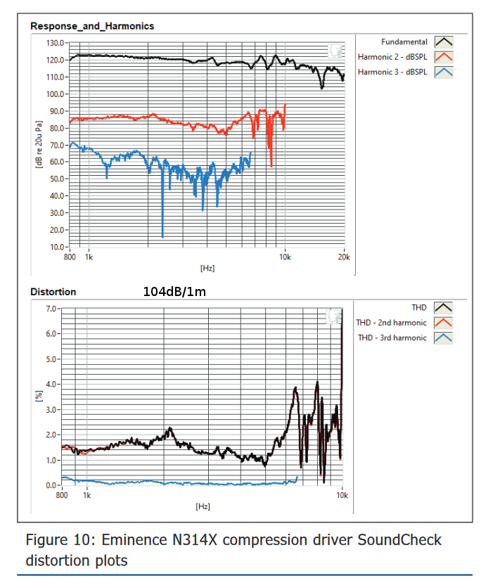

Thanks for sharing the tests! I knew it. Amazingly smooth and detailed. No audible distortion down to 490hz with high order crossover + eq at hi-fi listening levels. Dip at 16khz cant really be corrected, but I can't hear it anyway lol.
