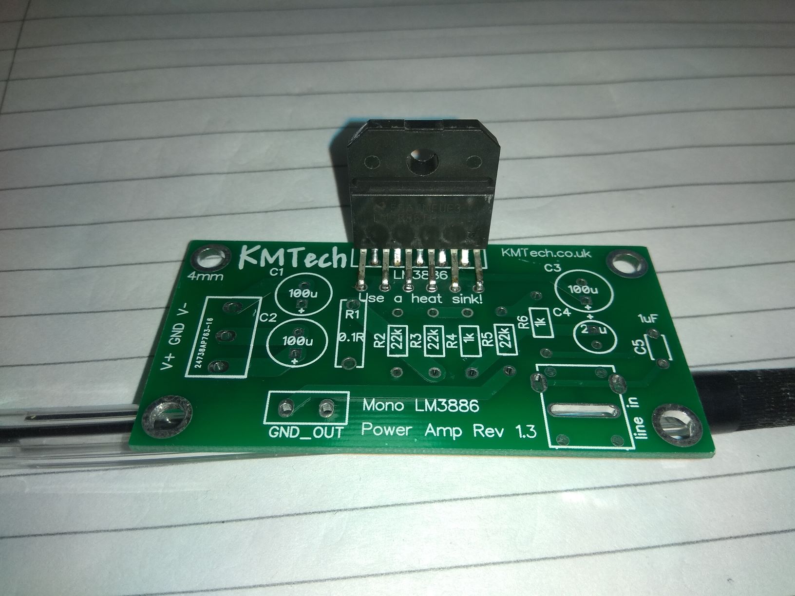

Just picked up a pair of (broken/for parts) amplifier boards with a total of 8 x LM3886.
Does anyone know of a simple way to test the chips?
I was thinking to put them in a simple board, but wondering if anyone knows of an easier way? Trying to avoid de-soldering them too much, as they are not the easiest things to remove.

You cannot avoid giving the LM3886 power. Some 2x24V or so. If you use no load, you may not need local power rail decoupling or Zobel-network. You definitely need a feedback resistor - use 10K. Connect "+" input to signal ground and connect a sine-wave to the "-" input through 1K. De-solder the LM3886 only if it seems to work.
Not a more complete test but a good indication if worth de-soldering.

Those LM3886 are virgin, literally, and presumed good .
2) test them by using them.
Either transfer them to your own boards or finish assembling the ones you show.
3) they already are in a simple board.
4) no need to remove them if you aim at a regular chipamp, if you plan using them in a ginormous 8 chipamp parallel bridged 400W monstrosity or similar, just don´t.

I would start with a simple test between power inputs and the output - a dead short or open reading should tell you something is wrong. Then you can do further testing after that to make sure they are good chips.

Make a test pcb, (oversize the plated-through holes for the LM3886 footprint a little if poss).
To test a chip place deep into the holes and apply sideways pressure to force all the pins to contact their plated-through holes solidly, perhaps holding in place with a stout rubber band.
Then you can test without soldering. The holes in the pcb will eventually chew up a little of course. Oversizing them allows used chips with solder still on the pins to easily fit without having to clean them up too much.

Just measured the transformer, it's giving almost exactly 30V AC. Which makes just over 42V DC after rectification, which I think is going to be too high for LM3886.
