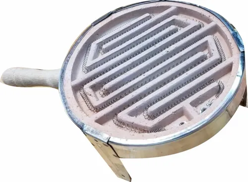

I would like to test an amplifier (see my avatar) with a passive resistive load with voltage swings in the range of 40V peak. Since, using a speaker at home generates sounds which can damage hearing due to having walls reflecting sound wave at a short distance, I plan to use a resistive load using a network of filament lamps.
Is this possible without causing damage?
Filament lamps are terrible as a load, their resistance varies 15:1 from cold to hot.

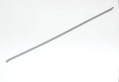

If expensive/inconvenient to buy, make your own out of cheap kitchen heater nichrome wire.
used in this kind of heaters:
First you stretch it 1.5X or 2X to separate wire turns (otherwise it self shorts) , then measure and cut appropriate resistance sections.
Mount it to strips cut out of floor/bathroom tiles, drill holes near the ends and insert 1/8"-3 or 3.5mm screws, use nuts and washers to hold it in place.
Warning, first wire and then tile will get hot, put it on a brick/cement/tiled floor, never on wood, furniture or plastic.
Make them somewhat lower resistance than needed, say 7 ohm for a nominal 8 ohm one, resistance goes up with temperature.

3) I am in Argentina, guess very similar situation as Malta , last week I bought at my friendly hardware shop 3 blocks away a ceramic heater resistance as I showed in my post for one U$D
Being 1000W 220VAC total resistance is 48 ohm, I can cut it into 3 x 16 ohm sections (very useful) which allow me to dissipate 330W each if I let them run red hot (no big deal, they were designed for that) and of course can be used at less power any day of the week.
Manhattan project turned out to be drilling 6 * 1/8" holes in an old tile, passing 6 1/8" by 1" screws through them and attaching the 3 pieces of resistive wire.
Total cost 2 to 3 U$D, total time way less than 1 hour, delivery time was 10 minutes (walking 3 or 4 blocks), I would do that any day of the week, instead of ordering and waiting.
