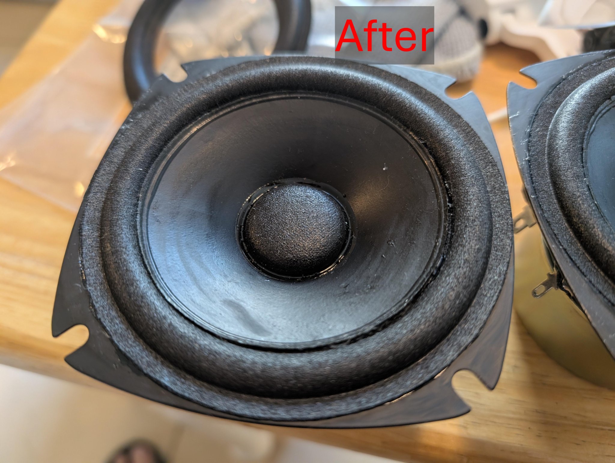

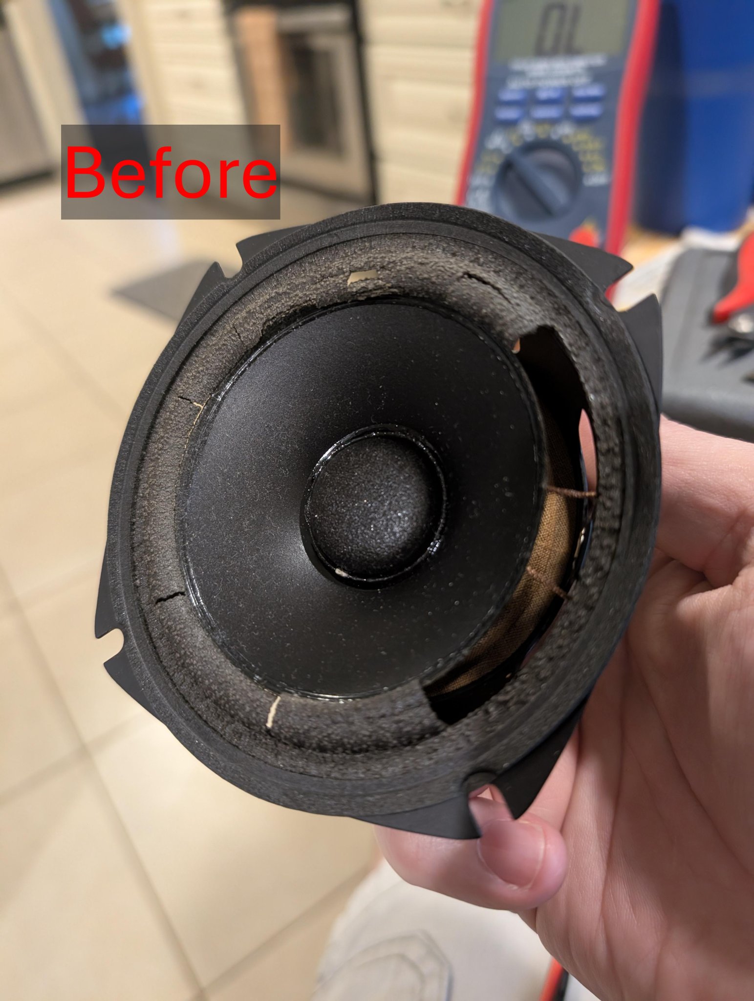

Unfortunately I found out the speaker surround on the L and R had completely deteriorated. After much consternation, I looked for replacement drivers and I didn't have much luck, at least not at an affordable price. Then I found some some replacement surround foam on Amazon for $7, glued them in with E6000 glue, and it's all back up and working again. Photos below.
