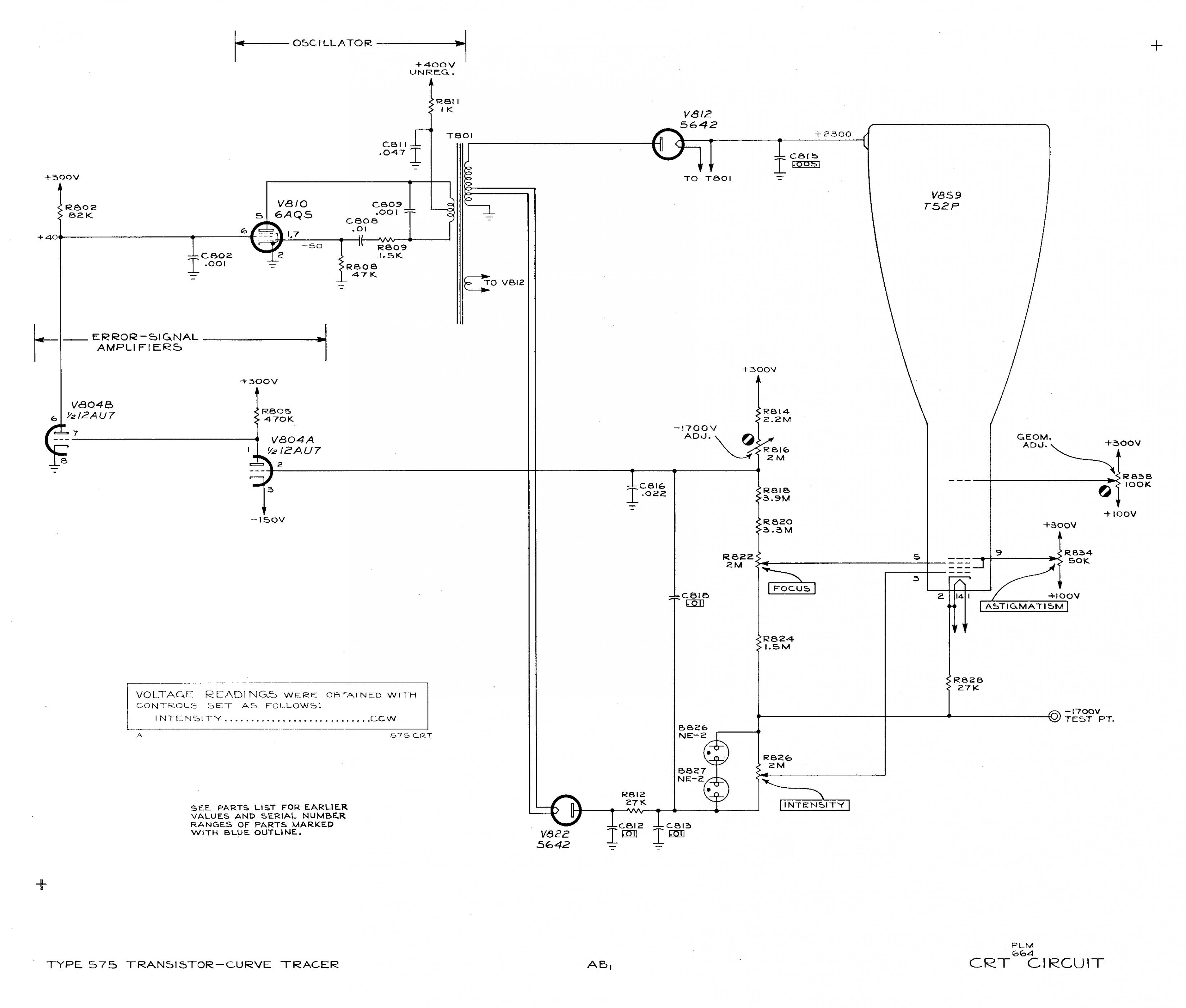

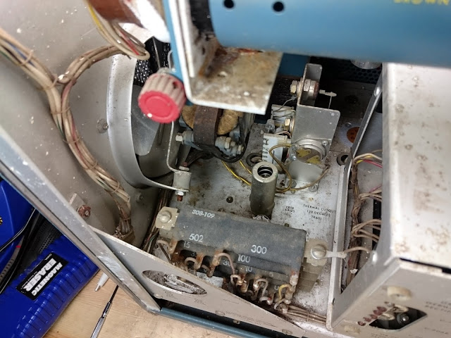

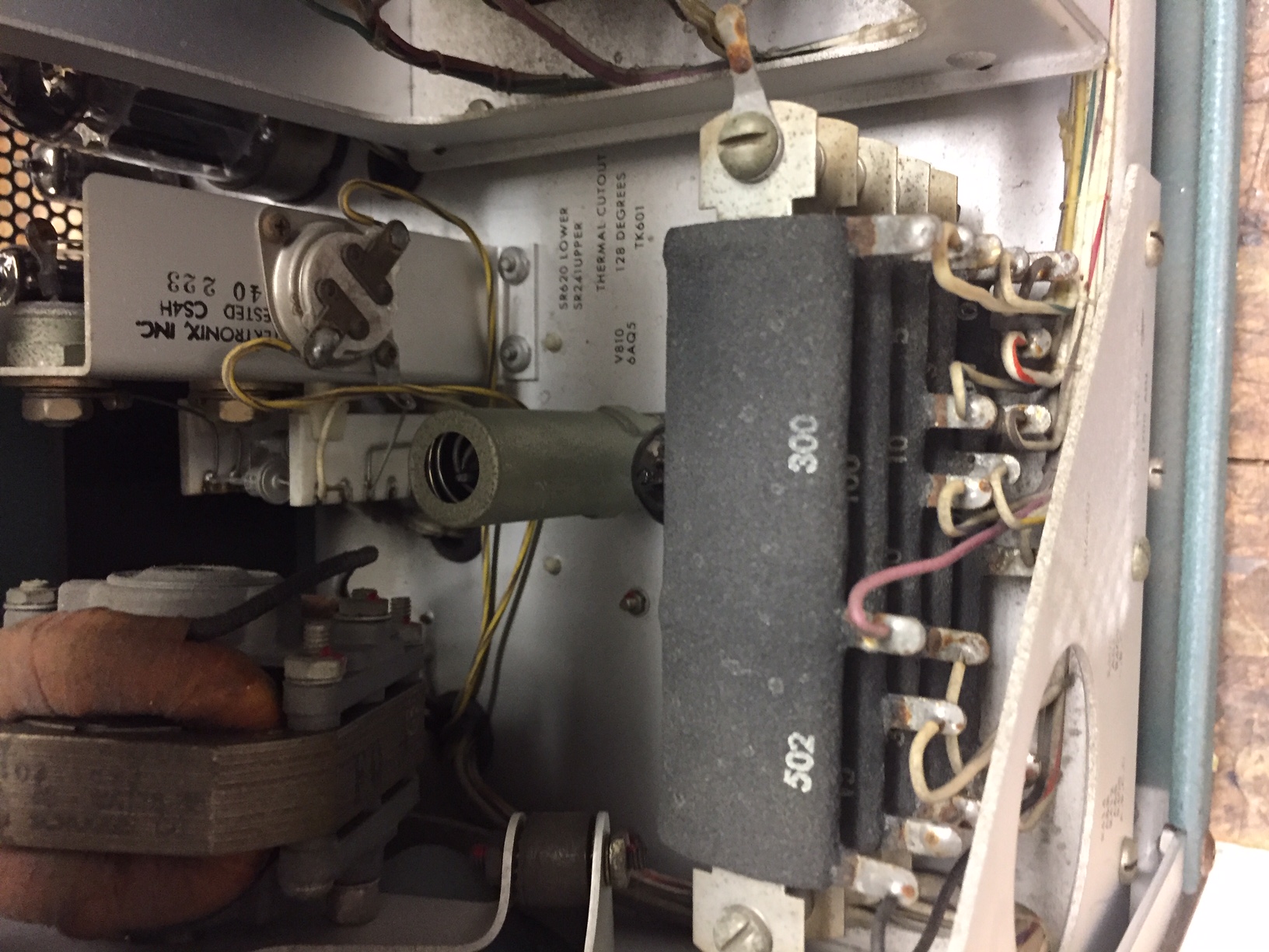

My Tektronix 575 was working last year when I put it aside to work on other projects. Today, I removed all the tubes and to test on my Hickok 580A, mainly to see how the tube tester was working and to clean up the dust inside the 575 curve tracer.

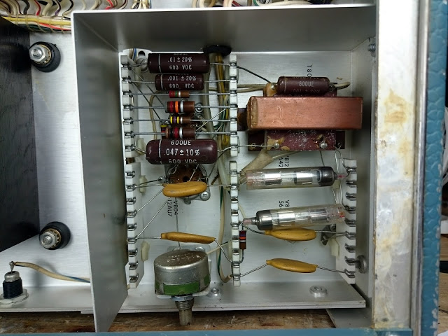

Lesson learned was not to forget to install the 12AU7 tube (V804) in the CRT circuit. Its got -150 volts on the cathode and only 500 volts on the anode. If you forget to reinstall, you might begin to smell all that voltage warming up other components as you stand around wondering why the CRT doesn't work.
In my defense, V804 is in there hiding, and is located away from all but one other tube. I realized I forgot to reinstall it when I started wondering where I got another RCA 12AU7 clear top tube.

Two of these photos are from retro voltage.com and the schematic is from BAMA website, but mine looks exactly like the photos, even the tubes.

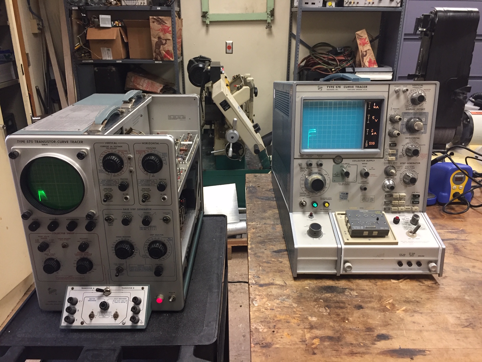

After all these weeks, she's all dressed up, calibrated and ready to go. Here's a photo showing the same curves as the Tek 576 at work. Sorry, my iPhone photo skills (or lack of) don't allow me to show the traces properly because of the way the traces pulse on the screen...but they are alike on both machines using 2N4123 transistors.
