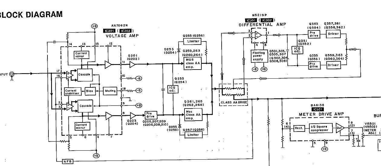

I thought New class A and class AA were different. Or does Mos Class AA differ from Class AA? Mos Class AA being a class A amp driving the load (bridge) and any output from the bridge means helping current from the class B (AB) amplifier.
Excerpt from block diagram (Technics SE-A2000)
Class AA was the Sandman bridge. It is an integrated module. MOS Class AA is a discrete version using MOSFET output devices. Got an amp of each here and have poked about inside.
New Class A is different and can be either sliding bias or the modulated scheme sreten mentioned.
