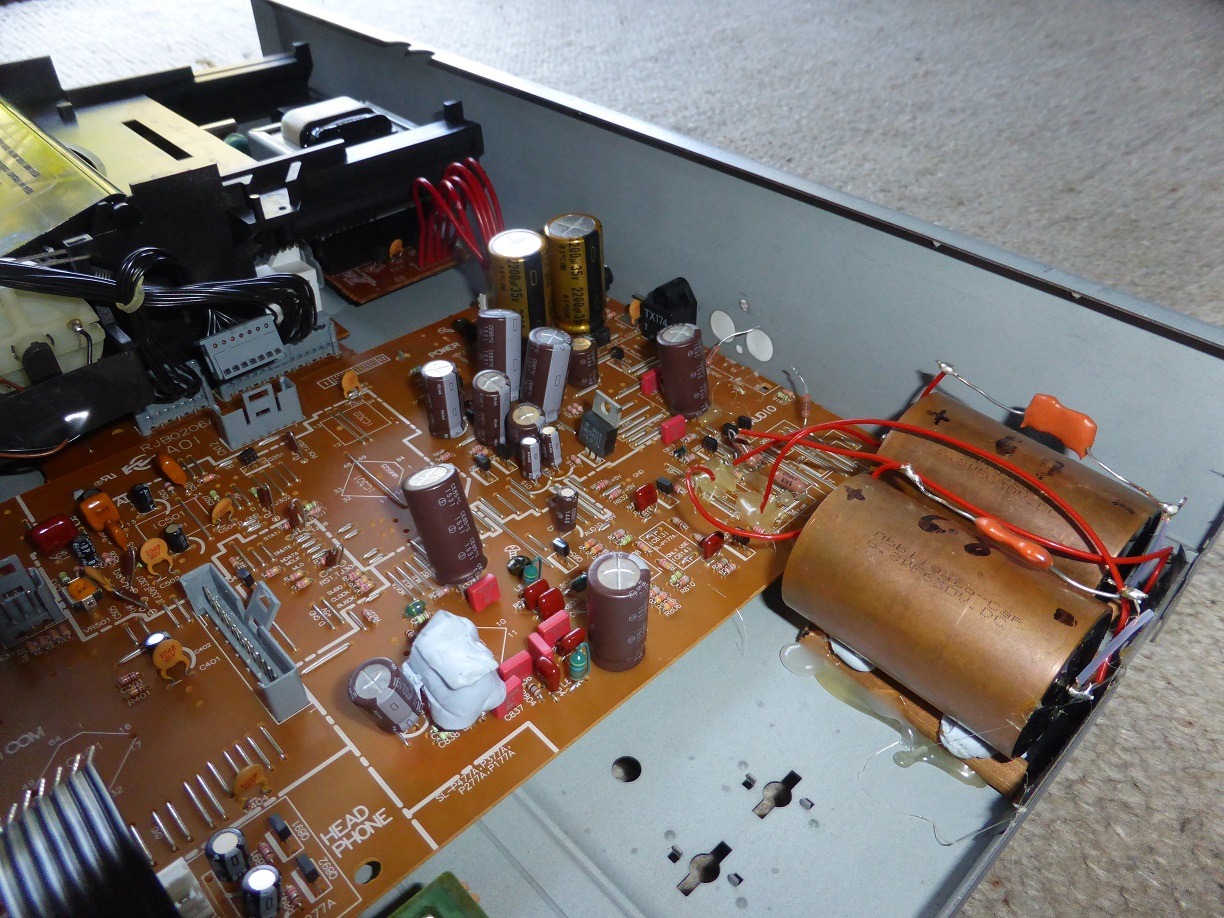

My Technics SL-P477a, already happy with it, but since upgrading the rca jacks, i was curious if i could bypass the resistors to ground. I left the compartor opamp in LM833, but changed the other to LME49860. I had old film capacitors sitting around from speakers i once had, so they had some hours on them and used them. I kept the same capacitance on the caps. I was shocked to hear that Elna is no longer manufacturing the SilmicII

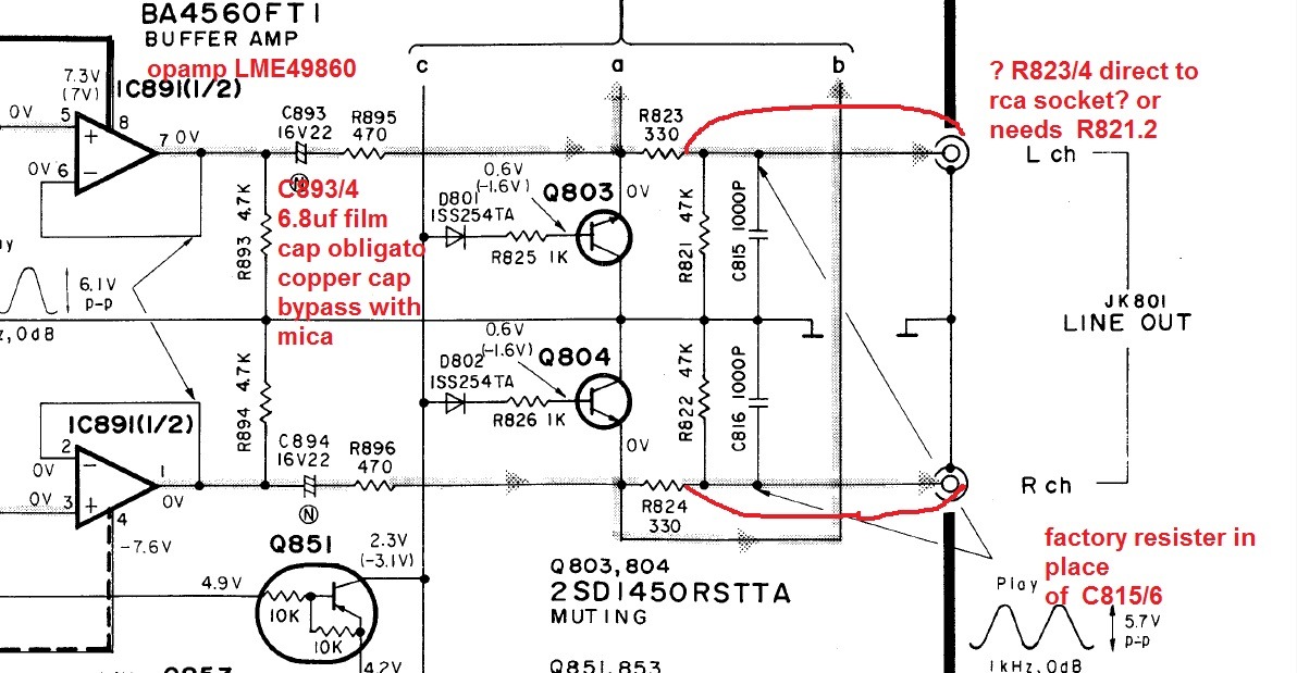

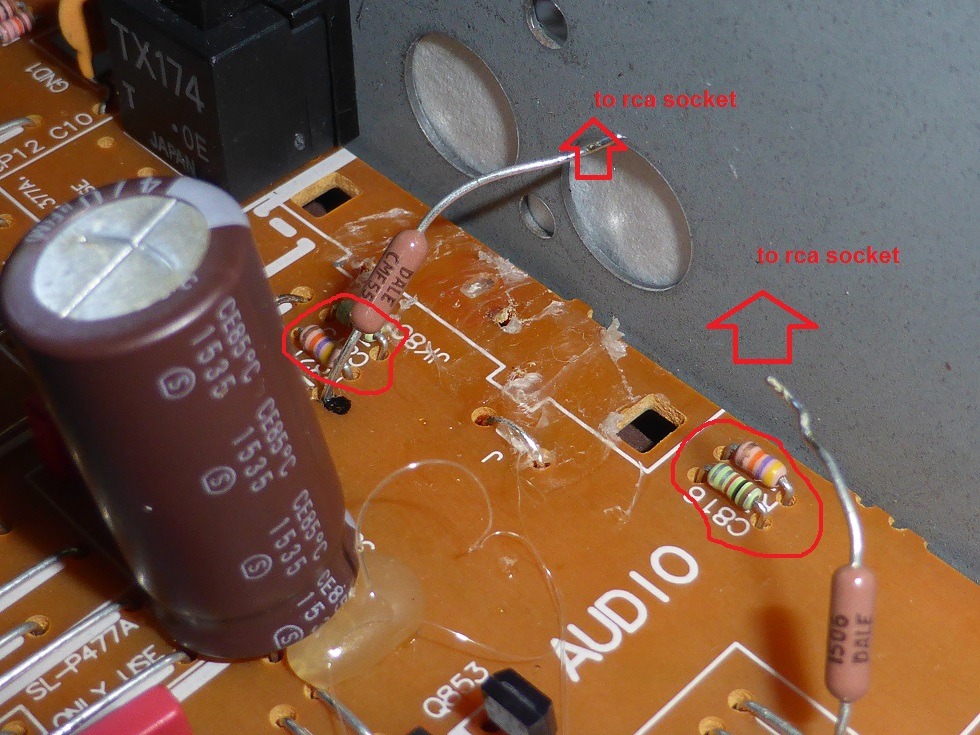

bypass or not possible the resistors to ground? if not i can leave it, sounds great as it is. The mechanism cdm4/19 is easy to come by, as i have spares.
@rayma Thank you Ray. 47K to ground and in place of the capacitors, they have used resistors as well, is the low past filter. I will take your advice and keep it as is. Original caps were 22uf the 6.8uf film hasnt affected the player negatively.

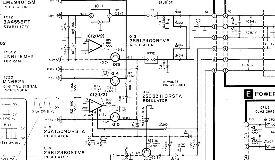

@rayma thanks, I was thinking a little over the original specs just to be sure, as i could only find ROHM specs, but then maybe Technics used them, its a 1990 cd player. Any benefits with the Schottky diodes? - just those 4 where the AC comes in for the PSU
