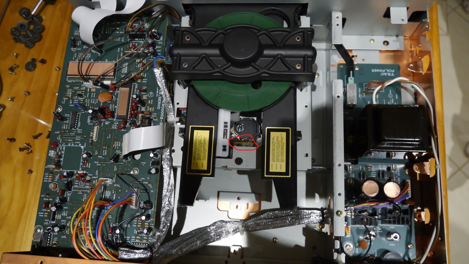

I have finally given up on getting my trusty T1 repaired. I had one of the gears changed a few years ago and now the tray won't slide out. The gears look Ok from the top but as there isn't even any movement it may be something else. The laser head moves forward and back and nothing else happens.
Apart from the one repair it is all original. I plan on keeping the chassis for an amp or something.
I would prefer not to have to open it up for the gears and just send the entire CD unit to someone who needs it. Same for the power supply and control board.

Hi Merlin, Sorry for the delay in replying.
I can't find the number on it but I'm quite sure its the same one after going through the threads in digital source. The part you need looks the same in mine. The motor to open the tray spins but the gears don't move. It looks like the loading belt is broken as the gears look OK.

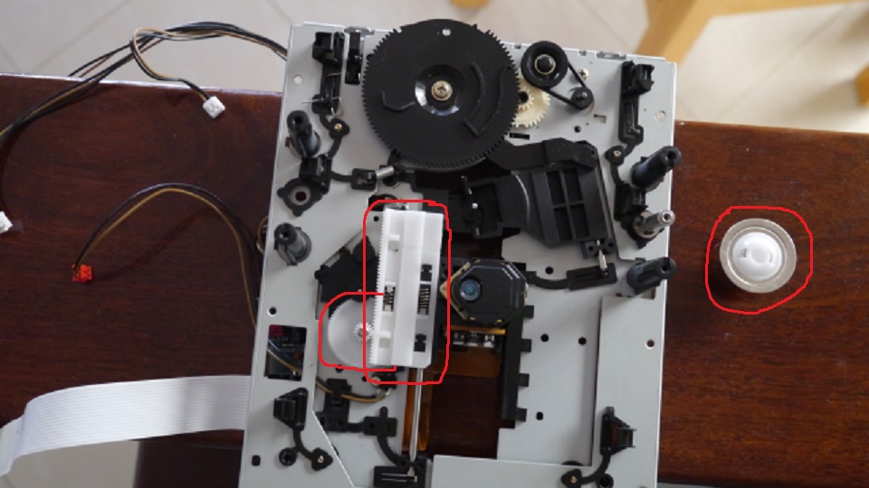

Thanks Kevan, if you live near me I will ask you send me the entire T1 for parts but I live in Europe so shipping expenses are high so I need to adjust what to ask you to send me: attached image of your gear marked in red do you read the laser pick-up model.

Sorry the laser pick-up is not the same🙁, could you send me only the white plastic piece shipping fees to Spain - Europe?

Does the white Cd holder that you need come out easily?
It looked like it would slide out of the holder but I didn't try.
let me know what you think.

Hi Kevan,
Is possible that you broke the white CD holder, don't try to come out with brutus force or try with a lot of care.

If you can't came out the white CD holder piece, could you try to come out all the piece not just the holder and let me know if it's more than 500gm?

Filipe,
Getting the tray out was a bit tricky but it's done.
looks like the Teac service guy has sprayed a solvent to clean it and has melted the surface off the tray making it stick. The belt is fine but some of the teeth are broken from the 2 step gear.
The other gears look fine. i thought i would be inundated with requests so let me know whats you need before it goes in the bin.
