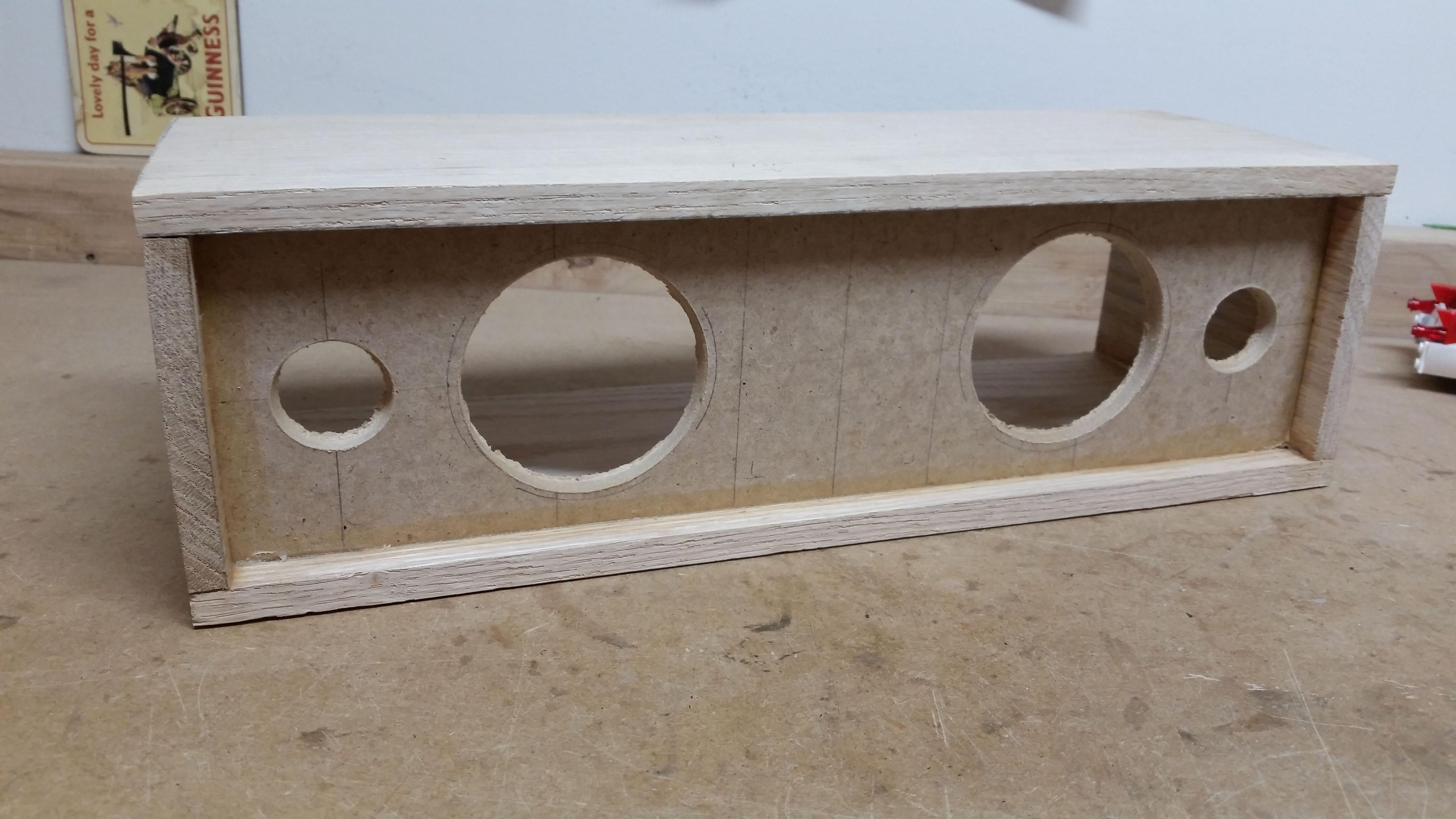

Hi all. I am looking to install an external antenna on my TDA 7492. Normally, I would just cut the trace and solder a 31.25mm copper wire but this amp will be behind 1/2" oak and some other interference so I need an extended antenna mounted outside my enclosure.

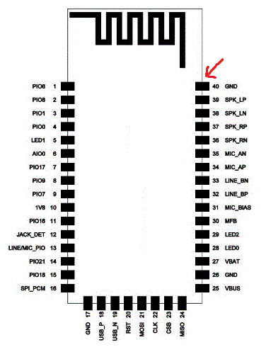

I know will need a ground for the shield of my coax. Will the indicated ground from the datasheet serve as a suitable ground?

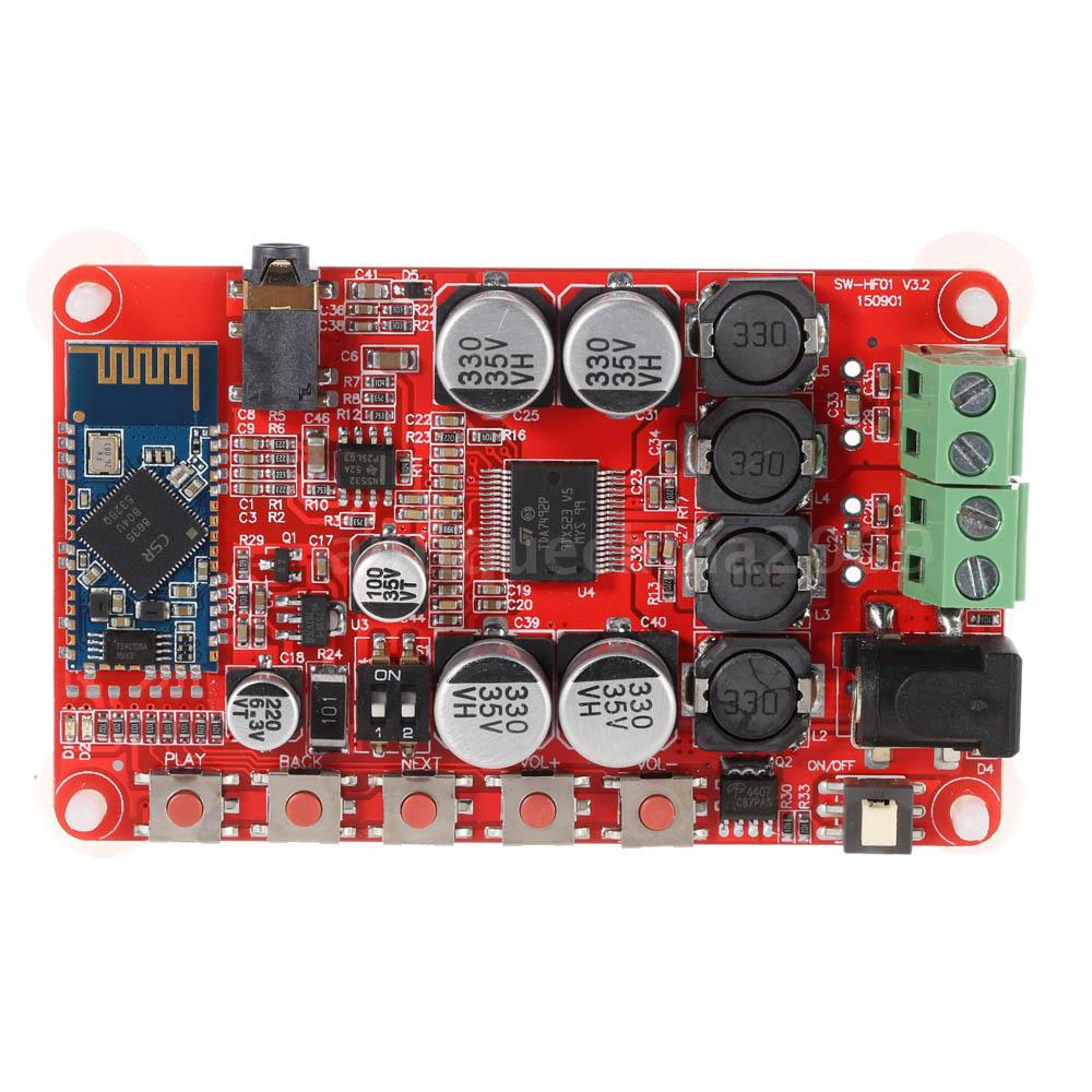

@xrk971: Yes, I plan on soldering a U.FL connector in there so I have plenty of antenna options. Ebay is flooded with these, just search "TDA7492P Bluetooth". This is the particular model I have. The temporary switches on the red version have this weird 3rd leg and I cannot figure out how to use external switches (I will be routing my buttons to the top of the box for music controls).

@radiosmuck: Thanks, but having it mounted inside and having a simple looking, clean build are important to me, so I don't want to mount is outside. I've already built the basic frame. Also, the thick oak is really dense and I am losing range in stock configuration.

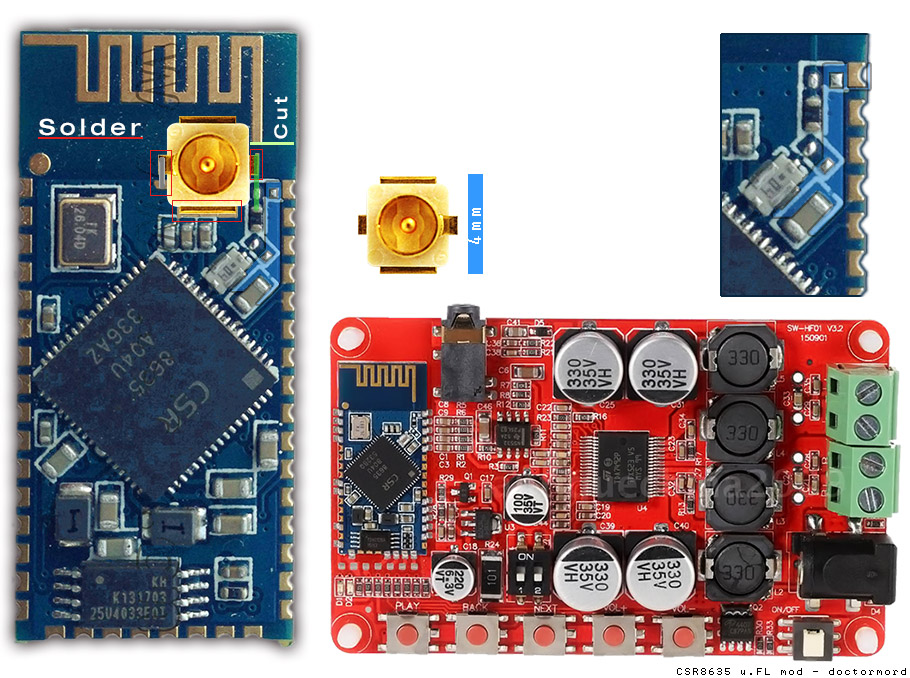

Did had a look again into this, the CSR8635 is different at this area and this pin is truely GND.
Fitting an u.FL there might work like on the image attached.
So cutting the board antenne, scratch off the traces silkscreen and some area of the groundplane, solder the u-FL tip and one side of the screen and optional attach a piece of wire to the "spare" pin on the left. Due to the trace is now going 90° to the u.fl, tuning might be needed. the already fittet resistor plus the 2 free 0402 footprints forms a pi-arrangement.

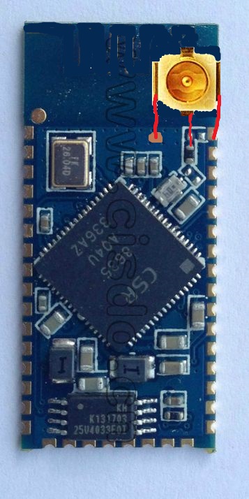

Thanks doctormord. This is really helpful. I like pictures! Might I benefit from turning the u-fl 90 degrees clockwise and soldering a 2-3mm jumper to the GND pin on the right and the scratched off ground on the board? Please excuse my grade level Paint skills.
Yeah, why not if its holding in place.
(Mechanical strength is reduced when mounted like so)
I wouldn't care so much about the 90° in this small scale either, esspecially if you wont tune your new antenna anyway.
You could even just solder a piggytail to SMA there. (covered by epoxy)

If I replaced the printed antenna with a 3cm copper wire pointing upwards, how much would it improve my range - if it would at all? It is - pretty much like yours - going to be encased in 12mm plywood in a halfinator.

Well after I messed up my previous TPA7492 trying to solder the uFL receptacle, I ended up just not even bothering with the replacement one. I went with a TA2024 amp and this BT receiver. Its a better setup for me in every way, even though it cost me an extra $20. It has the uFL solder pads ready to go so I was able to add the receptacle on there no problem and I just cut the trace to the PCB antenna and added some double sided tape and tin foil to shield the exposed area a little. Additionally, it supports APT-X, has a mic, aux input, and a connection for external control buttons that actually works. Ill try and add a pic or 2
