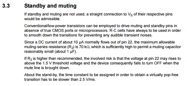

I soldered this amplifier on my test board by the schematic which is attached in their datasheet.
The problem is, amplifier plays audio even when mute is not connected. For the stand by input i used 5V (7805).
I measured mute pin and it was 3.01V. How comes that there is 3V on mute pin which is not even connected? There is no solder bridges or anything, i even lifted that pin up from the board. Tried to ground mute pin with 1.0uf y5v capacitor - the same situation.

Mute and Standby are in different sections.
Standby is in the medium current as in driver section.
Mute is in the small current as in input section.
The mute pins are an input.
Give the mute V+ pin a 10k or 20k resistor to power.
Give the mute ground either ground or the +input.

Question is still unanswered for me.
Stand-by and mute - both are inputs. Why there is 3volts on mute when its not connected to anything? Might be fake TDA?
No necessarily the chip is bad, perhaps it has its own internal bias at 3V, and you only need to change it to the desired voltage, 0V or 5V in this case.
