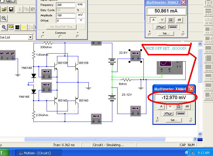

I would like to share with a few amplifiers ideas (some of the are playing already!).
The ideas were born after reading 2004 blogs by John Broskie in TCJ.
Very similar ideas could be found on the sites of Evolve Power Amplifiers.
The pdf file consists of 3 projects with the results of simulations.
First two have 75mV 1 kHz sine wave at the input. The transistors are 2n2955/3055. Those are only ideas.
Third has at the input 1V 1kHz sine wave. The transistors are IRF540/9540. This amp I have built in two versions:
• First – power supply voltage only +-13V, signal directly from a source, potentiometer, connected to the 10kOhm resistors (in the middle). NFB resistors 12kOhm. In power supply ordinary parts. Sound: GREAT from the start. Detailed and not grainy. quick, deep, low bass, wide stage, wooden saxophones, vocals not sharp. It works stable from 11-2004. Rest current only 200 mA per hexfet.
• Second: - As a preamplifier connected via a paper in oil capacitor, I have used E88CC supplied from only +43VDC power supply (!). 180 Ohm at the cathode, 4.7 kOhm at the anode. The capacitor at the solid state side was terminated to a ground via the 380 kOhm resistor. Power supply +-23V, super fast diodes, battery of paralleled good, fast capacitors. Rest current 350 mA per hexfet.
Now some notes about the sound: VERY good bass, detailed mids and highs, deep stage, but a little too bright sound. Saxophones are a little metallic, not like in tube amps when you could hear the wood.

Hi Carlos,
low power transistors = low offset,
in practice I had to regulate the offset paralleling one of the nfb resistors with another resistor (rather high value ~1MOhm).

darkfenriz said:
CzeϾ
When you re-write schematics but change ground with output symbols (so that supply is no longer floating and output is emitter follower) all starts to look quite ordinary. Only the input signal is kind of 'bootstraped'.
what feedback circuit do you use?

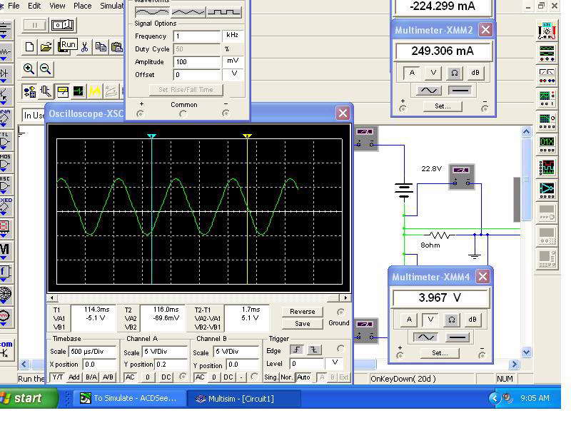

Joined 2005
The feedback resistors are R1 and R2 in the 2nd schematic: when there is a positive input signal, Q2's base goes up, and the current going through the Q2C goes up. Current is being sucked from the ground through R3 (load), which gets fed to R1 through V2 to reduce the voltage on Q2B -> negative feedback.
I haven't analyzed this in great detail but you need to isolated power supplies (not a big deal), and they need to be super quiet as well.
It is, however, very fast, as the signal being feedback is current, and the output signal is current, regardless of what R3 is. In essence, this is a voltage->current amplifier. Very cleaver design.
Disabled Account
Joined 2005
On a 2nd thought, there is really no reason to have different feedback factors for the upper and lower devices and the power supplies are just pass-through for the feedback. So one way to feedback may be to eliminate R1 and R2 and replace it with one resistor going from N1 to the input resistor.
As a current amplifier, this amp has the unique chacteristics of a) lower output on lower / tougher load; b) lower feedback on lower / tougher load.

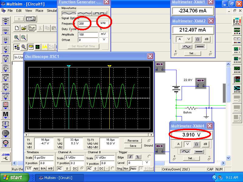

I can see, that these simply project has focused an attention of some of you.
As I have mentioned before, the first was the best.
Attached you will find whole circuit which works from 2004 now on.
It is very easy to build even for every greenhorn.
The results that I have got with the ordinary quality parts have astonished me.
I believe that this is a good start to make the improvements.
tlf9999 proposed to use CCSes, but I can feel that this might spoilt the simplicity of this project, however, it is very hard to build simply and good amplifier. Everybody here knows this fundamental true. So why not to try?
Please be sure that this circuit is very flexible to the modifications, and bellow I proposed a few of them:
• Use of stabilised power supply, even with a global nfb, to minimise its impedantion, what ensures reliable conditions of working hexfets (but the whole impedantion will be more than on attached circuit, which consists only of secondary inductivity, the bridge and the capacitors), and with the possibility of regulation of the supply voltage = easy corrected offset.
• Use of many good quality paralleled parts (resistors, capacitors, and transistors), fast diodes, big low impedantion transformers, etc.
• Use of complementary hexfets pairs IRF 530/9540 which ensure better symmetry (but lower output power, what showed the simulations) instead 540/9540. However personally I would not try this solution.
• Use of IRF230/9240 (? look at above notes).
• Use of very good quality preamplifier to improve overall gain, and implement of global NFB (who knows, might be this will sound good?) to minimise distortions.
The hexfets from attached project are mounted on very small heatsinks. During the work they are hot, but I can touch them without the 1st degree burns ;-))) at about 50°C.
The transformer has got at about 18W power, without the load he yields 2X15~V, under working conditions 2X13~V. During the work heats up to 40°C.
