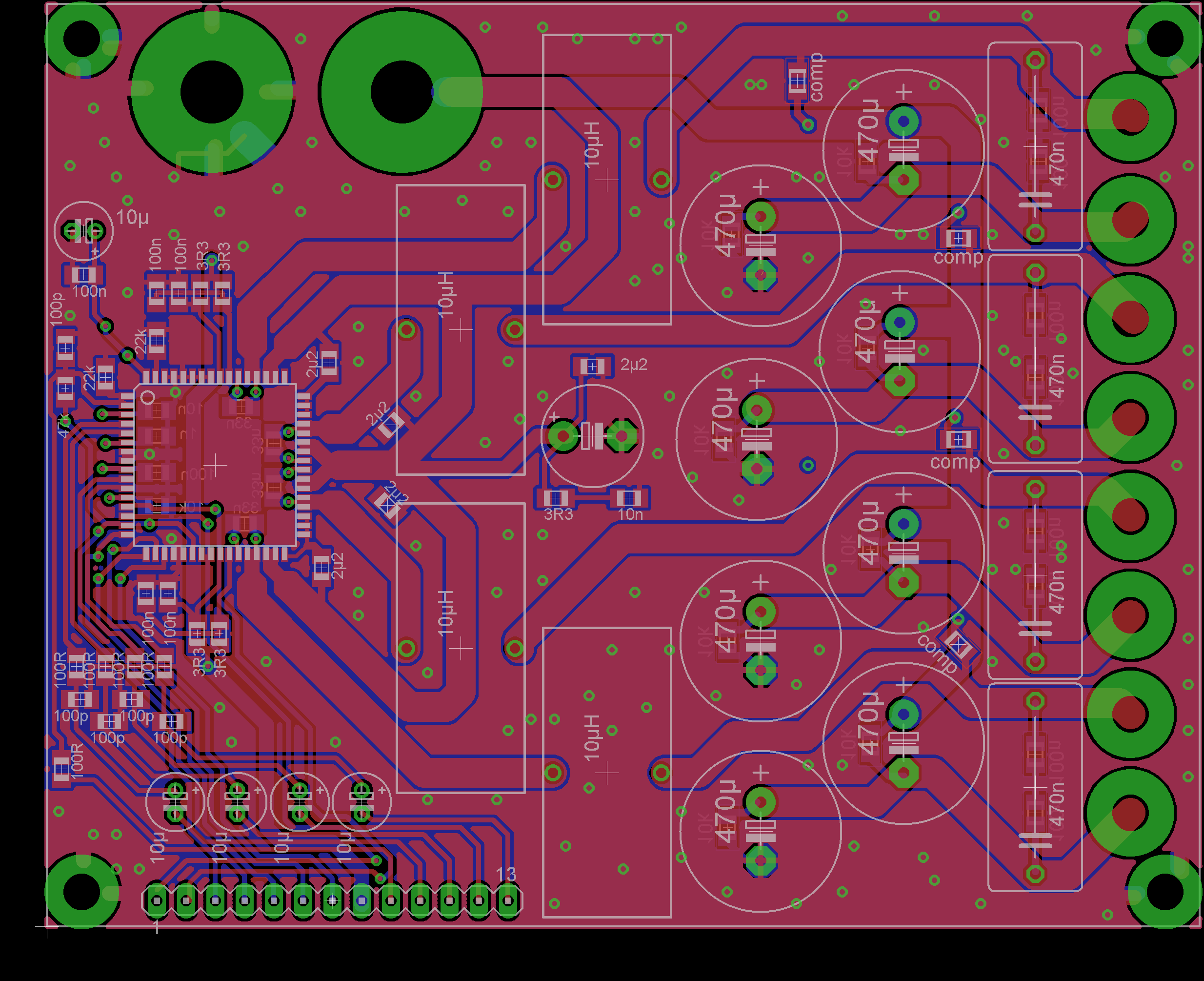

Hello,
As the TAS5630 is also capable of driving 4 loads at lower power, I decided to put it onto a PCB. Well, I couldn't fit the preamps on the board, LEDs are missing too, but there's a connector for all that stuff. I would have liked to fit it onto one PCB, but the free version of EAGLE won't let me do it :/
The schematic is directly taken from the datasheet, I tried to stick as close to the TI specs as possible.
What do you think of that PCB?
I've done this in abot 3-4hrs, while learning for my final exams ... I'll focus more on the exams now that the amp is done 😀
Best Regards,
Daniel

Update!
Here comes the update.
I reduced the output's pad diameter to make the ground plane get through them. Also, the mounting holes are now grounded, and a small silkscreen error is fixed now.
