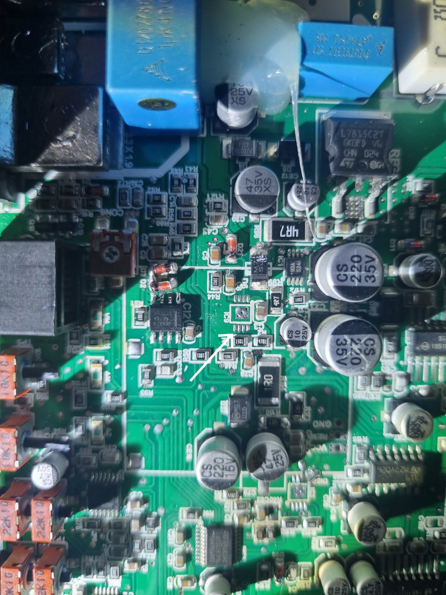

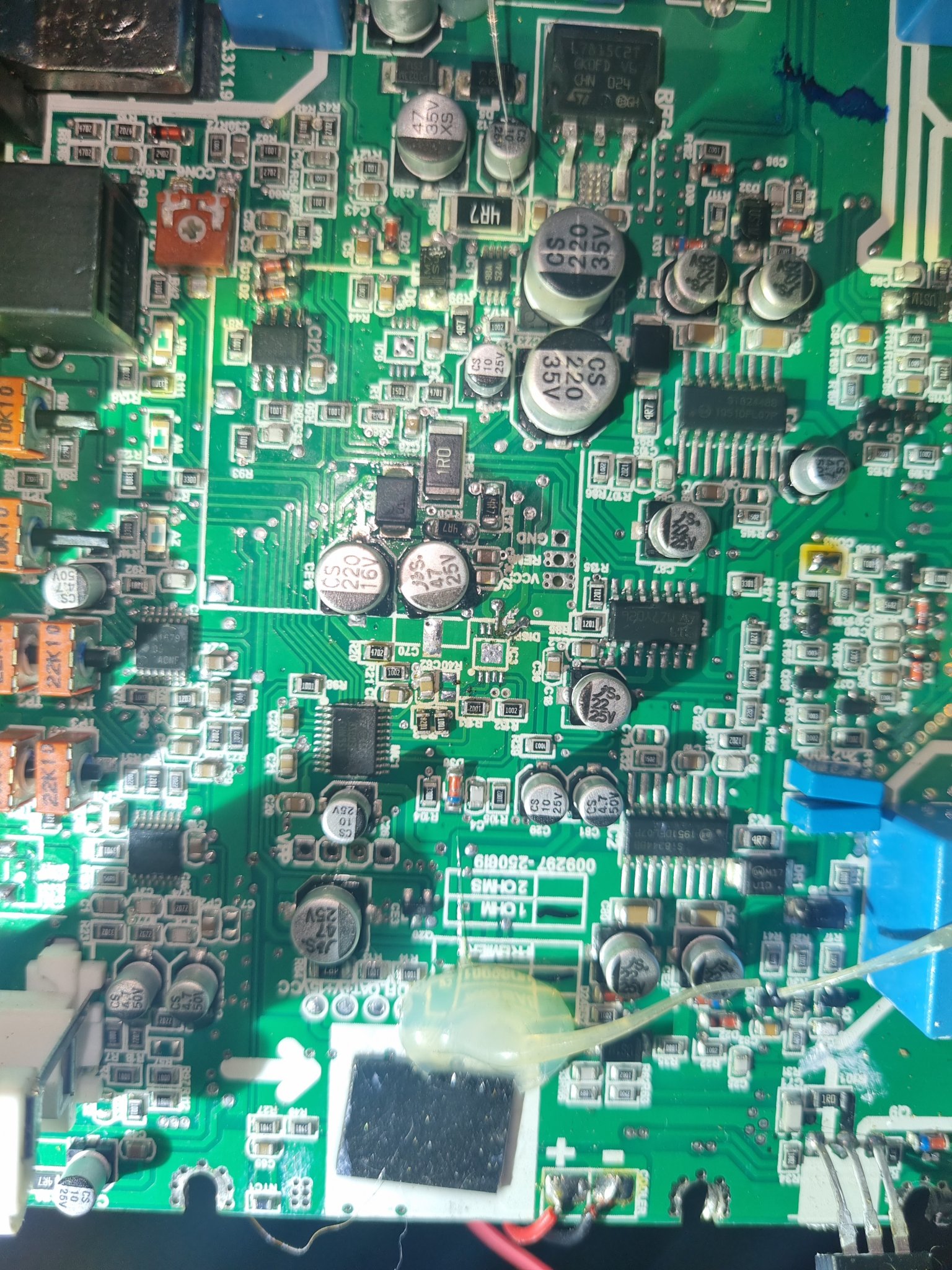

Just to let u know my progress.So far all power supply fets are blown and are cut out of the board. Amp draw was 1.5A (no ps fets)
I found 2 4R7 resistors that were blown. (Been replaced)

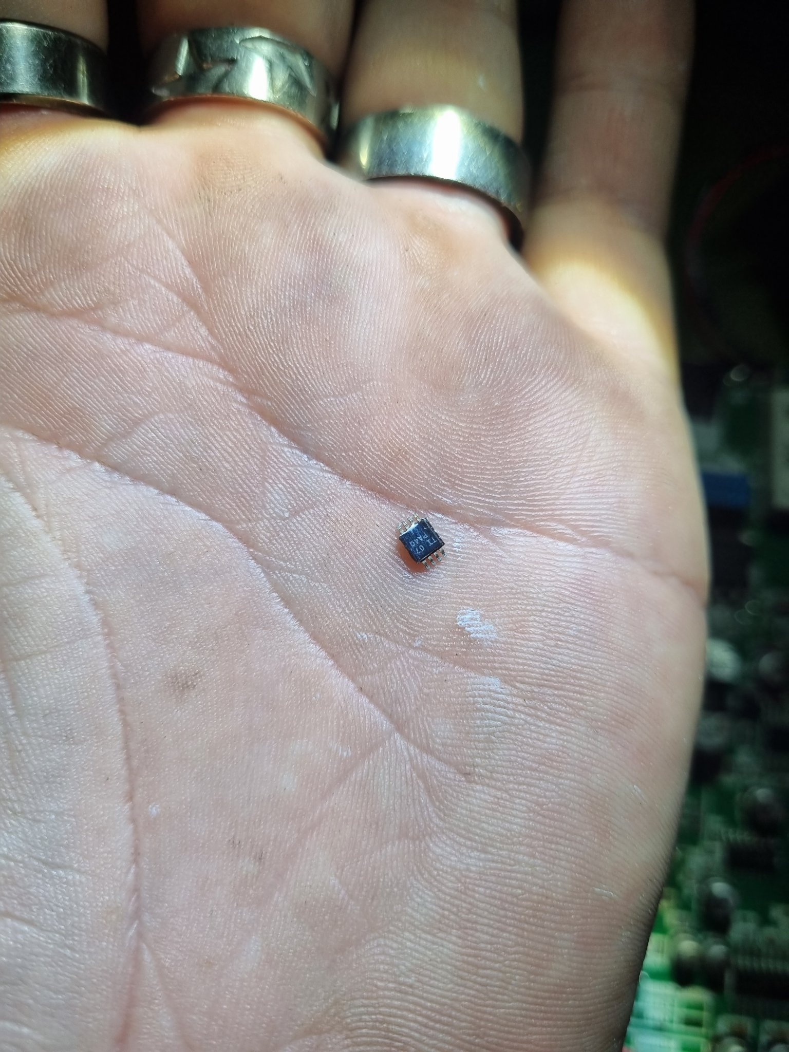

Amps red light was just flashing. Then I found the 2 faulty ICs. Removed both from board. (Amp draw now down to 0.1A)
I noticed earlier I was getting +15v on the test pin (marked +15) but now only getting 8v. Also getting 8v on the large voltage regulator.
Since removing ICs. Red Light no longer flashing. And only seeing 8v on the +15.
IC chips were getting hot.
