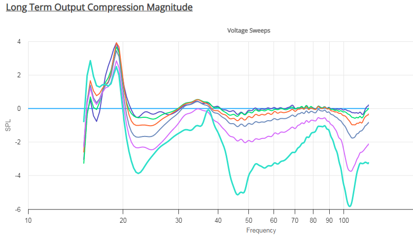

In the first attachment top row we have Othorn Hornresp inputs and schematic.
Lower left image bold trace shows Othorn predicted response. Notice the curve shape is already not even close to the low voltage measurement on his website that you posted. The light grey trace overlay shows what happens when you add Rg equal to Re. The low knee rises several hz and you get a 5 db saddle above it.
Lower right image shows a different tapped horn, a much more underdamped design. It's much more similar to the TH SPUD copies which were some of the first built and measured tapped horn designs. For an example look at the Hornresp sims of this clone. https://volvotreter.de/projects/th-2/the-tangband-cinema-sub-tapped-horn/ Since this was the one of the only built and measured diy tapped horns at the time and it was close to a Danley design, I made a tapped horn with similar undamped characteristics. The sim in the lower right panel of the first attachment is the design I built.
Notice that this design is wildly underdamped compared to the Othorn sim. And notice when you add Rg equal to Re the tuning goes DOWN, not up, and the overall response curve shape stays relatively usable.
If you add enough Rg the frequency response curve will melt down and have peaks exactly at the same spot as the impedance peaks. That's what you see happening in both these examples, but for some reason I'm not aware of, if the design is already overdamped like the Othorn, the lowest impedance peak (which would be aroumd 17 hz in Othorn) just isn't strong enough to keep the low knee in place. In an underdamped design like the one I built the lowest impedance peak does not disappear.
I've been told this added Rg example is extreme, it would never happen in the real world. But it did. Ricci measured this exact thing in the Othorn at his highest power sweep. See the second attached picture. The highest power sweep has the exact same curve shape as the added Rg sim I showed. The low knee rises several hz and there is a several db saddle right above it. See the third attached image to make it even more clear, this is the compression magnitude alone. It shows the same 5 db saddle the sim predicted.
I've been told that the highest compression sweep is extreme, it would never happen in real life. I've been told Ricci's several second sweep methodology is extremely punishing. The Othorn writeup says the highest power sweep would put 4300 watts into the impedance minimums. Let's examine that. Even in a sweep that lasts several seconds the impedance minimums are only going to be lit up for very very short periods of time.
Ricci's sweep methodology is extreme compared to an input signal like an acoustic folk band, where the only real bass is a kick drum spike every second or so. BUT Ricci's sweep is extremely weak though, if you compare it to an EDM track that has a three minute long continuous sine wave at the exact frequency of the lowest impedance minimum. On the Othorn that would be at the 29 hz tuning in the sim. See attachment 4 for Othorn driver power at xmax.

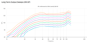

As per data-bass testing methods section, the long term output sweeps are 23 seconds long. If you look at attached image 4, the power peaks though the sweep frequency range are only maximally excited for a fraction of a second during a 23 second sweep, the rest of the time the applied power is some fraction of that. Also the 4300 watts that "momentarily" was applied at the impedance minimums for a fraction of a second isn't really 4300 watts, as he says himself, due to impedance rise. The thermal issues that are causing the response curve shape to shift at higher power are the result of increased impedance. When you increase impedance you draw less power.
So compare that 23 second long sweep that everyone says is brutal, in which the driver gets very high power for fractions of a second to an EDM track that has a constant (or at least persistent and extended) drone right at the box tuning, which is the impedance minimum and the power maximum. At xmax it's pulling about 2700 watts. How long will that driver survive? How bad is the frequency response curve shape going to get before it melts?
The data-bass long term output sweeps are not even close to the punishment a long term high power note right at tuning from modern music. And as per attachment 3, compression is happening long before the highest power sweep.
There's already 2 db of compression on the 38 volt sweep. 38 volts into the 3.4 ohm Re of this driver is only 440 watts.
Compression obviously happens in underdamped designs too. Unfortunately I don't have high power sweeps of the cab I built that is shown in the lower right panel of the first attachment. But we can look at the data-bass measurements of the DTS 10, which is presumably a scaled up TH SPUD. https://data-bass.com/systems/5b11c00551412e00047d6695 I don't have a sim of that and the measurements don't look underdamped but that's partly due to the very low tuning and stuffing applied both near the driver and mouth. If you look at the long term output sweeps of that cab, the more power you apply the flatter the response gets, just like the underdamped sim, lower right panel of attachment 1. The low knee should extend a couple hz lower as well but it's hard to tell in the measurements because the knee isn't well defined in the first place and the highest power sweep has a couple of wobbles that none of the lower power sweeps have.

FWIW, I try to emulate box losses in Hornresp TH sims by adding filling value of 2.0 to each segment and adjust afterwards to bring the predicted impedance peak values in line with the measured values. It seems to be a good approximation.
I built a BOXPLAN workbook for the Othorn some time ago, and using that, I determined the Othorn could provide more output if it was built 4" taller but was told by Josh that it was built that size for a reason. The result of doing so however is a response curve that's a bit more overdamped than it could have been.
Designing these things are all about choosing the compromises that work for you, and I think Josh chose those that work for him.
As for trying to smooth out the upper response of the TH by moving the driver further into the mouth, I consider THs as series-tuned 6th order BP designs with poor out of band resonances. The upper impedance peak basically defines the upper useful frequency limit. While you can get the response curve above that point to look a bit better, whether it's actually usable is another matter.

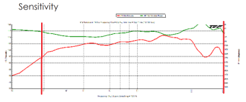

Attachment 1 shows the Hornresp sim of one of the iterations of the XOC TH18. How much usable range would you say that has?
Attachment 2 shows the frequency response of the measured Danley TH118 from their spec page which says "Operating range - 29 - 300 hz -10db, they didn't bother putting a readable graph on the spec page so I added thick red marks to bracket the claimed operating range. Now don't get me started on marketing specs but I don't think the actual listenable operating range is nearly that wide and for that matter -10db is a weird spec when there's a 16 db range between those frequencies. (The spec is based on the -10db down point from their arbitrarily specified 105 db sensitivity, regardless of the fact that there's a 6 db bump above 105 db at other frequencies. The spec sheet is useless, and while I'm complaining, I think the measurement is overly smoothed and that the claimed 1700 watt continuous power rating is bunk, it even says in the owner's manual that "Continuous does not mean "forever"! but then go on to specifically say recommended amp power is 3400 watts. Nothing on the spec page makes any sense and it's meant to confuse people. I hate marketing so much.
This is why |I'm asking questions. People here have heard both the XOC TH18 and Danley TH118 and countless other tapped horns. How much is actually usable? How bad does that group delay actually sound?

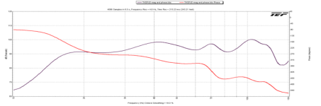

Attachment 3 is the Hornresp sim of the ltapped horn I built in early 2009. Looks terrible, right? I can assure you it sounds fantastic with a 24 db low pass at 80 hz. And it doesn't measure like that anyway. Not included in the sim is the extremely light stuffing I added to the horn. Maybe 1 cm thick layer of pink fluffy insulation peeled off a bat and glued to one internal panel for the first few feet.
Attachments 4 and 5 show my measurements. I believe attachment 4 was measured outside, at a distance of 10 meters, with no reflective surfaces like buildings or cars close enough to affect the passband. Attachment 5 I believe is the same thing but just for fun I put a handful of stuffing inside the horn mouth just to see what would happen because the TH SPUD that inspired this horn had mouth side stuffing.
In regular use I do not need the mouth side stuffing, there's no point. The problem harmonics near the passband are completely killed by the throat side stuffing and it isn't used above 80 hz. When I experiment with using it above 80 it sounds fine with music but it makes voices too boomy when watching tv. That might also be a small room acoustics issue that Audyssey can't completely fix but it doesn't matter, there's no need to use it higher than 80.

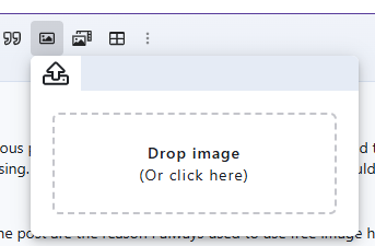

I just noticed that the attachments in my previous posts are not showing in the order that I uploaded them. This could make trying to follow my narrative and referencing the correct picture very confusing. Fortunately all the pictures are named so it should be possible to figure out what image I'm referring to.
This, and the ability to post pictures inline in the post are the reason I always used to use free image hosting websites instead of attaching images to the forum. Unfortunately all the pictures in all my old threads are gone now.
I will continue to post attachments but I guess from now on I'm going to refer to them by name instead of attachment number.

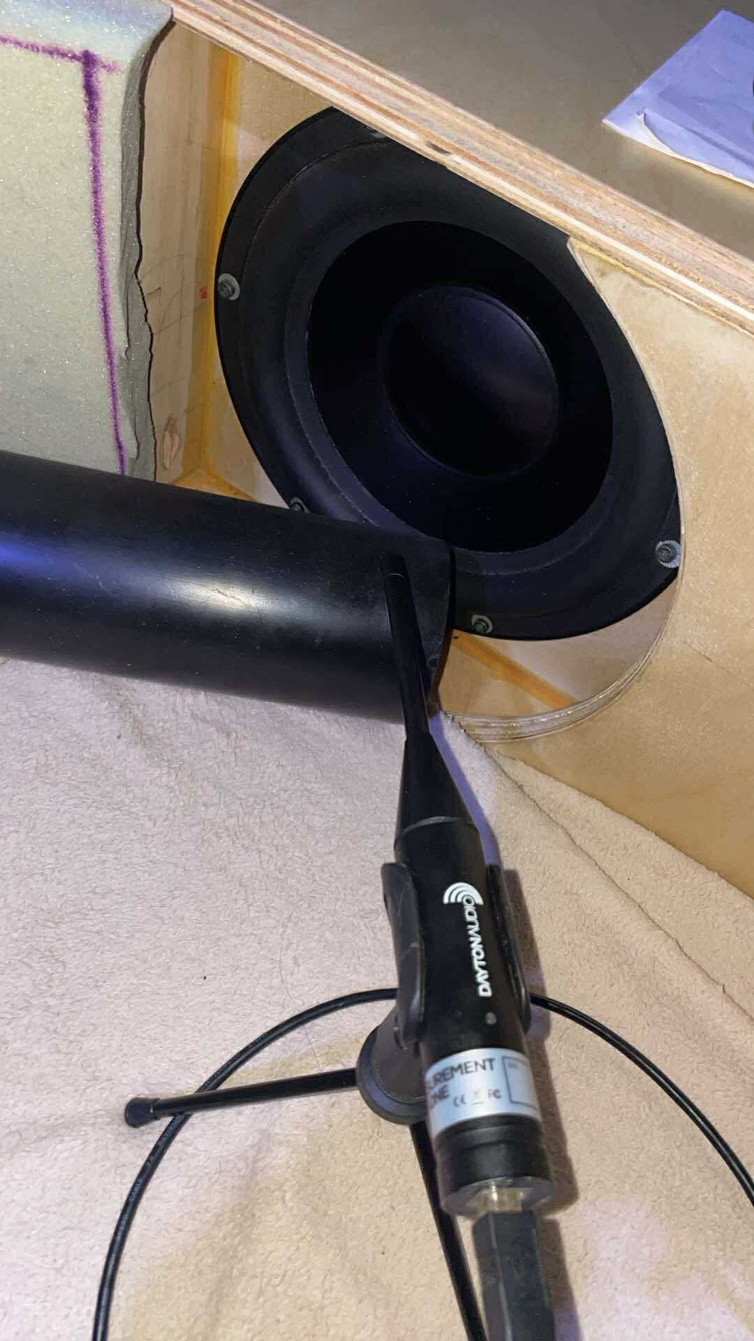

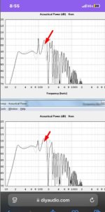

Just use a bucket from Home Depot 😂. Sorry, I’m just messing around with a bunch of pipes and junk at the mouth end of a ‘tapped’ qw sub.
It sure is interesting to look at the group delay and ‘echo’ like stuff in the measurement verses what my ears/brain are trying to interpret
I don’t think there’s enough vent air moving (it’s also ‘out of phase with the driver motion) at those frequencies to actually fill that in (with resonance) or fix it enough to be worth your efforts?

"Operating range" does not describe sound, and Danley gives an option between bass reflex, FLH, and TH.
None of DSL's home/ studio line uses TH, which tells the sound quality vs quantity story, "fine", vs "better".
DSL's addition of FLH to the subwoofer line was a response to market demand.
About this in particular, I'm not trying to draw this out or argue, but the SPUD is aimed at home theaters in particular. In fact there's no other practical use for it at all. The spec sheet even mentions home theater, it's actually the very first thing the spec sheet says.
It also says the operating range is 19 to 125 hz. Which includes all the ragged top end stuff, and for that matter, 125 hz is actually way beyond the end of the frequency response graph they show. What it does not say anywhere is that it might sound better if you don't use it above 60 hz, or that a completely different type of sub might be a better choice if you intend to use it from 19 - 125 hz. Even with the (probably) typical 24 db/oct lowpass at 80 hz, the SPUD's first big problem spike is firmly inside the passband.
Danley himself has defended the quality of the ragged top end of tapped horns in person on forums countless times. I've never once seen him suggest that there's anything at all wrong with it. If you know of even once where he's even hinted it's less than perfectly fine please show a link. He's said tapped horn have 3 octaves of usable range countless times.
Danley is undoubtedly more reputable than others in the industry but marketing exaggerations also seem to creep in to some extent, and in this case it's as much what you don't say as what you do. Nobody in their right mind is going to expect this to be usable in any sense up to 125 hz. Except the people who don't know better, and they are going to take whatever the spec sheet says literally.
