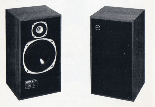

It's always useful to see an image of the subject:
You say you've "blown" the speakers - can you supply precise details?
The 8" bass/mid driver is designated 2048. Tannoy say that the T/S parameters for this driver no longer exist.

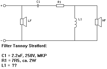

The crossover circuit is very simple with the bass/mid being driven direct and the horn tweeter being driven via a simple 12dB/octave high pass LC filter with resistor attenuation.
Yes. Foolishly, I drove them very loud for a party and suddenly all went quiet. No sound from main drivers and just little tweets from the little ones. Smoke from one of the cabinets. 😕
No apparent damage to the cones.
Since the main drivers are powered directly from the amplifier, you would appear to have burnt out their voice coils.
I can only see one replacement 2048 drive unit for sale on ebay at the moment.

You say the tweeters are still tweeting so the crossover appears to have survived. (The tweeters are unlikely to sound loud when the main drivers are not there to provide the bulk of the music.)
You could inspect the crossover resistor for signs of overheating and/or use an ohmmeter to confirm it still measures 7.5 ohms.
