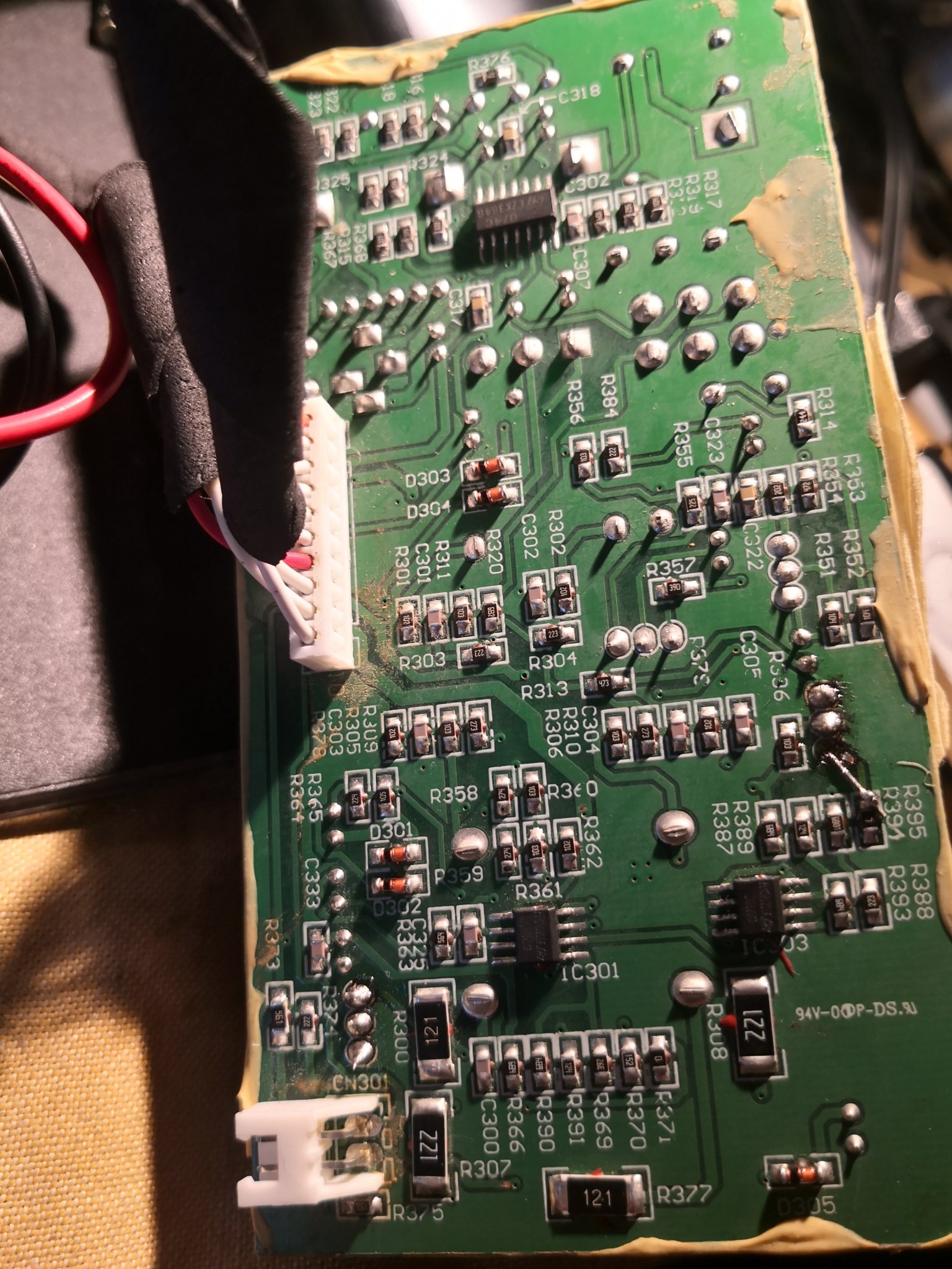

Hi all. I need a copy of schematic or service manual for Tannoy revolution 1001 subwoofer. Any one?

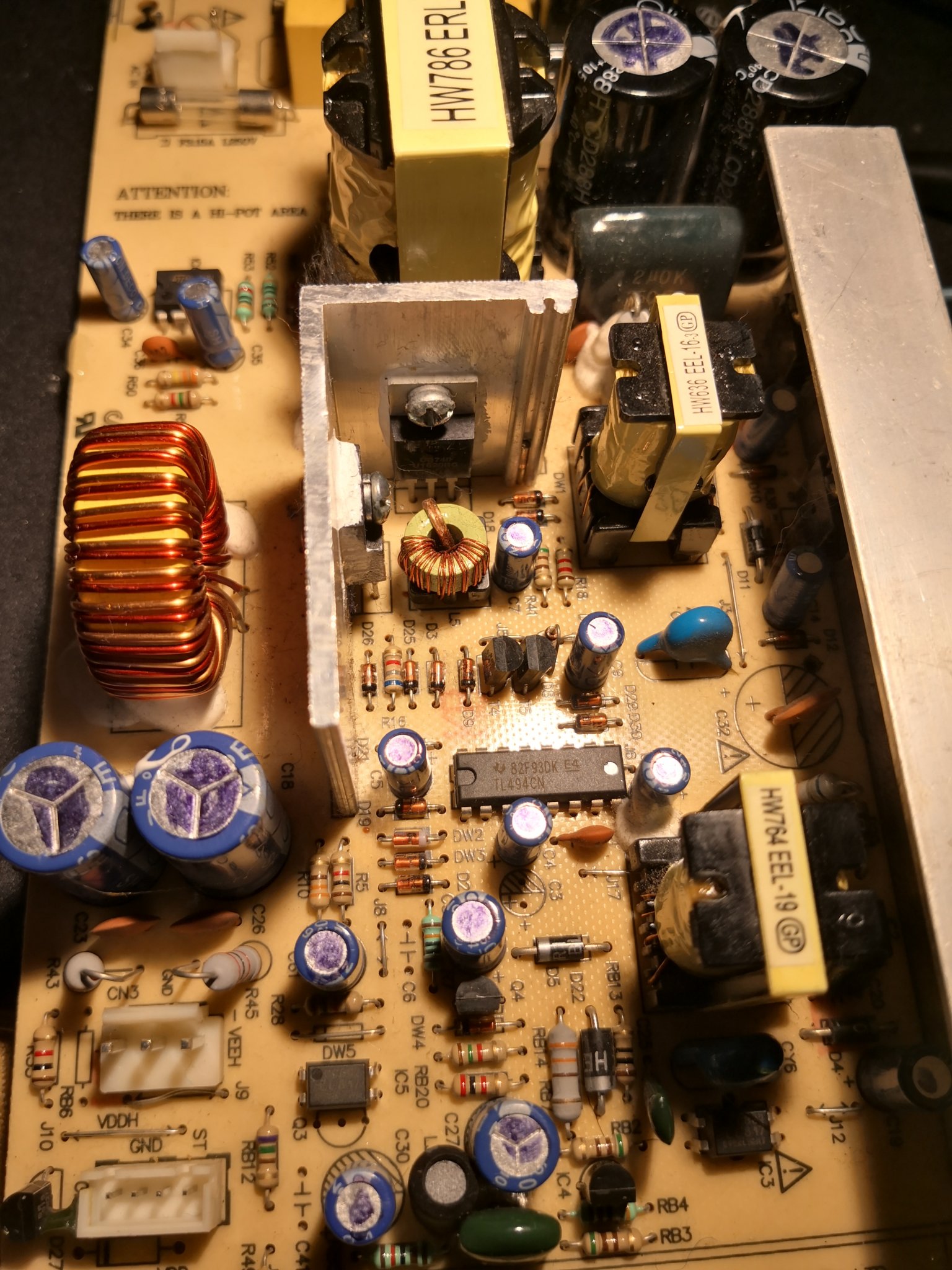

I have an issue with the sub that won't turn on. The presence of audio input signal doesn't switch on the smps.
Have replaced all the caps on the smps. Now just the led light switch from red to green but still no sound.
Anyone with suggestions.
Appreciate all comments

Has this been repaired before? The wire link on image 1 and some red plastic debris

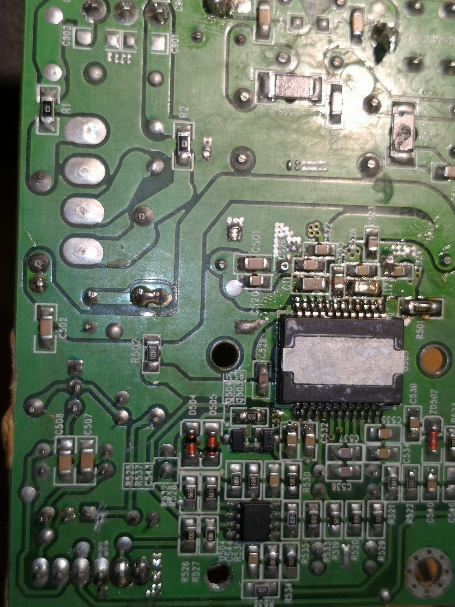

C32 on the second image looks like a ceramic when I would guess it should be an electrolytic with some microfarads not pF ?
