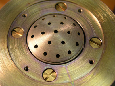

I have just been looking at an image of the Tannoy Westminster Royal "pepperpot" and there looks to be nothing much left after the holes have been drilled.
What is the advantage of the "pepperpot" over a large bored conical throat?

A large bored throat would have the effect of the output of the edge of the diaphragm traveling a longer distance than the center, causing HF cancellation and peaky response.Hi,

The "Pepperpot" holes are at angles going to the diaphragm, a primitive "phase plug".
Most (good) phase plugs for round diaphragms are now done with annular slits, which work better than drilled holes, but require more advanced machining than a drill press.
The function is as weltersys describes.
At some point Tannoy replaced the pepperpot with the tulip waveguide.
Technically the tulip is superior as it does away with the need of a notch filter in the crossover (although I'm not sure if the modern pepperpots still need it) and the treble is better controlled, less ragged and more extended.
That said the main reason for Tannoy to replace the pepperpot was its huge manufacturing cost compared to the tulip wave guide as it is basically a cheap to make concoction of plastic and pressed steel.

it only looks that way from the front, the holes spread back...

It's a rudimentary phase plug. The modern Tannoy "Tulip" is a superior phase plug.
