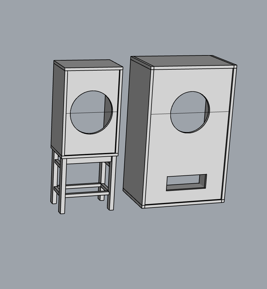

Hello,
I was wondering what I loose/gain by building these smaller cabinets ( see attached photo ) compared to bigger cabinets based on original Tannoy plans.
Ref ( comparison ) : http://www.44bx.com/tannoy/images/Lancaster3.gif
TNT ( comparison ) : [DIY project] DIY Tannoy 12" Dual Concentric Horn
INFO:
This IIILZ cabinet will be my speaker cabinet in my second hifi system.
It is needed to be a smaller cabinet, posting because of thoughts of cabinets for the future... and info from other builders that understand cabinets better than myself...
- Is it the bass frequency I will loose compared to Lancaster? This I can live with , but if there are other things I loose I would greatly appreciate an informative answer.
PS: I have already started building the IIILZ cabinets :) - will post pictures when finished !
Lancaster cabs work surprisingly well in 3/4" ply.. when all is said and done.
Smaller is a waste of a Surprisingly capable driver.
Buy something else if that size is a Necessity in your environment
Note that IS important to have the driver's axis at the proverbial sitting listeners' ear height ~38".
Building a small box that can't do a credible job of sub 200hz..then having to elevate it to get decent soundstaging.. is simply stoopid IMO.
A 150 litres internal volume is a good size for 12's.. Bigger can be even better aledgedly.. at least according to the tannoy designers.
Onken types have proven as Not Great with these... but Hey! take yer pick.

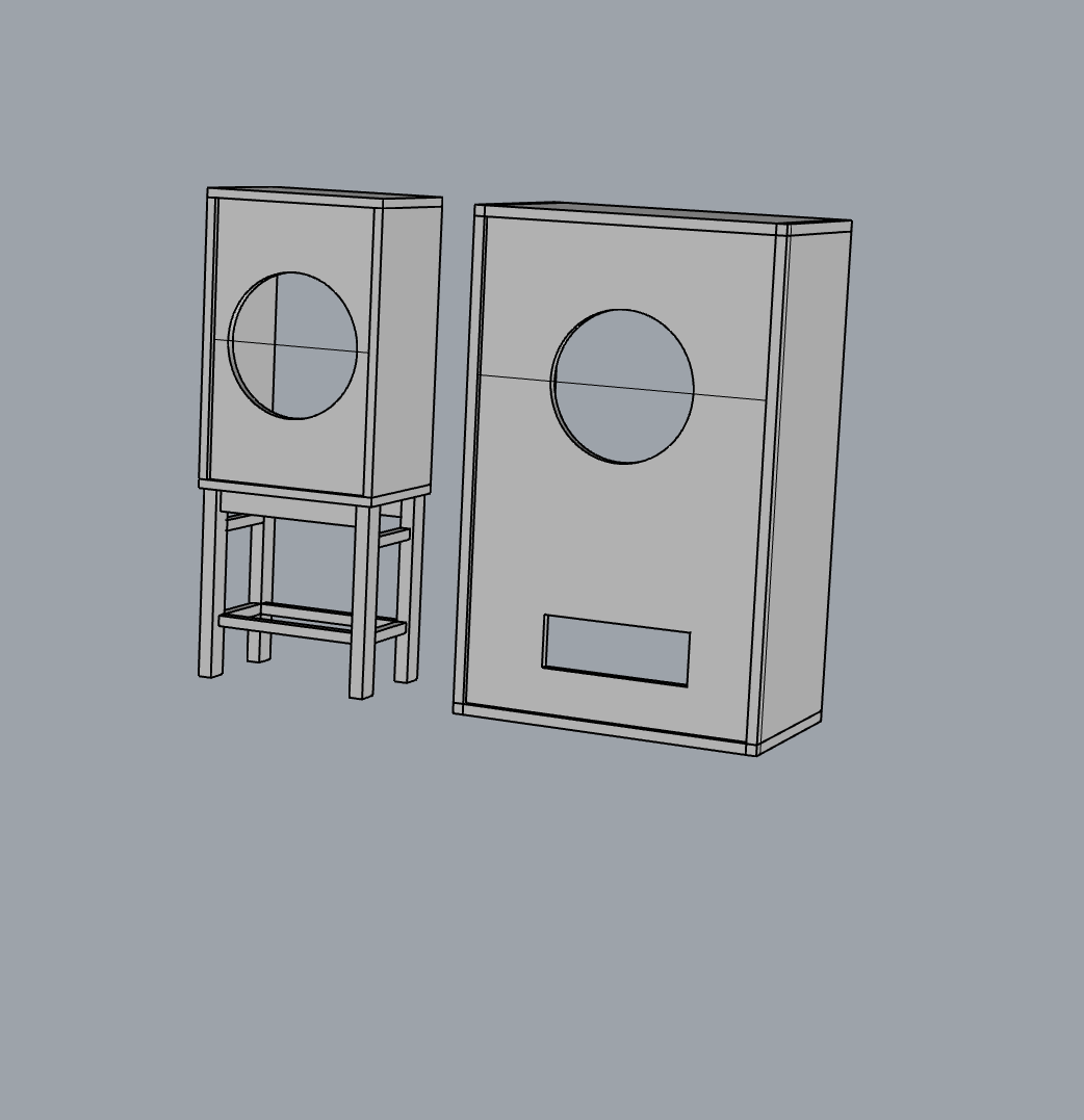

Thanks .
Building my smaller cabs in 3/4" birch ply.
Will not do anything with the original x-overs in the first place
- if I´ll do anything ; I´ll leave the originals as they are , and build new ones based on the old layout / schematics ...
My pick today is the LSU/HF/III cabinet ( on stands )
REF:
Difference on cab size attached ; the LSU/HF/III versus the Lancaster.
PS: I tested one of the drivers yesterday in a LSU/HF/III cabinet - I do really like the sound from these drivers.

I don't have any 10" or 12" Tannoys. Only 15".
I did my original 15" HPD in a 100litre cabinet based on Tannoy's diy version of the Berkley.
I have since moved to the 200litre cabinet that mimics the Arden.
I wish I had never built the smaller version. The big cabinet is what is right for the 15".
I suspect similar will apply to your 12".
Model it using software you understand.

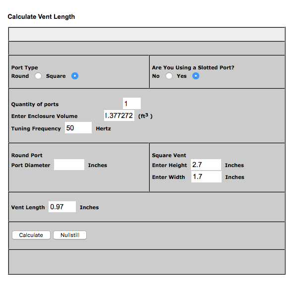

I found another site where I could calculate vents.
Here: Port Length Calculator
Screenshot from calculations attached
0.97inches= 24/25mm thickness ( that = the thickness of my speaker box )
A square port with the size of 6.9cm ( 2.7inches ) x 4.3cm ( 1.7inches ) like the calculations show ; close enough?
PS: I can install this port at the rear panel right ? - as long as they are freestanding
