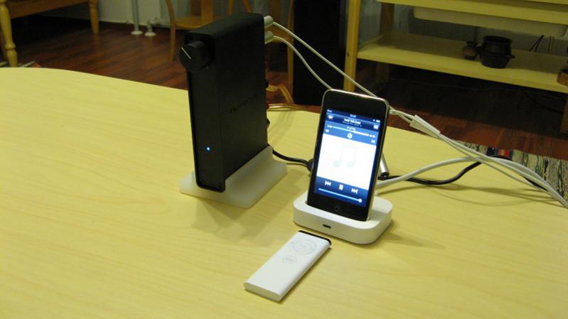

The speakers are planned to be used as a second stereo set in kitchen/terrace/sauna/bedroom. Music source is iPod touch and amplifier is Harman/Kardon HK 3370.

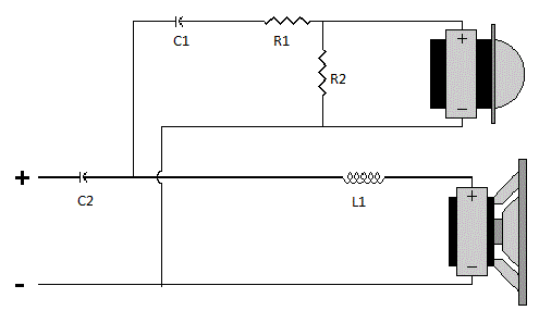

You got me intrested in tweeters! 🙂 Allthough the speaker is not finished I have made plans to add TangBand 28-847S at top of box. Here is the "plan B" crossover circuit for it. DIYAudioAndVideo.com has great tutorial about crossover designing. I'll probably get my speakers finished next weekend so after that I'll see if "plan B" is set to go.
C1 = 7.95 uF (2500 Hz highpass 1st Order Butterworth)
L1 = 0.51 mH (2500 Hz lowpass 1st Order Butterworth)
R1 = 1.65 Ohms (LPad 2 dB)
R2 = 30.9 Ohms (LPad 2 dB)
C2 = 400 uF (50 Hz highpass 1st Order Butterworth)

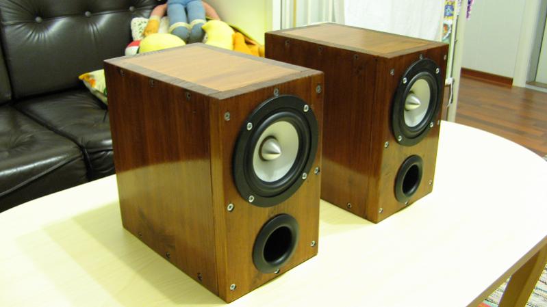

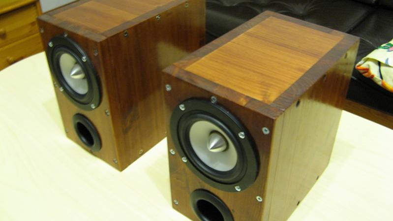

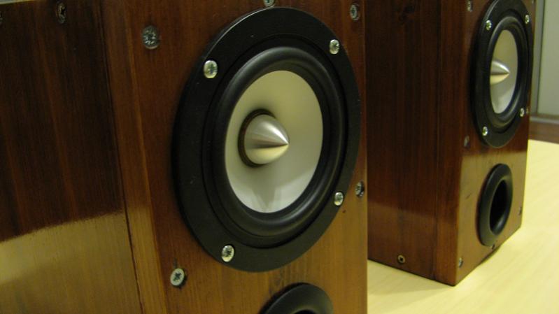

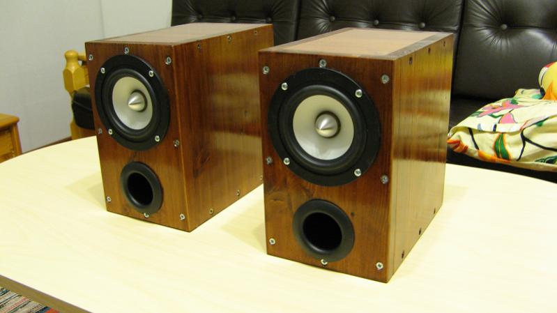

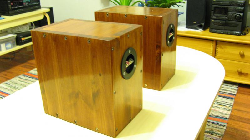

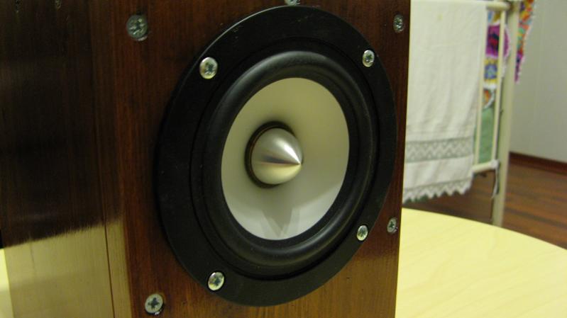

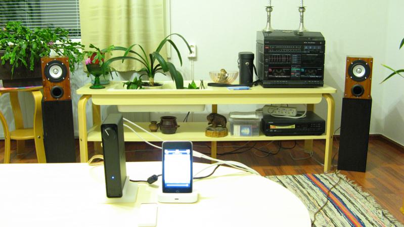

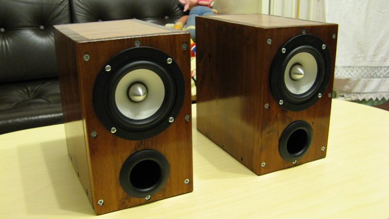

Here is couple of pictures of my TangBand W4-657SC Project. It's now finished! 🙂🙂🙂
Short listening test revealed that everything works ok and sound is ok. I couldn't hear any problems in upper range and lower range works ok. There is actual bass coming from the speakers. Subwoofer with these would be nice 🙂 Couple of pics from my test session 🙂
Cute and cost effective. Thanks for sharing the pictures.Great job! Now, what will your next project be? You can't just stop at one...

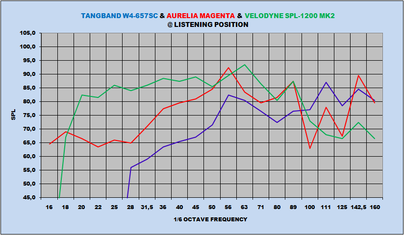

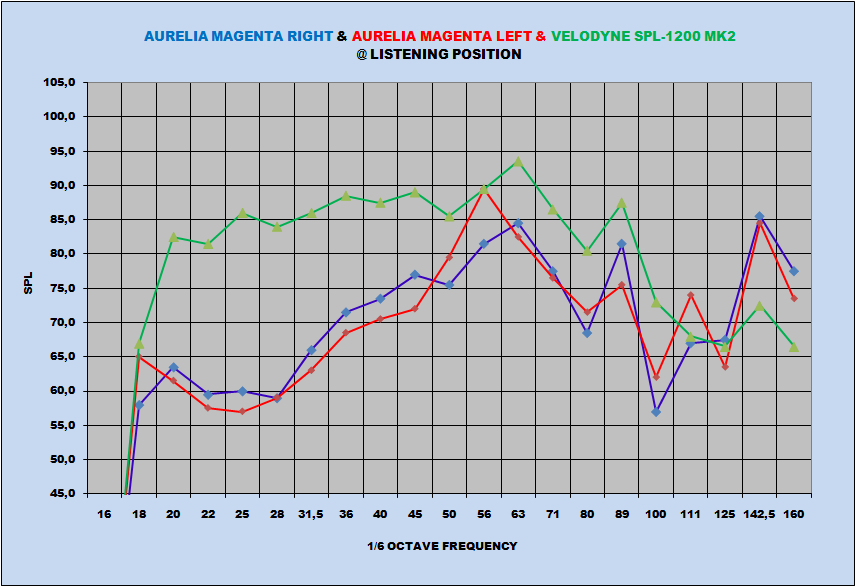

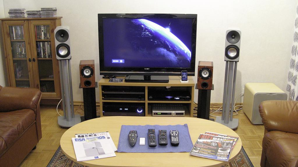

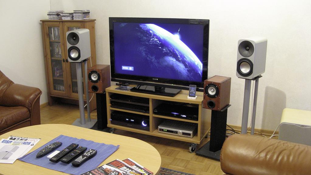

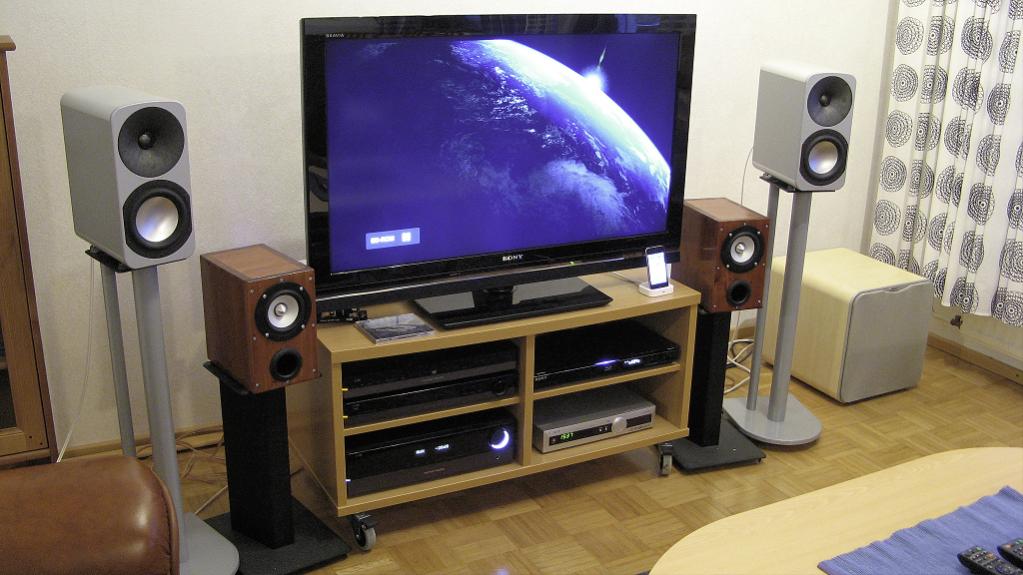

I just yesterday connected TangBands to main hifisystem and did a comparison against Aurelia Magenta speakers as a reference. There was slight lack of upper range. Otherwise upper range was ok. Lower range was ok also. There was good signs of the benefits of FR against 2-way in guitar sounds etc.. I got a little bit of listening fatigue from several hours of testing TB's. I only got 50Hz high pass filter in TB's, so there is no notch filter here. I'm pretty happy how these cheap W4-657SC's turned out to be. Maybe I just keep my DIY speakers as a FR. No messing with tweeters and crossovers here. 🙂 If someone is intrested in similar TB-projects have look at the bamboo drivers those should have better upper range. If one wants dynamic driver then these W4-657SC's are a good choice.🙂
Listening test (Based on - A Beginner’s Guide to Good Audio):
Clarity: 4- / 5
Resolution: 4 / 5
Soundstage: 4- /5
Speed: 4½ / 5
Bass: 3+ / 5
Here is my main 2.0 hifisystem:

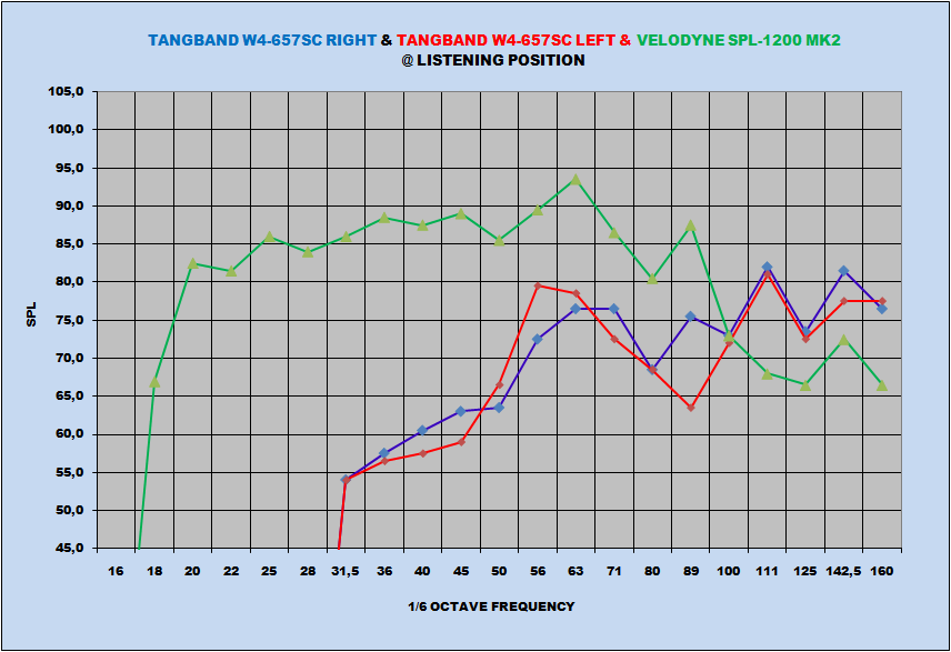

Those 2- and 3-chamber designs are very intresting.🙂 But I don't how to simulate those with WinISD.
Anyway here is my measurements of the speakers. Due to some serious acoustical problems in my room there are numerous hills in the graph. So it's hard to say how low the TB goes. Simulated F3 point was 82 Hz and considering the room gain...well who knows...🙄
It's not easy to find decent apartment with good acoustics. All three places where I used to live had also terrible acoustics. I own this apartment so I'm not considering to relocate. I have a spare bedroom which I could use for this purpose. It's symmetrical and squared space. There is a big window at end of the room. It's worth considering this option.
I wouldn't worry too much about the peaks and dips in the graph. What's important is the sound or the 'voice' of the speaker. The W4-657 has a very clean, natural and well-balanced sound to my ears, after taming the top end with a small value inductor.
Other 4" (100mm) full range drivers I've tried have sounded quite nasty at the top end and filters haven't improved them.
At the moment I'm unable to take measurements on the double bass reflex box but what I can say is that it's good for 40Hz and I can just about hear 15K which is probably the limit of my hearing (senior citizen ears) 🙂
