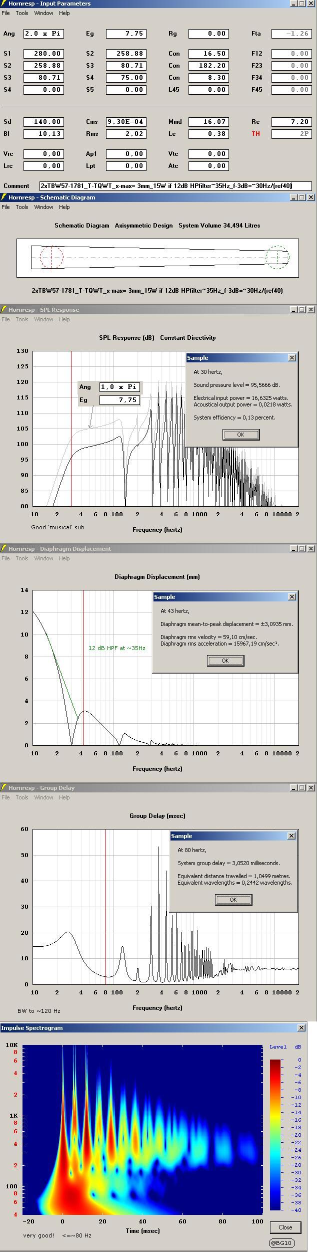

I think these drivers are very good for sub intended for music if placed within ~0.7m from a room(< ~50 m^3) corner.
A doable 34.5L= 1.22 cu.ft folding challenge:
b🙂
