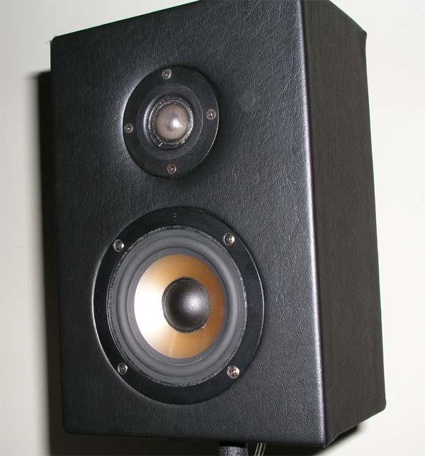

I resessed the tweeter a bit and tried to get a little better time alignment. I flared the resess to avoid any lips that may have given me peeks or dips... also it looked cool.
The boxes are 7.5"x11" and 5.25" deep for 3.3L. They are lightly stuffed with polyfill and have dual 'L" shaped ports exiting from the back.

And a little lower tuning.Not a lot just the 871s used as a tweeter in its own volume and the 319S1 in a larger volume.
Then the cone treatments?
Al
Also a 2 way not a 1.5
Al
