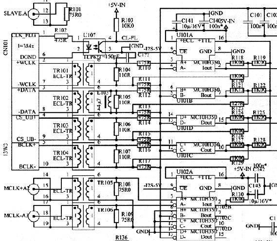

I've attached the I2S (enhanced) input section of the Assemblage DAC3.1 It uses MC10H350 for receivers. Transmitters on the other side must be MC10H352, if memory serves.

I dunno ftorres, your picture looks pretty complicated. PECL requires both-ends termination and uses more power than LVDS. I made the LVDS link with only 2 ICs and 4 passives.

Not as complicated as it looks 🙂 Just 'extra' components : input transformers, impedance matching resistors, pullup resistors, and so on. IMHO, the same goes for LVDS. If impedance matching is achieved (even with your ribbon cable - typically around 100R), you will have IMHO much better results than with no matching. Transformers are nice here, but you can try without... It's up to you. Whatever the technology behind, you must take care of the propagation between transmitters and receivers, and try to avoid any reflections caused by improper matching. Jocko ?
With LVDS, you don't need the pullup resistors. That is a PECL-specific thing. Of course you terminate your cable with a 100Ω resistor. In fact LVDS doesn't work *at all* without the resistor at the end. But still, it is extremely simple: on tx->cable->resistor->rx. Pulse transformers not needed.
