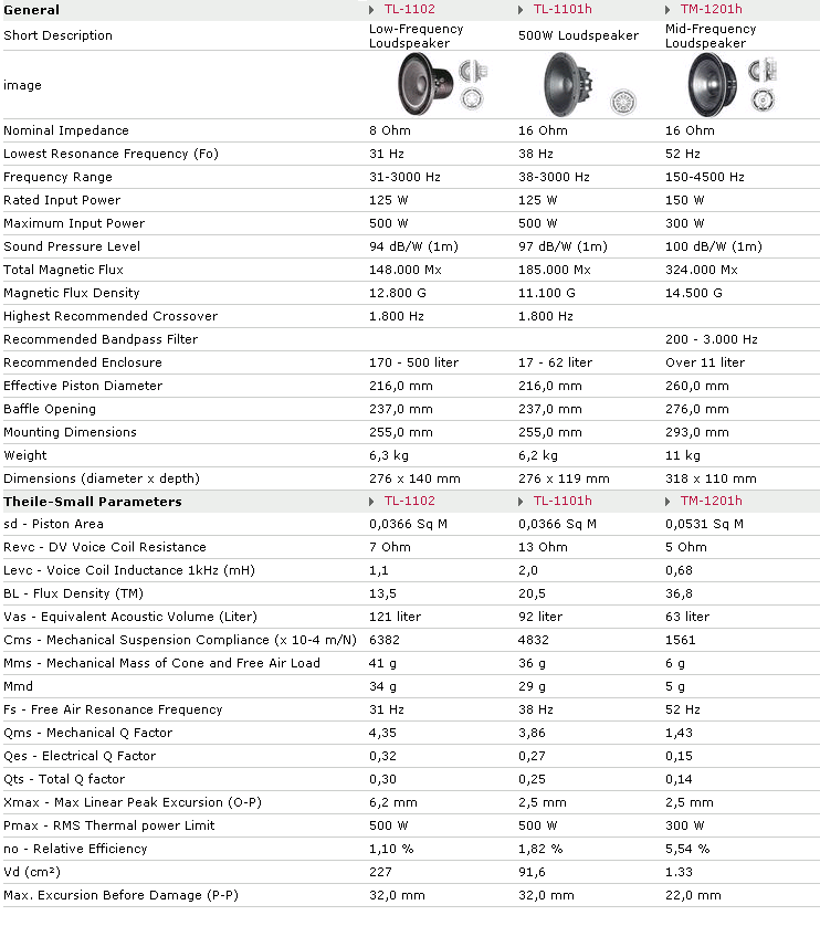

You could also consider the TL1101 in your comparison.
It has a higher sensitivity than the TL1102, and a much smaller xmax
The MMS of the 1201 is obviously a typo: it is 60g and not 6g, as is the Re of the TM1201H (something like 10.8ohms I think, I will measure it)
I have the response and distortion graphs of the 1102 and 1201 at home, I will try to post them.
I would be interested if someone had them for the 1101.

I think the TM-1201 is meant to be used as a mid. You will definitely need another bass driver below it. Perhaps good down to 300Hz or so.

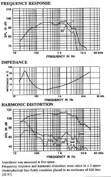

Here are the graphs from the TL1102 brochure.
Distortion is very low.
You can see a dip in the response around 700Hz. This is classic (cone resonance) and can be seen in almost any driver. I have seen other measurements of this driver that confirm this dip. In fact the fact that you can see it so clearly is the sign of a well behaved driver (similar reasoning to the on-axis dip you can see in perfectly executed OS waveguides: nothing to blur the theoretical behavior).
I don't think it is really audible, and seems quite well dampened.
The second attachment is a graph of the TAD 2251 speaker. The dip has been taken care of in the crossover.

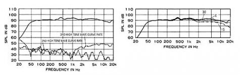

Here are the measurements from the TM1201H brochure.
Here you can the that the response is very flat, with no resonance, thanks to the cone material. The cone is quite heavy for a midwoofer (60g), but the motor is so powerfull that it manages to obtain a 100dB sensitivity.
Westlake uses this driver down to 200Hz in the SM-1
