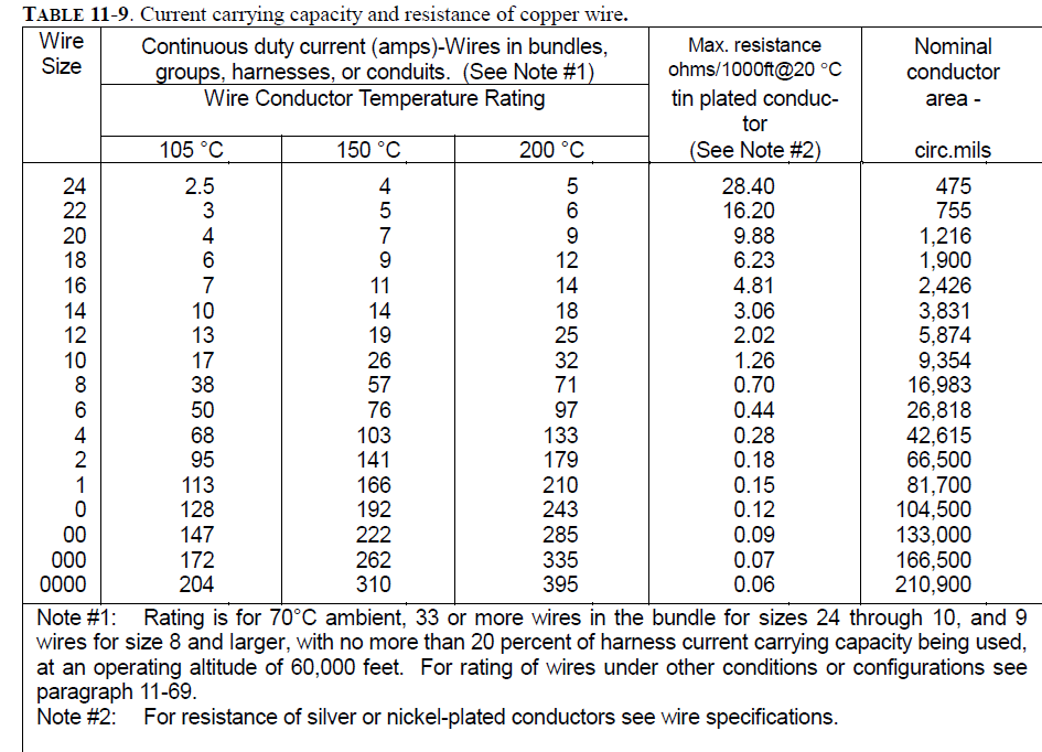

I wasn't really sure where to post this... This is a screenshot from the FAA Aircraft Standard Practices Manual "AC 43.13.1B". I haven't used this since college, and was wondering if these numbers look fairly accurate for the purposes of a power amps internal wiring. There are all sorts of charts online(google search), but most are in conflict with each other. Thanks to anyone who can help 🙂

I would be careful with this. It may be enough to keep aircraft flying with a 1 to 5 safety margin, but this is audio!

Thanks Jan, appreciate the response. Do you know if there is a similar table or plot that would be better suited for building amps?
Copper will pass 1000Amps per square inch. It equates roughly that 2.5mm T+E household cable will pass 25Amps, 1mm 10Amps 8mm 80Amps etc without much voltage drop.

That's why I originally thought the numbers would be an OK guideline(error on the safe side). Compared the the link ( https://en.wikipedia.org/wiki/American_wire_gauge ) suggested by Tedknowlegy. The numbers are more restrictive in the aviation chart (although it is for a different type of insulation).
The aviation chart is for bundles of 32 cables. That's got to make a huge difference in de rating. On the other hand, don't think there's any downside to large power supply cables.

Using the ratio's suggseted above I came up with the following:
10AWG = 2.59mm = 5.26sqmm --> 16.3A
12AWG = 2.05mm = 3.3sqmm --> 10.23A
14AWG = 1.63mm = 2.1sqmm --> 6.51A
Do these seem like reasonable current limits for the gauges selected? (Keeping in mind that the longest wire will be approx 12-15 inches; I think)
Those are very reasonable where you know that the insulation does not overheat.
PVC does not like excessive heat so it needs to be fairly well cooled. A twisted pair leaves most of the surface area exposed to the cooling air.
Where you have an insulator that tolerates heat better and you have good cooling you can comfortably double those currents to 6A/sqmm.
It's the insulation that you need to take care of.
looking at your table you will see that the ~3A/sqmm is not far off their 105°C current values. Now look at note #1 and see they have allowed for Ta=70°C. That means their table allows for a 35C degree rise. That would be pretty cool in cable that is exposed to ambient air of 21°C.

thin cables have more surface area than thick cables, so the 3A/sqmm or 6A/sqmm only holds true over a small range of sizes. Very thick cables will run hotter and may need to be de-rated. ultra thin cables will run cooler and can take more current. Flat thin traces have enormous surface area and can take enormous current densities.

The 6A/sqmm rule is good for me to keep in mind. I have easier access to 200C kapton wiring than PVC at the moment. 14AWG twisted-shielded triplet cable puts me comfortably at 12A capacity using that factor.

their table has used a temperature rise from Ta=70°C to a cable temperature of 105°C.
That temperature rise, of 35C degrees, for that group of cables @ that current will apply when Ta=10°C, or when Ta=100°C.
You start with the Ta you expect and add on the temperature rise to arrive at a predicted cable temperature. That must be OK for your chosen insulation.

I haven't used those charts in my career thus far. It is more ore or less for "general aviation" / smaller aircraft. The larger aircraft that I work on have very specific wire requirements to be complied with (right down to the brand, etc. - although you can use alternates if they are approved). I guess what I am trying to say is that you don't need to be able to do the math, or even understand it for that matter in my career; As long as you can troubleshoot faulty systems, read the schematics/ parts manual, and carry out the repairs. It's kind of sad in a way.
