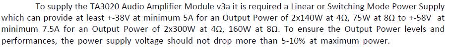

I am trying to design a liner power supply for my new TA3020(v3b by cristi), but i need help.
From the datasheet of the TA3020 v3b i got that
So, a 36-0-36 500VA should be enough.

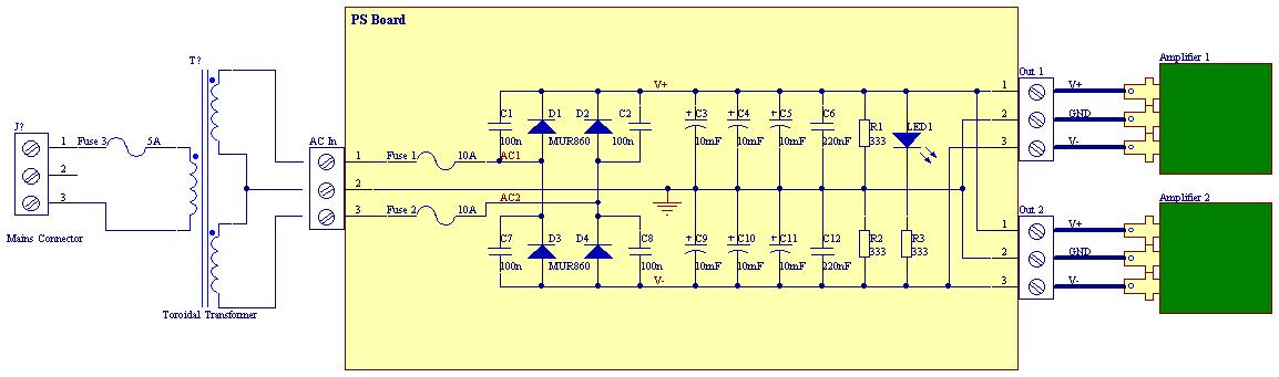

A little question.
Are C1-C2-C7-C8-C6-C12 mkp caps?
Your transformer is a bit light, but should be OK unless you are planning PA service. Bigger transformers will have better regulation, although I doubt you'll notice the difference between 5% and 10%
The specified bridge will work.
36 VAC will give you around 49V after rectification. You can go up to 40 VAC if you haven't already bought the transformer.
If your transformer is really 36-0-36 rather than 2 separate 36 VAC windings, you MUST use a single bridge. If two separate windings you can either tie the windings in series to create a center tapped winding and use a single bridge or rectify them individually.
You don't need the inductors in your application.
You probably won't have an issue without MKP bypass. You might try with and without. IF there is HF noise from the Tripath on the rails your electolytic caps may present a high impedance and the MKPs may be needed. OTOH, some have reported that the transformer inductance and the MKPcan cause resonances. You'll have to see what suits your application.
The 100nf and 220 nf could be MKP or MKT. Not strictly needed.
If you choose to use the LED power indicator, you will need to increase the resistor in series with the LED. You might want to go from one rail to ground to reduce the power wasted. Choose an LED current to suit your brightness requirements, say 5-10mA. Subtract the LED voltage drop from your rail voltage (1.2-5V depending on color) divide the remainder by the chosen current to get the resistance required. Multiply the voltage across the resistor by the current then by 2 for a safety factor to get the power rating.
Also, R1 and R2 should be higher - 3-4K 3W.
Don't use MUR860s for this application. Use the bridge you specified or MUR2060 to give you a rating margin.

I still have to buy everything so I can do every change in freedom.
Let's take Cristi's scheme as ex
- C1-C2-C7-C8 100nf, 400/250 DC/AC voltage is enough?
- C6-C12 220nf, 400V
- Should r1 and r2 be non inductive?

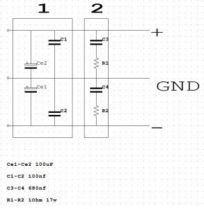

Should i also make 2 filter like those
The first (1), a smaller value cap of 100uF in parallel with a 100nF capacitor filter out any RF signals or other disturbances , and finally (2), an RC network, 1 Ohm/17W in series with 680nF, gets rid of any residual capacitor inductance.
R1 and R2 in the post 4 schematic should be 3-4K, 3-5W
You don't need the additional filters, but if you want to use them any caps rated over 63V will be fine.
The resistors in the snubber (filter #2) don't need to be 17W, 1W would be fine. The proper values of the cap and snubber depend in large part on the transformer. Search the threads on snubber design, its fairly complex. You won't do any damage, but you aren't likely to do a heck of a lot of good with random values.

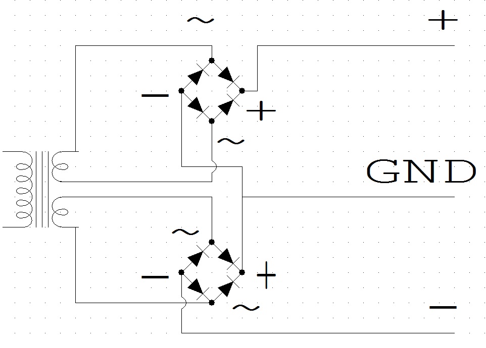

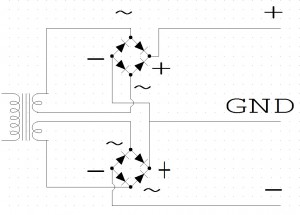

Are the bridges connect correctly as show in this schematics?
Hope this is the last question
Thank you
