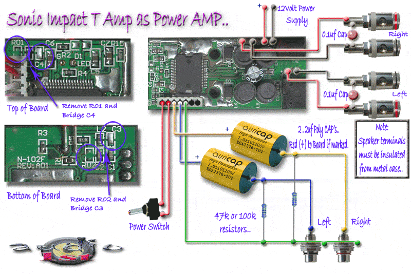

i have done the "stealth" mod but want to skip the volume pot and use as a poweramp but i´m not shure how to do it. Is it as simple as connecting the input wires with the new caps together for the left/right channel?

It's just occurred to me that your diagram relates to the "Stealth" mod. I have carried out the "Classic" mod. I assume that I would still need to add the 47k or 100k resistors in addition to resistors already attached to the other end of the capacitors ?

Puffin said:I assume that I would still need to add the 47k or 100k resistors in addition to resistors already attached to the other end of the capacitors ?
That is correct. The resistors in the diagram posted by Audio 1st serve to set the input impedance. The volume pot does the same thing, as well as acting as a voltage divider. Without the resistors you run the risk of noise on the inputs. Lower input impedances generally have lower noise.
Tuberider. I did it last night as my very small brain realised after I had asked the question, that the resisitors simply take the place of the pot. It was late last night when I got around to doing it, so I will have a listen tonight and see what it is like. I was using a 20k Alps Blue Velvet before.
Panomaniac. What difference would using 100k resistors make over the 47k I have used ? Does is lower the gain ?

Puffin said:Tuberider. I did it last night as my very small brain realised after I had asked the question, that the resisitors simply take the place of the pot. It was late last night when I got around to doing it, so I will have a listen tonight and see what it is like. I was using a 20k Alps Blue Velvet before.
Puffin said:What difference would using 100k resistors make over the 47k I have used ? Does is lower the gain ?
It shouldn't lower gain, as long as your source is good.
What it can do is lower noise. You see, noise may have a high voltage, but it doesn't have much current, or power. If you try to drive a low impendence with noise, it just can't do it. It can, however, drive a high impedance input, because that input requires very little power.
That is why long lines are often low impedance as well as balanced. Your preamp or CD player can provide enough current to drive a load of 10K or less. The noise picked up on the inputs lines can't. A simple way to "Separate the Men from the Noise" so to speak. 😉
