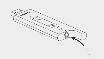

The product blurb states "The RXD2 USB stick receiver connects directly to Windows or Mac computers, or with any Samson Expedition Series portable PA system (sold separately) that features a USB wireless port." It does not mention that it will work with any other brand of PA system.

You can connect the RXD2 USB stick receiver line/headphone output to MIPRO MA705 line-in via a 3.5mm to RCA cable.
