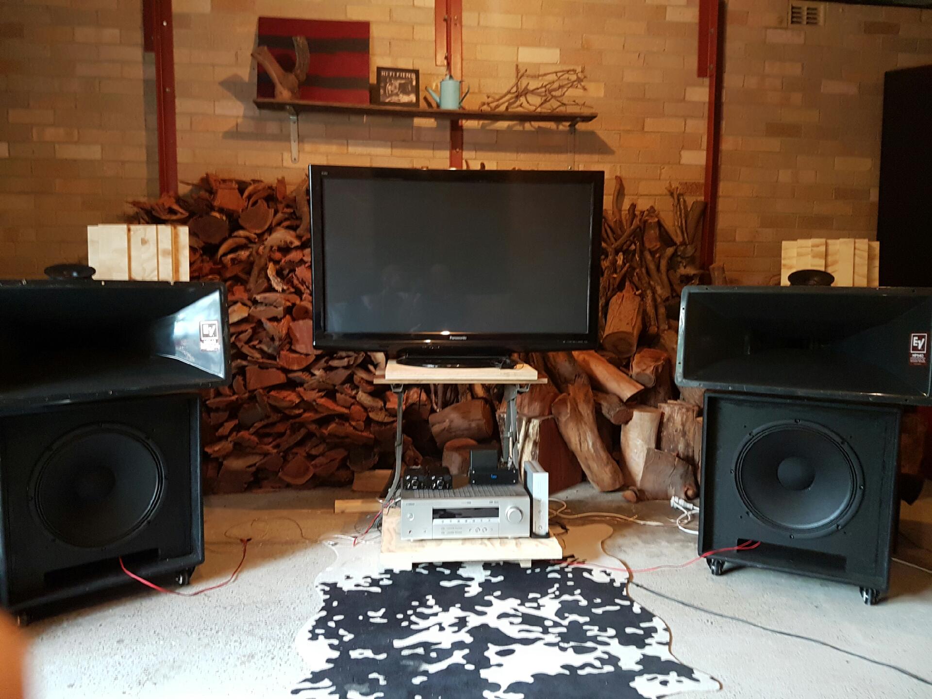

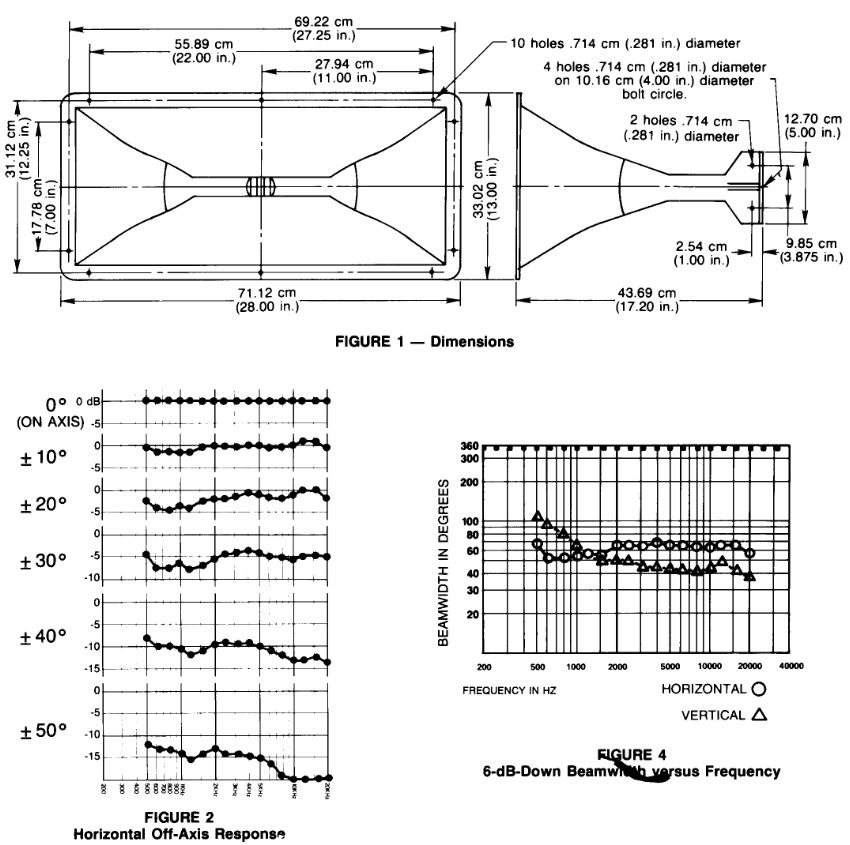

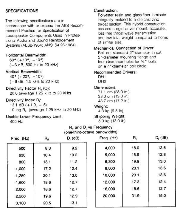

Thoughts on converting a fibreglass HP640 horn to a synergy type horn? I currently have a 2" compression driver crossed at 550hz 24db electrical and it sounds great. However my curiosity is getting the better of me and I'm considering drilling some holes. The throat is very narrow and it would be difficult to clean and smooth the holes but possible. And I could extend the mouth to to get lower directivity. Any thoughts on the advantages of this endeavour over my current setup? Thanks
You cannot locate the cone drivers close enough to work properly, unless you would also bi-amp and use a delay line.

Biamping is the plan so delay is not an issue
And yes the does sound very good.

What do you expect to gain by adding a couple cones and another crossover over just the compression driver?
Im hoping to get atleast another octave of loading, pattern control and point source behaviour. I realise I would need to extend the horn mouth to achieve this.

I concur with Soldermizer.
Besides, with that horn's long throat, you might have problems getting the quarter wave notch high enough to be out of a midrange's way. It's one of the reasons most Synergys use conical profiles -- shortest distance on the throat from tweeter diaphram. Maybe if you had it cut in pretty low in freq....
