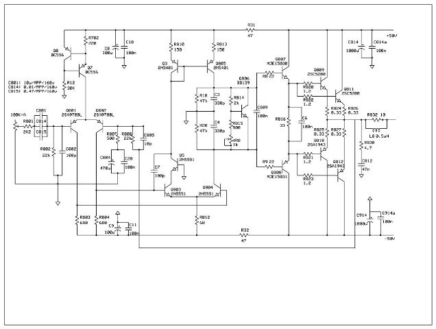

Symasym5 modifid circuit
hi, i am not good in electronics as all of you. i need help for this circuit design. at first i got it from Symasym5 then went to pavel site to have this modofied circuit design. i have build it. now i have modified by adding one more power transistor 2sc5200 and 2sa1943. i circled the design. do you think it is correct way to adding power transistor in parallel? i have posted the pic.
thank you.

This is a bipolar design. Depending on your choice of driver transistors and their idling currents, you may run out of base current in demanding situations.
If the driver heatsink is up to it, you can crank up the current, however you should know what you're doing ;-)
I'm sorry that I cannot give you more details as I'm do not know the Symasym well enough.
All the best, Hannes

adding more transistor
hi,
i am just wondering, i have added one more 2sc2500 meanse 2sc5200 2pcs and 2sa1943 2 pcs, what is the power of my amp now? my voltage is +-34 dc.
if i add more transistor and operate -+34v dc will it be declining the sound quality? like luxman used 4 pare of 2sc5200 each chanel.
i don't know if the wats goes high or the depth of the sound will be change.
thank you..
MikeB said:
The power will not really increase by adding more output devices. And it is likely that you reduce sound quality.
Mike
Only if output BJTs are not well matched for Vbe and hfe.
Once matched, the sound quality are better than the same amplifier with only one output pears, because of more classA current for normal listening levels.
MJW 0281 are no longer available from OnSemi but just take the NJL 0281 - its an MJW in a slight smaller package and 2 additional PINs for Thermaltrak.
For use in the symasym you have to twist 2 Legs because of the slight different PINs. Several User of the german Analog Audio Forum (AAA) successfully used it in symasyms projects.
I sold my MJL4281-Symasym in February and now I am building a NJL0281-Symasym.
Check the Datasheets - the MJW0281 and NJL 0281 are identical DIEs. Use the Samples programm of OnSemi...dont forget to get the complementary NJL0302 transistors too.
