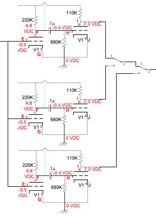

There is situation that I need help about switching tubes. The situation is I am making a guitar pedal (overdrive) with a tube... The original design has one tube, but I want to use three tubes and switch between them using relays. I know this sounds interesting but I am trying to figure out how I can do that...
Only one tube should be active and by using relays, I need to switch between tubes. My question is, where should I install the relays on this drawing.

PS: Pin 3 is connected to pin 4 on the schematics. And all the tubes are identical.
And here is the schematics:

Do you mean, that you want to use 12AT7 tubes from different manufacturers?
No, different but equivalent tubes like 5751, 12AT7 or 12AU7
are you thinking of switching all the connections from tube to tube?
heaters would need to see a constant supply otherwise warm up time will be a problem.
in looking at the schematic i'm not sure that plate voltages are adequate for a 12at7 nor does there seem to be any sort of voltage multiplier in the power supply.

The easiest way to do that with the three (actually two) single-pole relays you showed, is just to have three circuits and switch the outputs. Dunno if you're trying to switch between tubes in the middle of playing though, in which case you'll need cap coupling to avoid pops.

Thank you very much. I don't think I need to switch all the connections. Actually I don't know which ones to switch to make one tube work only... That's the reason I am asking here to figure out which pins I should switch...
You are right about heaters, I was thinking that. So heaters may stay connected I think, without relays...

merlins suggestion to switch the outputs is spot on. It also gives the possibility to have individual and independent adjustments for every tube.
I would however have an output cap + ground reference for every tube, this to prevent "click" when switching.

The simplest solution would be to switch the outputs from the tubes.
Leave all the heaters on.
The valve inputs wont load the gain stage much so all can be connected at once.
