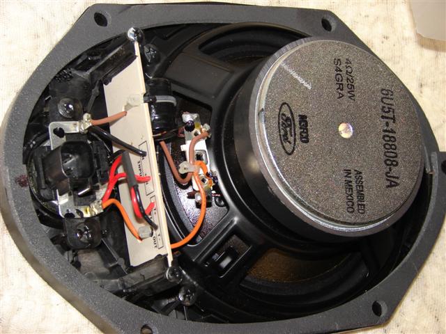

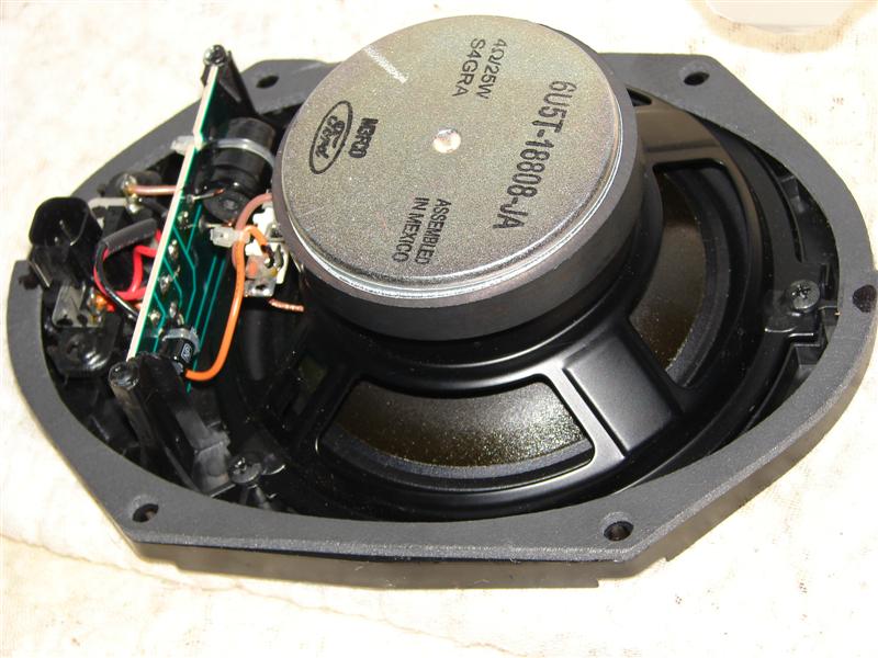

I actually bought some of those and was surprised at the construction.
Not bad at all for the price, but be aware that all components (xo and drivers) are glued in place so it is not an easy task to take them off of that mounting plate. If you were thinking of doing that...

edit: Oh ~ would it be convenient for you to post some more detailed pictures of them for us? And, how do the crossovers look? I imagine they use very cheap components? (thin wire inductors and small electrolytic caps?)

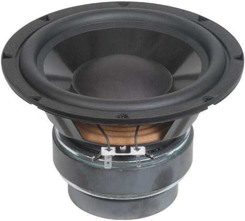

It doesn't have vented pole piece but it has open basket at least it appears so from this angle.
I have those 5x7 speakers and tore them apart already
And took some measurements too. In stock form they had quite flat response at 60 off axis. Maybe I'll post some pictures later.
Crossover is just ferrite core inductor and capacitor.

troystg said:Pic 2

edit: Oh - thanks for posting those pictures!

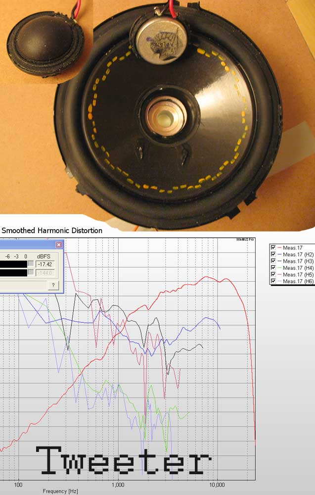

MisterTwister said:ok, these are my tortured drivers.
distortion measurements for tweeter.
I think that tweeter does need it's wave guide to be left on, looking at the response measured.
