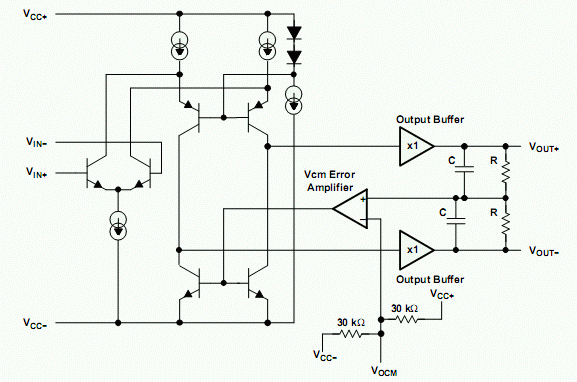

By the datasheet of the OPA1632 I missed the internal circuit diagram.
This could be helpful for better understanding and implementations of new ideas in the whole circuit.
Who knows more about the internal topology?

...By the datasheet of the OPA1632 I missed the internal circuit diagram....
Here it is:
thank you very much.Here it is:
Where you have this discovered?
A certain similarity to the AD797 should not be overlooked (see attachement). The difference is mainly the balanced buffer driving and the absence of current mirror. Current mirror was often used for unbalanced output. But I hate current mirrors. Check out therefore this:

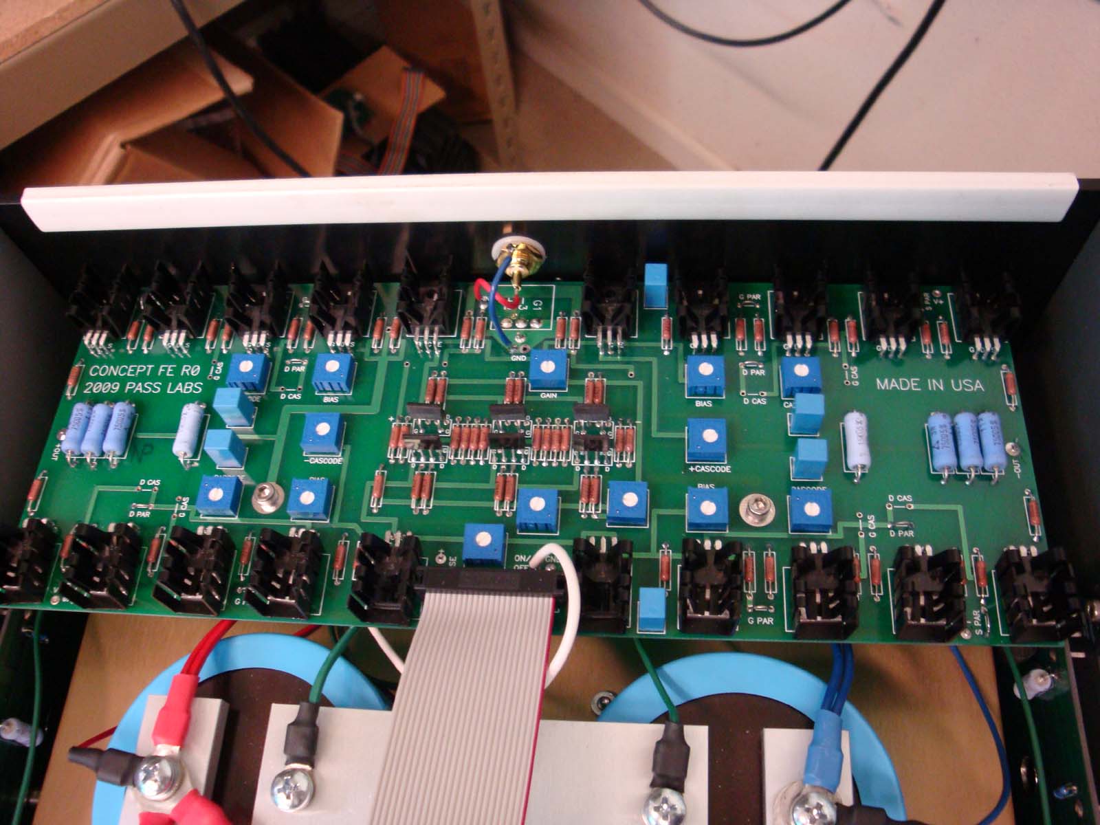

Next from Cyberdyne Systems : the fully differential BF862 discrete opamp.
Done, but opa1632/ths4131 still sounds better

=> SLOA054, almost identical to the schematic at page 2 in Bruno Putzeys' article i linked to.
Also read SLOA072 and SLOA99 from TI

I have one in DIP12 package, and sounds better than OPA1632, but have thermal drift which is too large for my taste.
So I will not post. But as clever as you are, you will figure out from my DIP8 discrete opamp. Patrick

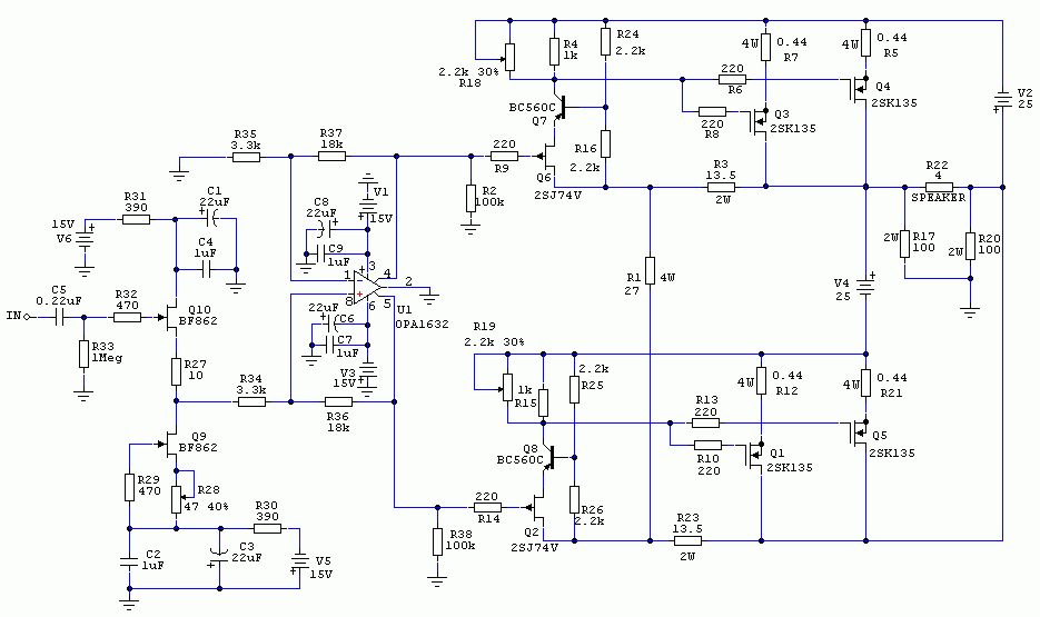

Therefore a new approach was realized from you (see attachement). I strongly suspect that this is also a Circlotron, similare than the mentioned version from post #1, but a discrete version - isn't it?
(have a look also about post #2 about

Do you talk about the schematic in diyaudio.rs post 1 linked to in post 1 here ?
https://www.diyaudio.rs/uploads/monthly_12_2009/post-20-126057485619.gif
- SuSy Circlotron - jFET input Buffer + OPA1632 + 2SK135
