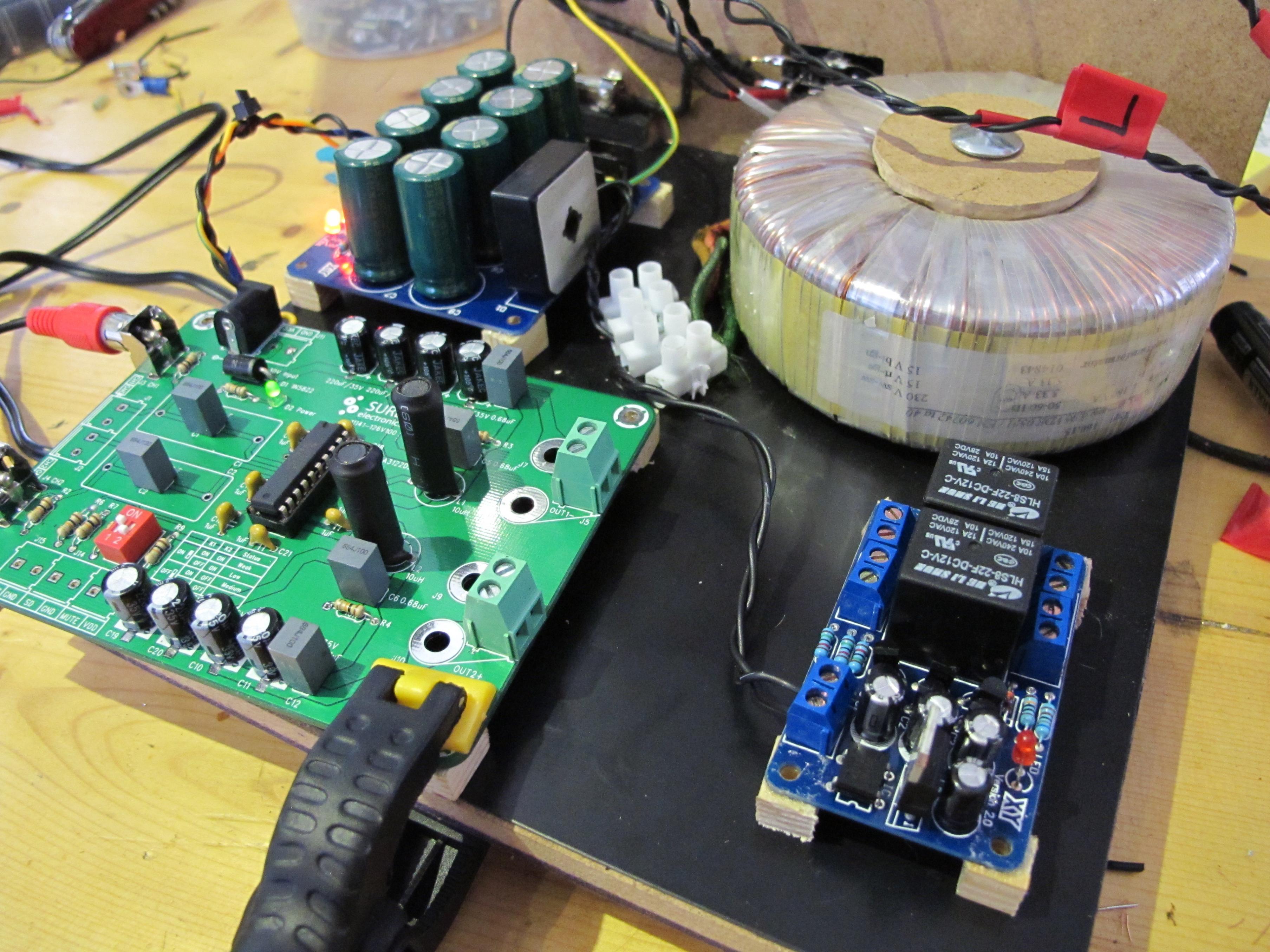

So.. After you said it could be normal. I connected the Amp-board with the 6,8V Powersupply with one channel to a worn out pair of speakers. The Amp is still okay, music comes out clear and nicely
. While the speaker is connectect (no music runnig) i cannot measure any voltage at the outputs but the second channel without connected speaker shows dc voltage from about 3,4V DC so i think its really normal. I connected the amp board with the linear PS again (now something around 5V DC at the speaker output) and just get no sound but this ticking noise out of the speakers.
The picture shows the case with PSU, Amp, DC-Protection (actually not connected) (Sorry for the bad quality of work.. thats my first electronic project. I`m more a fan of speakers building and woodworking

Hey xrk, i think you misunderstood me. I'm using the 6,8v just for testing the amp board because, it always worked with this Power supply. The psu on the picture produces 22v Dc and this is the one i want to use for this amp. But it seems I'm connecting it wrong or it has a Problem... But i Do Not see any mistakes by connecting - with - and + with +..
I will upload a picture with the circuit Diagramm and a picture of my connection between those boards. Maybe i'm just blind and missed an obvious mistake.. Thanks for you help!
You need to make sure the power supply you have is not a dual rail +22v and -22v supply as that would be 44 volts and blow your amp. If it is +11 and -11 then that won't work if the ground on the power supply and amp are referenced to same common ground. I only say this because I see a nice toroidal transformer (markings show dual 15v output coils) and full wave bridge rectifier with lots of caps. Usually a sign of a dual rail power supply. Perhaps you are only using half of the supply? The TPA amps are single rail power supply only.
