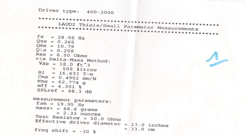

In a moment of madness i bought a S/H pair of Supravox 400-2000's -- now i have got to decide how best to use them.
I purchased them because they have a low Rms which is meant to be an indicator of LF detail at low listening levels - which is a trait i am after.
I have had a mono set up with the driver in a sealed 160 ltr test cabinet, which with minimal LF equalisation is pretty flat from 50 hz up to 1200hz, where it has a wobble. ( I am only going up to 500hz max)

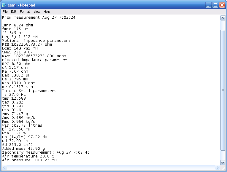

T/S measurements attached - manufacturers and mine, looks as if things loosen up abit with use.
Wisdom would say not to use this low qts driver in a sealed cab, however with the DSP i can get a pretty reasonable response out of the sealed arrangement.
I was going to experiment with a couple of different cabinet styles before deciding on what to build a pair of.
I suppose i should try a vented cabinet and or a MLTL, but am not sure if the LF boost is worth the sacrifice of smooth phase and group delay.
Any experience of these drivers, in smallish cabinets (200 ltrs max)? and recommendations for the cabinet arrangements?
(I know an Jensen/Onken arrangement is recommended by the manufacturer - my previous experience of Onkens is the bass is not dry enough for me - so its not in the running)

Supravox makes excellent drivers and these are similar to the Altec 515b's in that they have an excellent mid range / mid bass. I would put these drivers in a big sealed enclosure that is rigid and well braced ( 150 - 200 liters ) in your case. Do not make the mistake of EQing the bottom end too much as these are not sub woofers. I would use them from 45 -50hz. with sub woofers below ( if in your plans ) and up to 500hz as you mentioned. The rest depends upon your mid range driver selection. A nice horn mid range would be a good match after pad it down several db or bi amp.

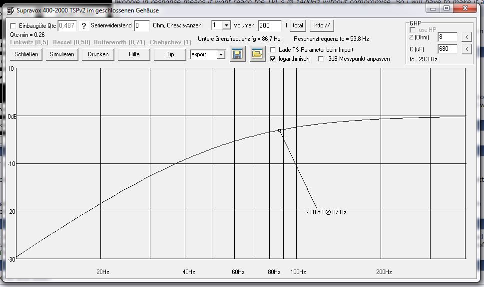

The Qts is way too low for a sealed enclosure, the f3 is at 87Hz in 200l and they don't have a high excursion.

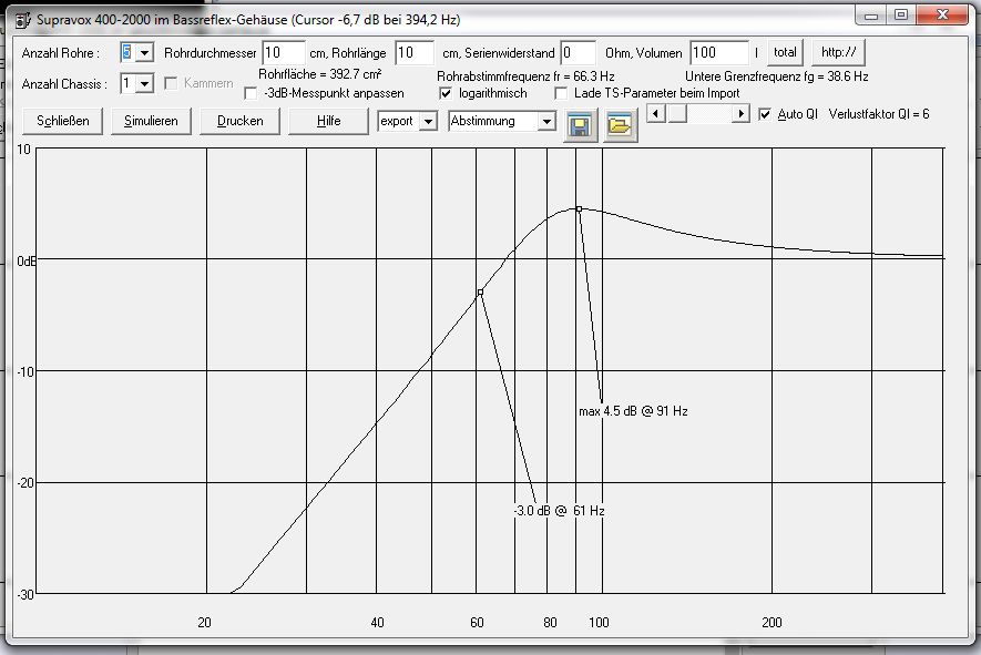

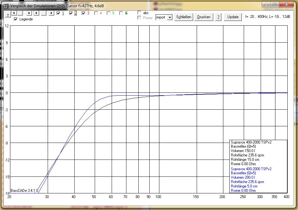

They work fine in a BR enclosure, 150l, tuned to 41Hz, f3 53Hz, at 40Hz -7dB or 200l, tuned to ~44Hz, f3 at 47Hz. A backloaded horn would work too (probably even better) but will most likely much larger than 200l.

Well, you've got the TSP, simulate it yourself. If you go smaller, it costs you a lot of the deep end.
I dont consider 10mm as limited xmax, in our smaller european rooms that still will be very loud.
The 10mm are peak to peak and generousely calculated, if you check the winding height you will quickly notice of the +/-5mm are only +/-3mm left over - at least if you calculate it yourself honestly.

With a such low Qts a TL is out of the question. Furthermore, it will give you more impedance peaks, not less - unless you are dampening it to death (in which case you can build a closed box anyway).
If you tune the BR to the same frequency as the fb (resonance of the chassis in the box), you'll get an extremely boomy, washed out sound, especally if you go for a smaller enclosure. That looks like this:
Not really something you'd want to listen to, I suppose. So using a BR system to minimize the impedance fluctuation isn't an option. Besides that, any Helmholtz resonator or other ventilation system introduces a 2nd (or more) impedance peak(s).
But please let me ask, why do you want to minimise the impedance peak? It doesn't 'harm' you in any way, even a tube amplifier can cope with that peak.

The driver resonance rises with the enclosure. The case I simulated above the fb is in 100l infact actually 66Hz, even if the free air fs is below 30Hz.

How do you arrive at this? I put the parameters in AJ Horn and have a response down to around 50Hz (-3dB). When you factor in a bit of resistance it goes even lower in 180L. Also around 110dB should be plenty loud in an average room.The Qts is way too low for a sealed enclosure, the f3 is at 87Hz in 200l and they don't have a high excursion.

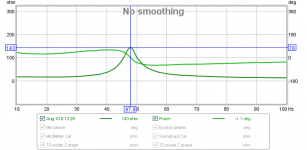

In my test cabinet the impedance peak is around 44 hz, and 27hz in free air.

I probably used different TSP than you did, I took them from the 2nd picture. I don't know what enviroment (halfspace? quarterspace?) you've simulated either. This is the simulation (though without serial resistance):
I don't know how you are comming to 110dB spl, according to WinISD the maximum linear excursion (3mm) is reached at 50Hz at 96dB. That's loud but nowhere near something you'd expect from a 15" driver.

First trace is the impedance installed in the cabinet, resonance ~ 47hz. Cabinet is lightly stuffed, with heavy stuffing i can halve that peak, but a heavily stuffed cabinet takes all the life out of the driver.

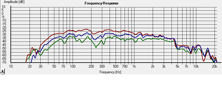

Second trace is a frequency sweep - 10cm off the driver cone, 30cm and 60 cm. As you can see i have a " floor interaction" occuring around 200Hz which get worse, as expected as you move the mic back. Interestingly the HF smooths up as i go further back, maybe i could do a 2 way (doubt at 1600 hz - 15" beaming will be tolerable)
