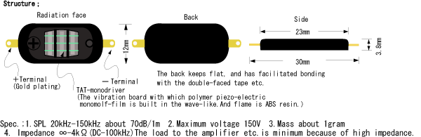

Bought a pair of Taket supertweeters (STs) that have a frequency response of 20kHz to 100kHz to supplement the high frequency output of the Martin Logan CLXs which go to 23kHz.
However the STs have a Sensitivity of 70dB vs the 90dB of the CLX.
To integrate the STs, it was recommended that I use an integrated amp between my preamp and the STs in order to set a base level which would then track the CLX volume as set by the preamp.
Other than finding an integrated amp with a frequency response on the order of 100kHz, is there a way to estimate what amp power I would need to adequately compensate for the 20dB lower Sensitivity of the STs?

FWIW though I think its utterly pointless said tweeter is > 4Kohm impedance.
At 150V peak to peak max that equates to a rather pathetic < 3W.
If I was going for it, a bespoke OTL valve amplifier would be
my choice, but I'm sure it could be done with transistors.
Thing is, if your main amplifiers can swing say +/- 40V,
then there is no hope of realistically making up 20dB,
6dB higher hits +/- 80V, and it gets worse the
higher the power output of your main amplifiers.
rgds, sreten.

You can confirm they make some noise below 20KHz, but cannot
convince me at "about" 70dB they do anything actually useful.
An amplifier of sufficient voltage swing to make up 20dB of gain
will simply fry them due to overvoltage, it just won't sensibly fly.
A step transformer is a good idea, however it will fry them.
rgds, sreten.
