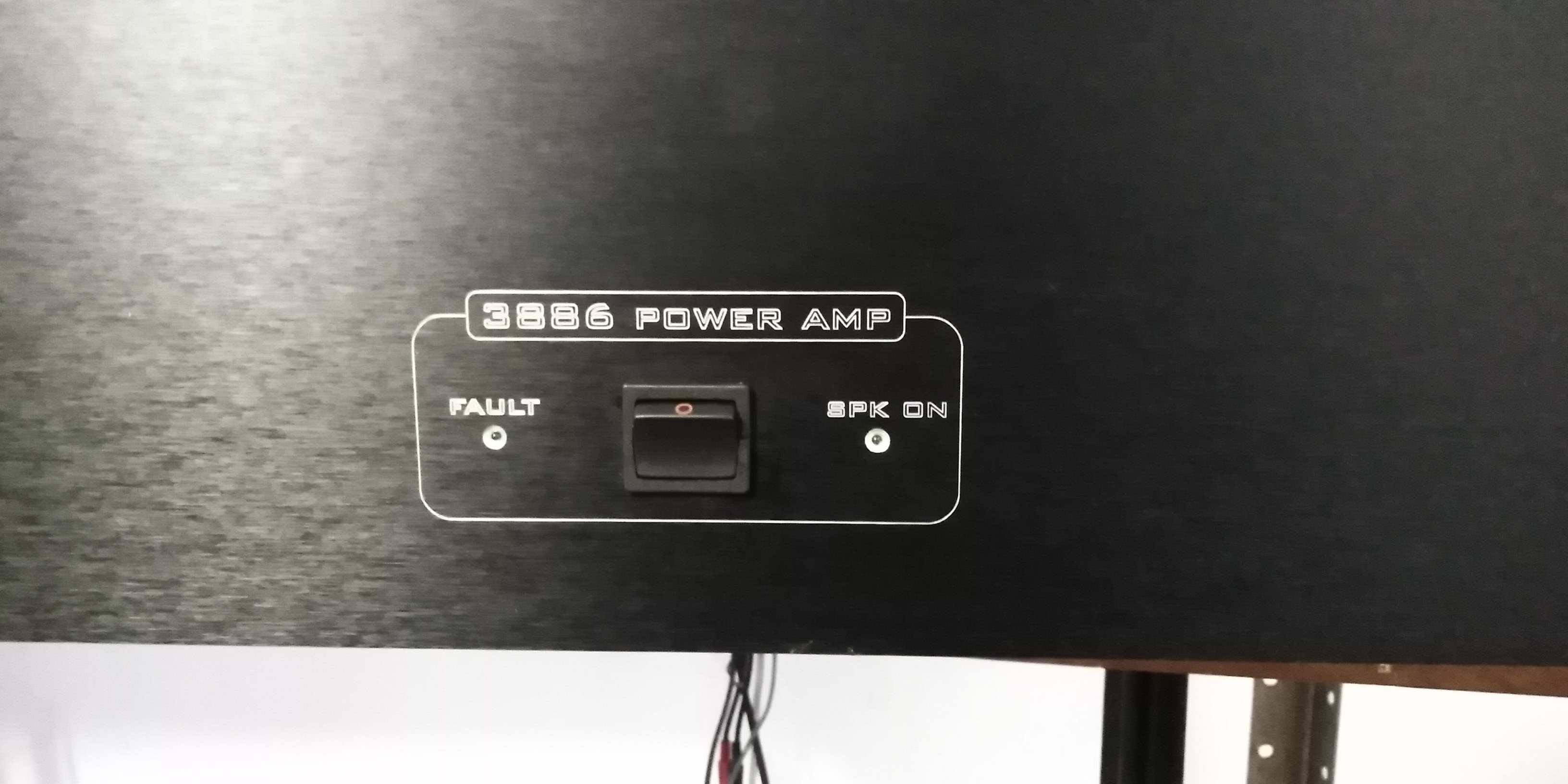

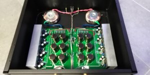

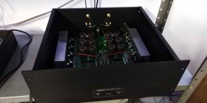

I found this scheme on the net and tried to carry out the project with 4 LM3886 chips, the result obtained is very pleasant, the pcb groups the two amplifier stages and two psu. The sound is very different from that obtained from the single Lm3386, with this stage you can see better driving at low frequencies and excellent transparency on medium-high frequencies.
pcb also accept an antibum-protection.
if interest pcb is available in 3pz...with BOM

I´m sure his amp will work fine, but it may be an advantage to make the PCB a little more compact. Then, have some additional film cap´s near each chips legs. Should be better than only electrolitic´s.

each lm3886 already has its capacitors near the power supply pins, you can see it from the photo. I think putting this bridge amplifier is a purely experimental thing seen and considered that in real life at home we will never have 2 ohm speakers. There is only one pcb available for construction, whoever wants to use it can communicate it to me via private message. thank you all . P.S. the amp sounds really good!😉
thanksYes i agree.....Nice work! Great Layout.
What is the size of your Heatsinks ?
heatsink : 250x80x50
