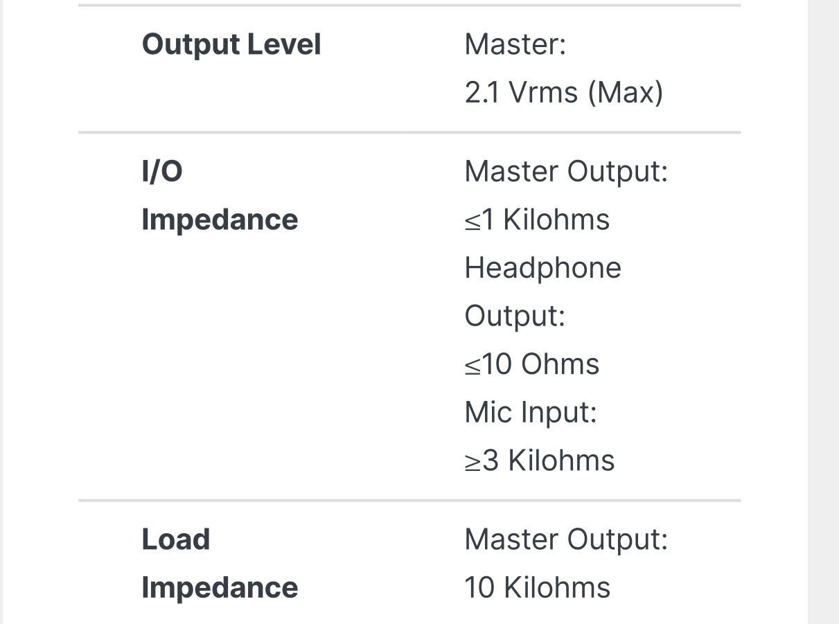

I found bellow on the specs for the decks that I would be using to connect to the amp. If I build the cable for these specs would I be able to use the same one with an adapter to plug it into my laptop?In case you dont know what is the minimal loadimpedance of your source is, i would suggest at least 2x1k
Looks like your source would be happy with a 10k load, so anything 100ohm, even 1k is a no no. Do you have info about the input of the amp you want to feed?

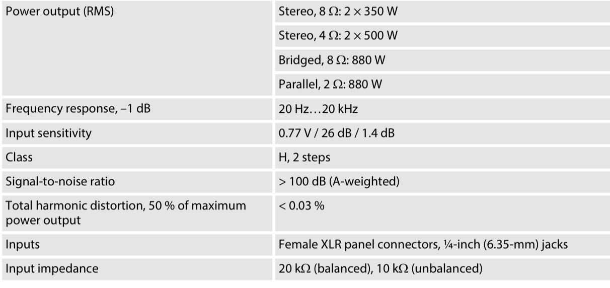

Sure do!Do you have info about the input of the amp you want to feed?
I would be using unbalanced inputs so it’s also 10kohm.
In your situation i would use two 4.7k resistors. Not exactly ideal, but should work as a good compromise

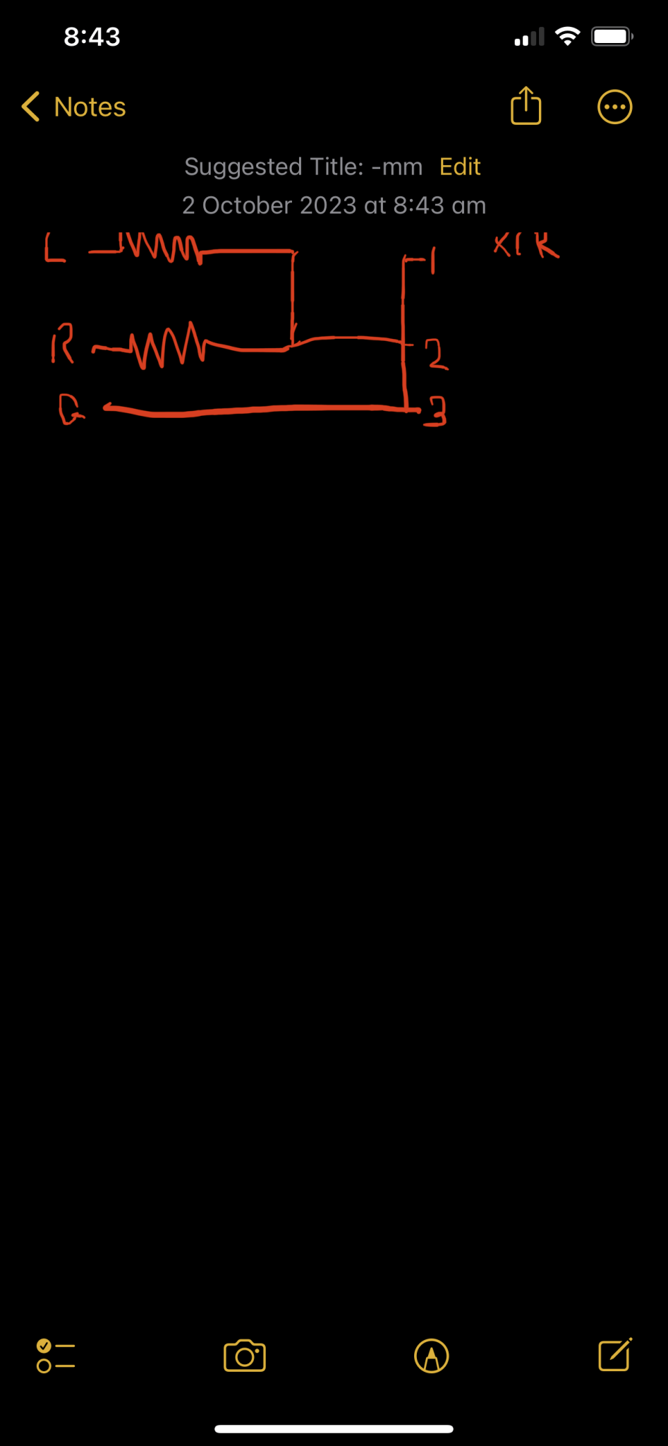

My amp does have a switch like this that allows me to swap between stereo, parallel and bridged mono. Based off your first paragraph I came up with the design below where both the resistors would be the 4.7kohm ones suggested. Would I need to tweak this design in any way as my amp has the switch mentioned on it?In case the amp has a switch to paralell the inputs internally (2 ohm,880W) you would not need to join the resistors externally, you could just connect L to L and R to R with serial resistors that are then joined by the switch as paralelled mono amp or as usual 2 channel stereo amp with practically unnoticable degradation in performance. Important is, that the resistors are located close to the inputs of the amp.

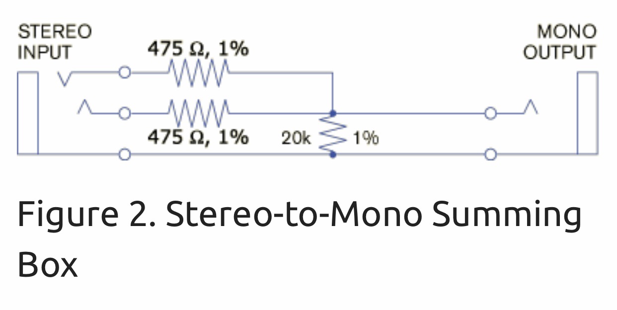

The old Rane Note to the rescue:

Works for summing L+R into a mono. Btw, do NOT get temped to use much lower resistor values than 4.7k, lower values need a source that can handle it !!!My amp does have a switch like this that allows me to swap between stereo, parallel and bridged mono. Based off your first paragraph I came up with the design below where both the resistors would be the 4.7kohm ones suggested. Would I need to tweak this design in any way as my amp has the switch mentioned on it?
I’ve seen on the diagram like with a few others that there is a resistor of 20k value that seems to have very little explanation as to it’s purposeThe old Rane Note to the rescue:

Duely noted I will be keeping the values for the resistors around this level to keep my kit from breaking! And just making sure I want them summed on the positive terminal for the xlr for mono? Also I’m planning on making a similar cable to connect my laptop to the same amp. I’ve seen that the average output impedance for laptops is around 20ohms so would this require lower ohm resistors of around 10ohms? Because videos I’ve seen of people making similar cables said not to use resistors below 100ohmsWorks for summing L+R into a mono. Btw, do NOT get temped to use much lower resistor values than 4.7k, lower values need a source that can handle it !!!

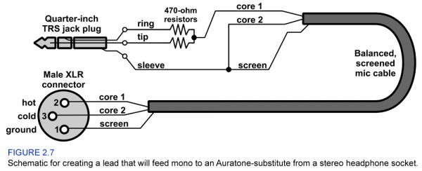

The diagram below shows the wiring at the XLR end. Perhaps it may help?
Yeah that’s helpful if I was looking to do it on the xlr end what would I link 3 and 1 with?The diagram below shows the wiring at the XLR end. Perhaps it may help?
