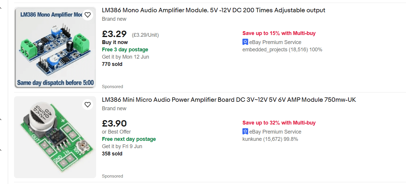

Write down your own specification for what you want.but do i really need that 50w of power and need to deal with the cooling for that chip
What do you intend to drive with this amp?
A small chip like an LM386 will give the kind of output a small portable radio or TV would give. It can operate from a single rail battery supply if you wish or a single rail AC supply which makes it easy to use.
