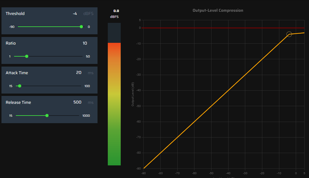

I'm playing around with the compressor in MiniDSP Flex to avoid my subwoofer power amps clipping and/or go into voltage- and current-protection. They do clip very hard, and when a protection event occur they tend to produce a very loud "click" sound from the speakers. The MiniDSP also clips quite hard.
My power amps clip at 3.46V input, while the max output of the MiniDSP is 4V, a relative difference of 1,26 dB
The subwoofers are crossed over at 80 Hz.
My current compressor setting is like this:
Any thoughts/suggestions.... ? Do the attack and release times make any sense?

The question is whether my compression attack and release settings makes sense for subwoofer use in the frequency range below 80 Hz.
My subwoofers don't need voltage limiting, as I'm not overloading them. What needs to be done is to avoid protection and hard clipping in the ICEpower amp and MiniDSP output, as I also said in my original post.

20ms is a bit long for the attack setting imho.
Something in the 10/ 13ms range is usually ok with bass ( my starting point, at 80hz a sinus cycle is circa 12ms).
For the release try 100ms.
Do you know at which value of dbfs the dsp start to clip? If so then use this as a basis for your threshold. From there lower it until the amp never goes into protection. You might need to use a steeper ratio, 20 or more to really have a limiter, 10/1 is at the border between compressing and limiting.

These are my current settings, adjusted by ear. It's like you say half-way between compression and limiting. I found it better to lower the threshold a little than using a greater ratio.

Yes limiting can be audible ( greater ratio). Lowering treshold will have sort of same effect anyway, all in all what matter is the outcome and if you find a more gradual effect is more pleasing: so be it.
The issue i see is you have 2 clipping points ( dsp and amp). You'll have to identify the lowest one and focus on it.
Do you enter the dsp analog or digital?
About release time: it'll depend of how often you expect clipping to occur. For limiters usually i look for fast attacks and release as the purpose is to 'grab' peaks if/when they happen. That said it can sound a bit oppressing if you need it to work often ( you are a bit too loud in rms).

The points are, related to 0 dBFS (4V RMS) on the output of the DSP :
DSP output clipping : 0 dB (of course)
ICEpower 2000AS2 clipping : -1,25 dB (max output voltage ~105V)
ICEpower 2000AS2 protection : -4,06 dB (2x700W @ 6 ohms)
I set my threshold at -6 dB, which is 2 dB below the protection point of the amp. I cant really hear the compression, other than that the amp no longer is complaining. When it enters protection, a very loud "click" is heard.

One thing though: don't rely blindlessly on 0dbfs being ceiling for dsp out, it can happen some tenth of db below the theorical value. Usually it is dac related but it can happen in digital domain too ( it depend of the gain structure of the device and treatments used).
When/if you have choice of a 'ceiling ' digital value for ouput choose something like -0.1 or -0.2 dbfs it usually protect from dac nastys.
If issue still arise then check if there is no 'over' into the processor ( digital gain structure: usually seen as squared peaks on outputs) and if so lower the first digital gain stage (or dsp input) until it disappear.
