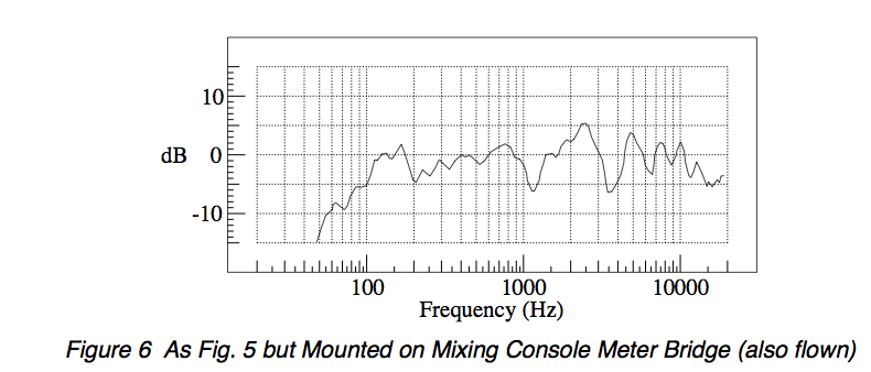

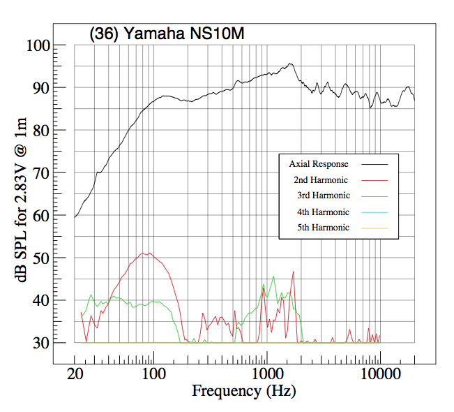

Noise induced hearing loss deaf engineer issues aside, the ubiquitous Yamaha NS10 has a response peak around 1600 Hz free field, but often they were (are) placed on the meter bridge of large consoles, which changes their response considerably.
Console meter bridge height and depth, and mix engineers height from the console all vary, each of those elements vary the frequency response heard in the studio, so "across the board" comments won't be valid for all those mixing on the NS10.
That said, the tendency when using a speaker that is not flat is to mix the inverse of it's response, if the response was like in figure 6, one would tend to cut back frequencies around 2500 Hz and boost around 3500 Hz.
When played back on a flat response speaker, the mix may sound too bright, as hearing is most sensitive in the 3-4KHz range.
If the NS10 was used without referencing headphones and/or monitors with flat low frequency response, the tendency would be to boost frequencies below 100 Hz in the mix.
Having a separate individual responsible for mastering could correct those types of problems, but reduced budgets now often mean the final mix, however it sounds, is what is released.
