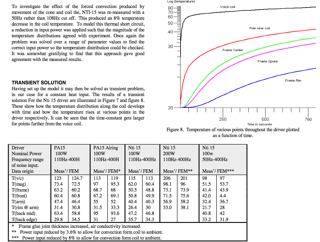

This has useful information:
http://www.cedrat.com/fileadmin/use...02/05/loudspeaker_motor_thermal_behaviour.pdf
Seems from their tests the magnet structure temperature ranges from about 86% to half the voice coil temperature, so a boiling temperature should be OK if the adhesives can withstand 450 F.

Interesting to note that, in the Nti 15 test from the cedrat PDF the MAG temp is about half the VC temp 🙂 The PA 15 is not as good !
The 100 watt Nti 15 test shows the magnet at 53% of the voice coil temp, the PA 15 at 59.3%, the PA 15 voice coil temp 6.5% higher.Interesting to note that, in the Nti 15 test from the cedrat PDF the MAG temp is about half the VC temp 🙂 The PA 15 is not as good !
Also interesting that dropping the frequency range by about an octave resulted in 8% less heat due to more air movement.
