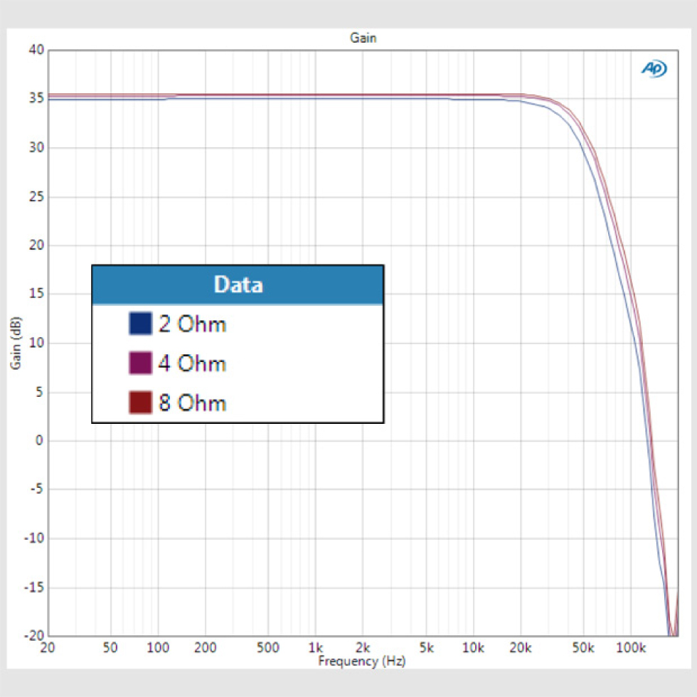

Class D uses an output LC filter (inductor/capacitor) to tame EMI (electro magnetic interference), the circuit needs to be "tuned" to the nominal impedance driven, or VHF (very high frequencies above 10kHz) response will slightly rise above "flat" response with higher impedance, or droop with lower impedance.
Behringer's "Impedance Compensation - SmartSense" probably mitigates the LC filter problem, but that won't have any bearing on the impedance the amplifier can handle without current limiting. The NX3000D example you mentioned has exactly the same rated output at different impedance loads as the NU3000 (without "Impedance Compensation - SmartSense") it replaced.
