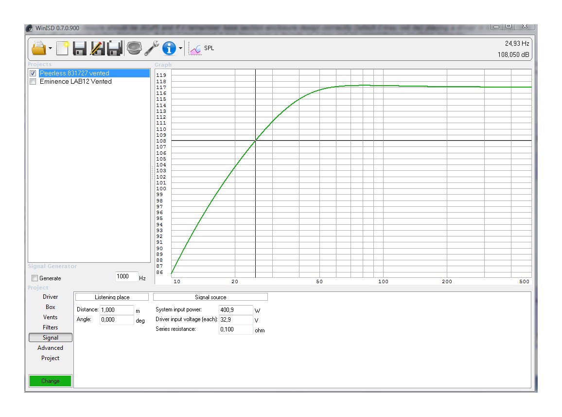

Hi ctmorsejr
I dont think there is anything wrong with your drivers. If you press them lightly in and out with the hand and not scratching sound are heard then almost certainly no problem.
I think you are just putting in way too much power into them and expect them to go much deeper than they are designed to do.
HT needs much more deep bass to de really satisfying
..... If you use all the power from your good Aragon 2x200W amp then you have quite surely exceded the Xmax of the drivers (which can of course also damage them).
See the first sim. As you have tuned to 25 Hz I don't think it will make any difference to add a subsonic filter ... not even for HT are there much sound under 25Hz and your port are taking the most load in this region. Problem is more around 40 Hz.
If you like your sub for music (though I would have chosen something going somewhat lower than the 36Hz f3 point here ... but if it works for you), then simply add a sub more, and also put it somewhere else in the room to get better room response ... experiment here for best result.
Use one chanel of the Aragon for the two Peerless wofers in parallel, and add another sub driven by the other. Here you need something a bit older school to get the max out .... e.g. UM10 is quite hungry for watt ... something like a Lab12 in 80l vented at 23Hz. You might need a potentiometer on the input for the peerless chanel to match the output.

Hi ctmorsejr
By the way
IMHO a 10 inch is no slower than a 12 inch or 18 inch for that matter. There is alignment and room modes ... and this can cause boomy or slow lingering bass ....
