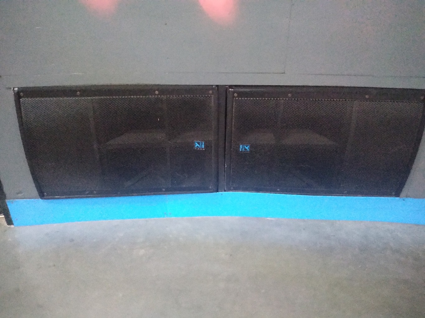

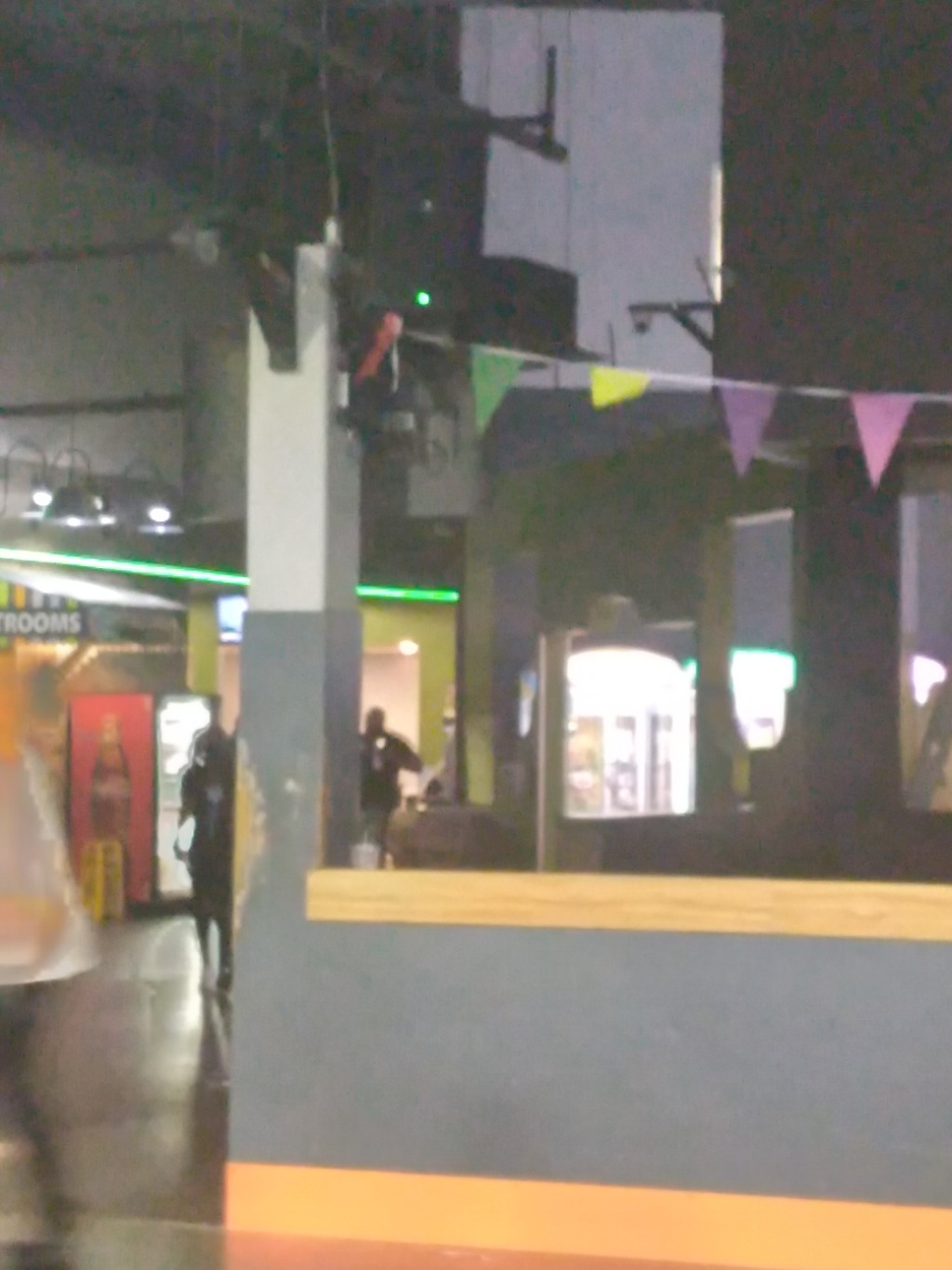

I run sound at a local skating rink that has a 10,000 square foot oval skating floor that is coated concrete. Has walls on three sides with one long side open to the rest of the building.
We currently have four Yorkville 18" subs (two at one end of the rink two at the other end of the rink) which never sounded good.

We have four of the Yorkville LS1208.
They are arranged in pairs of two one pair on the back wall (long side of skate floor) at one end of the rink and one pair on the other end of the rink on the same wall.
I've got them sounding the best they possibly can using EQ, but they still don't sound good.

The way we're doing it we will only replace two speakers on the back long wall. There's 5 posts evenly spaced along each long side of the rink and we currently have three Mackie 212 speakers along one wall spaced one post apart and we'll put two along the other long side of the rink spaced one post apart.
It will be like this. __ is an empty post. O is a speaker on a post.
__ O __ O __
O __ O __ O
That way no speaker is directly across from another speaker.

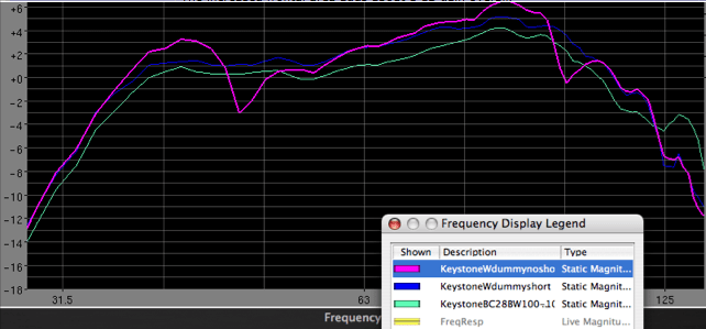

The rattling could be from a loose speaker or grill, ripped cone, cabinet parts or drywall- any of which can go on for years.Also one of the four is disconnected as it has a rattle in it at louder volume levels and it's not the driver given the rattle has been there several years.
If the disconnected LS1208 "basspipe" cabinet does not have it's input shorted it will function as a resonator, sucking level down and peaking at some frequencies- could be 59Hz.
As an example, the shorted Keystone tapped horn cabinet (blue trace) increases level by 1dB over a single driven cabinet(green), while the unshorted "drone" cabinet next to it creates +/-2dB peaks and dips.
EQ for that pair will be wrong for other pair, like you said: "the bass they do produce with a 31 band EQ doesn't sound all that good".
Plugging the cabinet in and turning the amp down would short the input, improving response, but finding and fixing the cause of the rattle should be done before judging the LS1208 as the problem.
Sine wave frequency sweeps, a microphone on a tall boom stand and headphones make it more easy to find the source of rattles without climbing around..
The LS1208 should sound better than JBL 4520 scoops (-8dB at 40Hz..) if positioned the same in the same room- like Conanski wrote: "Low bass response inside a building is ALL about positioning."
