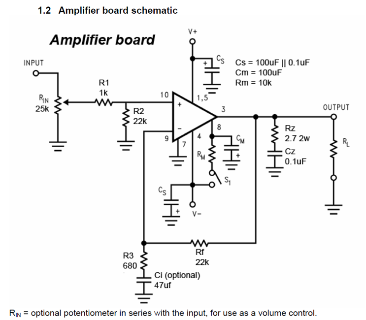

I'm trying to finish up a project with the Chipamp.com dual mono LM3886 boards. Schematic below.
I've decided, based on advice from a knowledgeable friend who was helping me, to subsitute resistors R2, and Rf with 20k resistors.
I'm also changing R3 to 1k. My friend and I are following Linkwitz' writings.
Unfortunately, my friend is no longer able to advise me, due to illness. That's why I keep coming back here.
My question is: In his notes, my friend suggests substituting the current Rm (10k) with a 38.3k resistor. This is also what Linkwitz uses.
If I make the above changes, is it necesary to change Rm, or should I just leave it as is?
Please, keep it simple. Remember, almost no electronics knowledge here.

Someone in another thread changed Rm and had trouble with crossover distortion.
I would stick to datasheet component values.
22k to 20k shouldn't make much difference though.
In your project make sure path for Rf is as close to LM3886 as possible or you could get oscillation. Same goes for decoupling.

Hi Nigel:
Thanks for that. For Rf, I am just substituting the 20k where the stock resistor was already on the PCB. Since I haven't seen many complaints about sound quality from people who built these kits, I'll assume it should be okay.
And the change in R3 from 680R to 1k? That shouldn't create too much of a problem either?

makes it sound like Rm is only used to disable mute functionality. What is Rm used for?

The ratio Rf to R3 determines the gain. Gain is Rf/R3+1. If you change any so that the ratio changes, you change the gain. Do you want to change the gain? Why do you want to change R3?

Thanks, but I think I'm okay with the gain resistors. I'm changing R3 because I'm changing the gain resistors. Otherwise, I'd likely have DC imbalance problems.
My real question now is what do for a resistor to prevent motorboating. As I said, Linkwitz recommends a 2 ohm resistor at the ouptut, but doesn't specify power rating or tolerance. Can anyone comment on this?
Tolerance is unimportant, even 10% is fine.
If all is fine there is very little power dissipated, only when it starts oscillating it gets hot, but that is normally not the case. A 1W should be fine here, that's what I always use.
BTW it is not against motorboating, it is against high frequency instability. It terminates the amp for high frequencies where the output cabling would inductively separate the load from the amp. The R (with the C in series) makes sure the amp is always terminated.
BTW R3 IS a gain resistor. As I said, changing R3 changes the gain, which depends on the ratio of R3 and Rf. So changing R3 changes the gain, unless you also change Rf in proportion. I understand your concern for equal input impedances for bias current balance, but since it varies with the input potmeter setting there's no single resistor value that balances it, unless you use a coupling cap on the signal input.
If you use a coupling cap after the pot wiper, both inputs see 22k for the bias currents and it will be balanced.

BTW on Rm: TI recommends (see data sheet) to draw a minimum of 0.5mA from the mute pin. The mute pin will sit at -2.6V.
So the max Rm value would be: (-supply - 2.6) / 0.5 .
Example: -supply = 35V, then Rm nominal = 32.4/0.5 = 64.8k. So anything smaller than this would be fine. 10k is fine but so is 22k or 38.3k etc. Except that 38.3k is an uncommon value and needlessly expensive.

1) just follow the datasheet recommendations until you have a better reason not to do so.
Which so far you don´t.
2) that amplifier has a minimum gain rating under which it must not go, just check the datasheet suggestions.
22k/680 ohms is fine and guaranteed stable, 20k/1k is not.
Meaning some amps would work with no trouble, others maybe not.
Why would you attract gremlins to your project for no good reason?

Linkwitz wrote in his notes for the LM3886 circuit:
quote:
"R0 - to isolate signal from power ground in case of hum or motorboating due to poor wiring layout etc."
As for an input "potmeter". I don't know that means, but I'm assuming potentiometer? I won't be including one on these amps, so IIUC, that won't apply here.

Why would I attract gremlins? Like I said earlier in the post, I'm going with Linkwitz's recommendations where possible. With all respect, I think Linkwitz knows more than most of the people in this forum combined.
I forgot the exact number, cause my notes are downstairs, but the gain will still be about 26, which is well within spec.
I was also advised to follow Linkwitz recommendations by someone who knows a fair bit about building amps, but can no longer help due to illness. Maybe you didn't read the earlier posts?
Okay, will go with 2R, 1W 5 or 10% resistors, then.

It've also been advised to use a low pass filter in the form of a cap of value 1500pF to 3300 pF . What do you folks recommend? Will difference values in these ranges make much of an audible difference?
Thanks.
I use none polarised capacitors on the input as I don't know what preceding device will output. Polyester is good.
220pf is a good for low pass. Depends on input resistor.
But with 22k input resistor put the 220pf in parallel with it.
Well you said 20k and 1k, that is NOT 26 gain.
I know personally Linkwitz and he is a very experienced designer, but you need similar knowledge to understand what he says. Is that the case?
For instance, the ground isolation resistor (which you call motorboating) is important in Linkwitz' system as he has 8 or even 16 amps all on the same power supplies and grounding. Are you using more than 2 for stereo?
Jan
