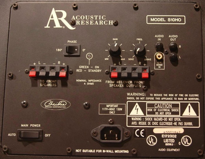

Hi Johncee. Normally, you would run the main speaker full range or cut off the lower frequencies with a crossover or a high pass filter. A device that only lets frequencies above about 100 hz get through the mains. That gets any muddy low sounds that can potentially damage your speakers from getting through. The subwoofer on the other hand needs a low pass filter (crossover) to allow only the low sounds to get through. You will need an amp that has a crossover built in to it or a separate crossover to at least 2 amp channels. One for lows, one for highs. Unless you're running stereo, then you need to double everything. Hope this helps.

AR (Acoustic Research) S10HO
It is equipped with an input terminal of the two types of low-level and high level.
It is equipped with auto-sensing capability and variable adjustment of the crossover frequency and input level.
Crossover frequency 50Hz ~ 200Hz (continuously variable)
