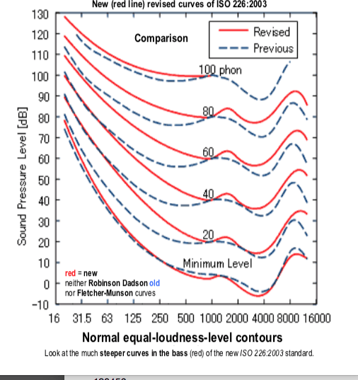

At low sound pressure levels, the fundamental low frequencies don't sound as loud to your ear as their upper harmonics, the reason for a "loudness contour" switch.
"Bass heavy" music generally has more of a low note's fundamental relative to the upper harmonics than acoustic, and when you listen at louder levels, your hearing (should) tend to "flatten out", as can be seen in the equal loudness contour graph.
Also note that around 1000Hz a 10dB reduction in level sounds half as loud, while at around 41Hz (the low E on an upright bass) dropping by only 5 dB sounds half as loud.
You may want to increase the sub's volume at low levels compared to higher level, a variable "loudness contour".
